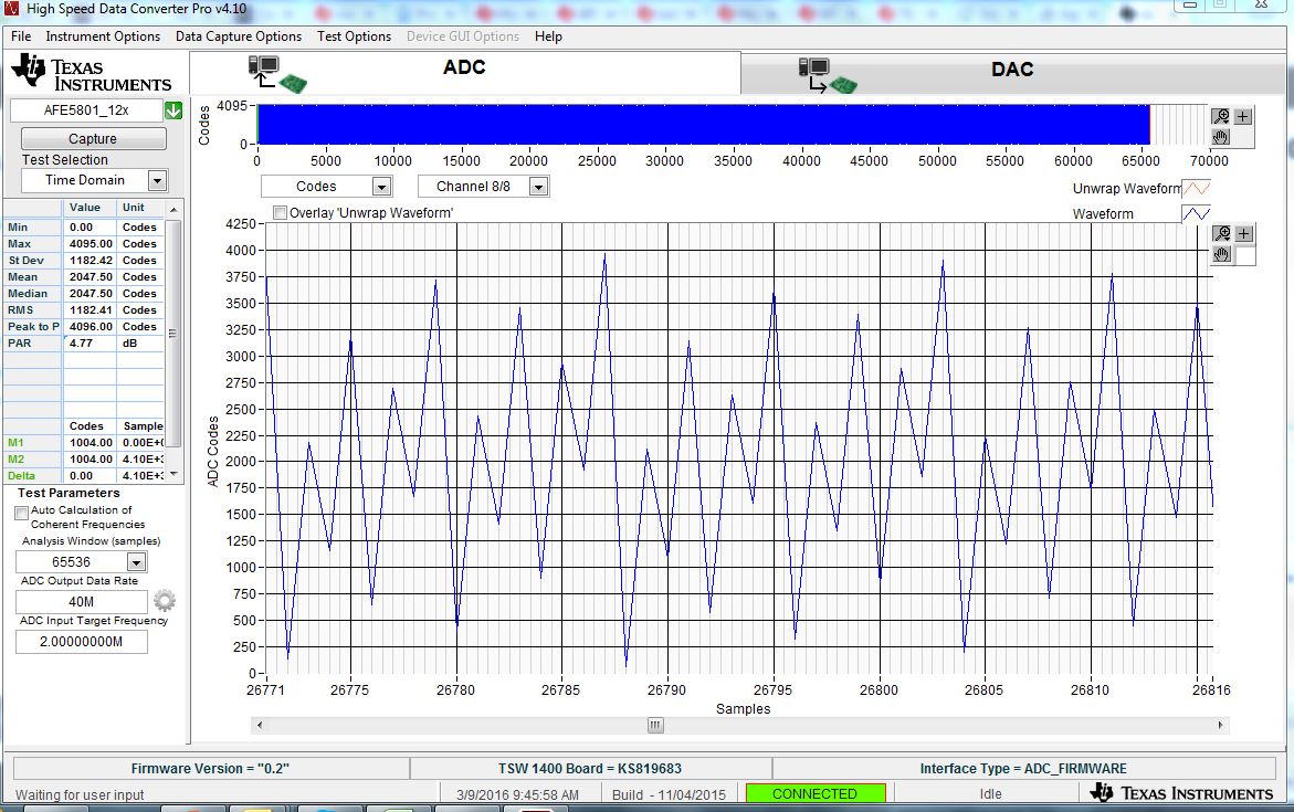

    I enabled the ramp pattern. It looks like a 'noisy ramp' at best. I have attached a screenshot of ramp pattern for your review. Same noisy behavior with external sine wave input. The FFT sometimes shows a tiny spur at 2M (input frequency), but the noise floor is too high to be definitive. Toggle pattern seems fine.

    Thanks for the debug, this fixes the ramp issue !! Also, I see better waveforms with sinusoidal inputs. Great!
    Now, I still see some issue with the gain / input swing. let me explain:
    When we input a 1V pk-pk sinusoid, and use a 0dB gain , I expect that the signal uses full range of ADC, so the codes plotted by TSW1400 should look like a sinusoid between 0 and 4098 [or something like that]. But I see a very small movement in code around mid code of 2048. In fact when I set the gain to 30dB, even with a 1V pk-pk input swing, I get just +/- 10 codes amplitude sinusoid in the plot. This should have just saturated the ADC input, but still the signal is too small.
    I am use offset binary format for AF5801.
    Please advise how to utilize the full range of ADC,
    thanks again for the 'LSB first' debug.
    Gaurav

    I verified that I am using the correct number format (hex), I entered the values per your instructions. It makes not difference.
    I also checked all channels, signal appears on the right channel but is very small. For example, the figure below is for a 30dB gain!
    Any other suggestions? Is it likely that this is a faulty part & and I should change it?

  • Hi Gaurav,
    I saw the images in the email. The FFT and time domain signal look normal for a channel with only noise only perhaps a neighboring channel to the active channel. Obviously we can see the hint of a 2MHz signal. Can you please verify that you have scrolled through all of the channels in HSDCPro to make sure it is not showing up on another channel. It seems that the ADC is working and the VCA is working to some extent, but there is no gain. The TSW1400 seems ok. Can you please specifiy your 2MHz input power.
    Chuck
  • Hi Chuck,
    I confirm that I have checked on all other channels, and there is no tone there, just noise floor. Even without any gain, I'd expect a bigger signal, so I am not what is going on.
    The 2MHz signal is 1V peak-to-peak. Also, as I mentioned earlier I've verified the common mode and peak to peak all the way upto pins CH1P & CH1N at the input of the chip - they match your pdf. Something inside the chip is not quite right.
