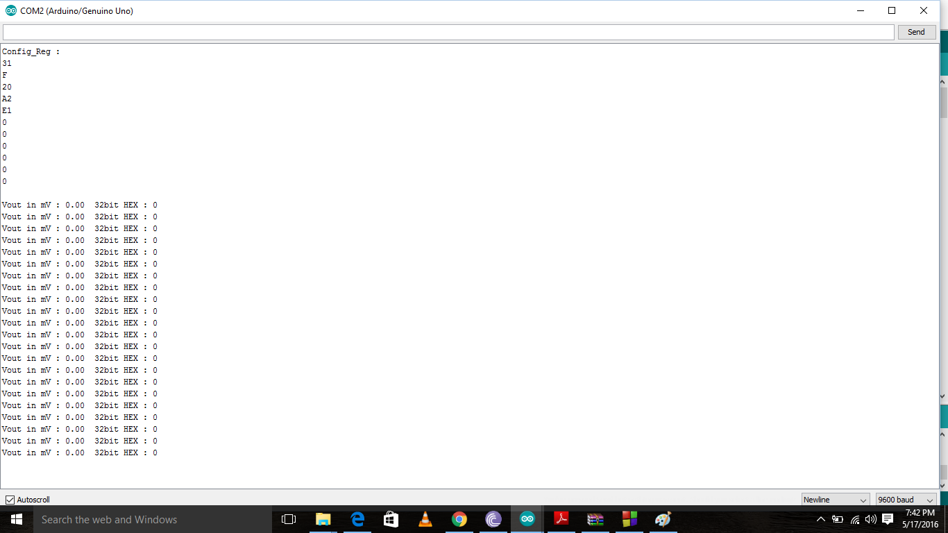

ADS1256 register read and write work properly but i have problem to read the data from ads1256 its show garbage value.
i send my code here.

output on serial is
so garbage value is come......
so i not able to understand where i did mistake......
  • Hi Yatin,
    In your code it looks like you use an IF statement to wait for /DRDY to go low. The problem with this is that your loop will repeat over and over while /DRDY is high (and you repeat the 50 us delay commands). If possible try to use an interrupt, otherwise you could try using a WHILE loop with the condition that the WHILE loop repeats so long as /DRDY is high.
    Also, you'll want to move the SDATAC, SYNC, WAKEUP, and RDATAC commands outside of your loop. You only want to send these commands once before starting the loop. Currently your are restarting the ADC conversions just before reading the data, and the data is invalid right after a restart.
    Chris
