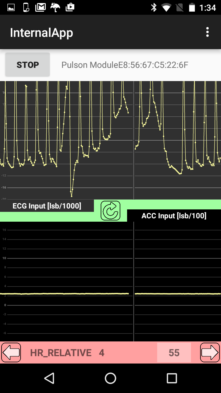

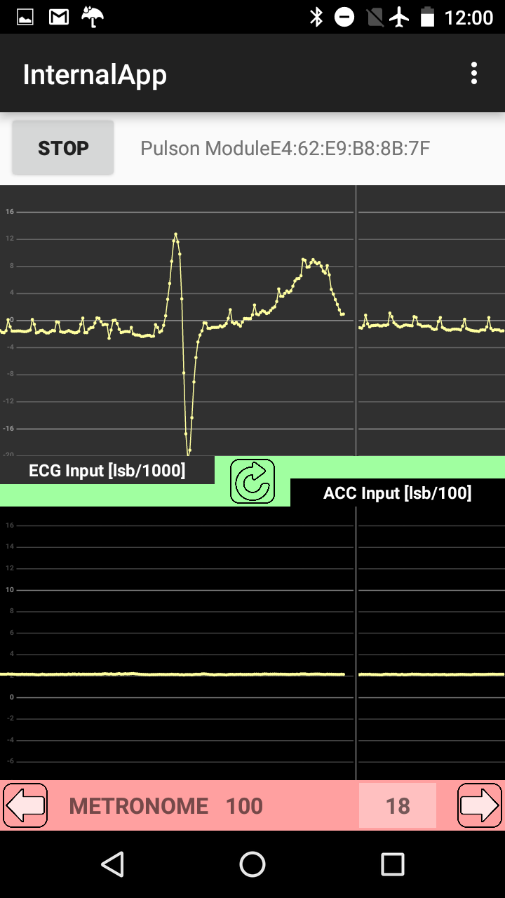

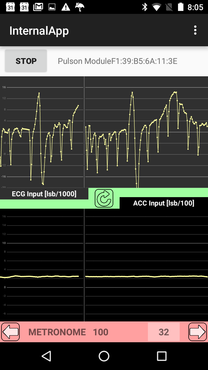

We're using the ADS1291 for ECG capture and we sometimes see noise on the signal.  We're operating on a coin cell, so we have a theory that it's due to low battery, but it's not consistent nor easily repeatable.  Rather than assuming that we're correct, I'd like to know what possible causes there are.  I've attached a schematic as well as images of the noise, as reported by our app via Bluetooth.
Scott
ADS1291 ckt.pdf
  • Hi Scott,
    Can you provide some details on the time scale (X axis)? What register settings are you using with the ADS1291?
  • The app guy is telling me that those plots show 1 second of time.  As for the register settings, I'm still trying to find out those.
