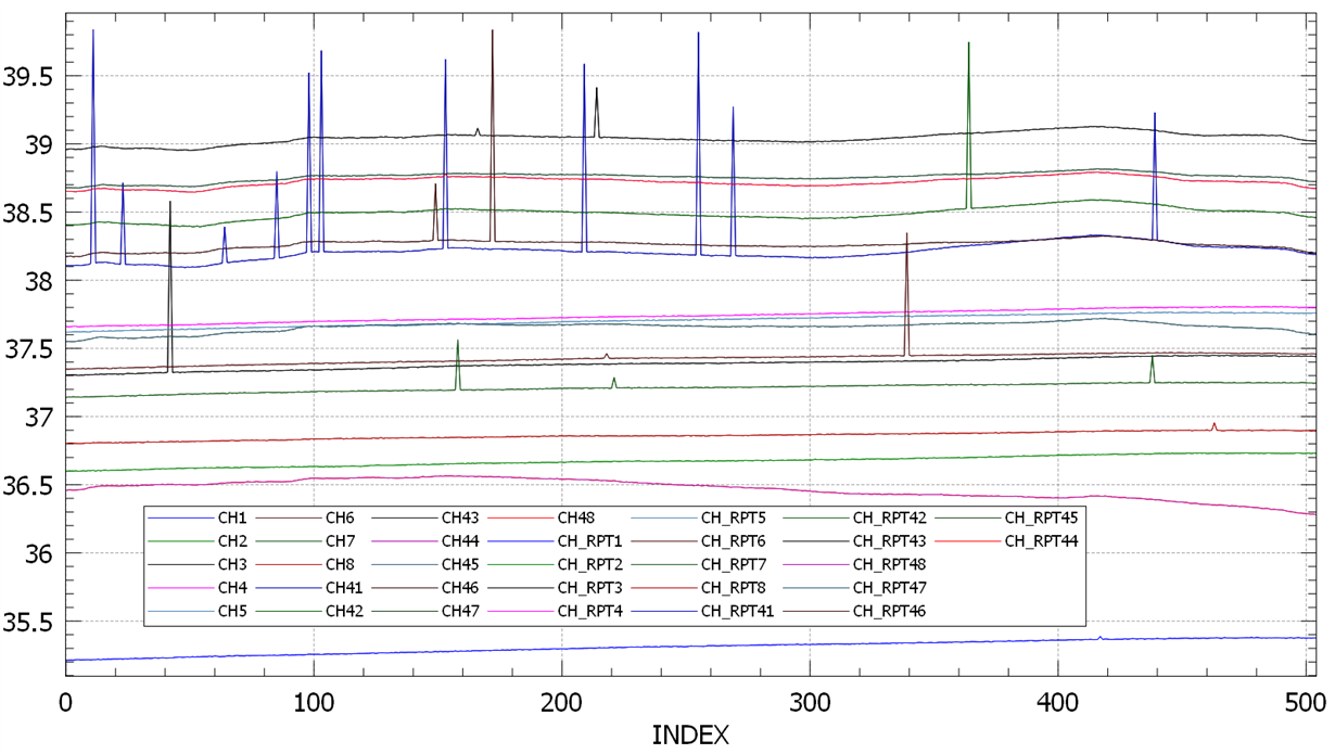

  • Robert,
    Thanks for putting up the data. I've gone through it, looking at the errors, but I'm still not sure what the problem is.
    At first, the data looked like it might be a communication problem, but I'd it's probably not that for a couple of reasons.
    First, you see this issue most on channels 1 and 4. On the other channels, you see it a couple of times, on a little more than half of the channels, you don't see it at all. Generally a communication issue would be randomly spaced through all the channels (unless there were unusual circumstances in the setup and data order. Second, it doesn't line up with common communication problems that I've seen in the past. If it were a delayed read from a /DRDY indication (and an interruption from a new /DRDY), you'd see that in the raw data with the second start of a read within the data word. Another communication error would be noise on the SCLK line, advancing the data read. This would often make the data larger, and here it appears to always make the data smaller (I'd note that you could still test this out by adding some capacitance to SCLK to try to eliminate the noise). In addition to the other comments from yesterday, it's unlikely this is a communications error.
    Looking at the data, the errors from the readout always show the signal as smaller. In this case, it means either the signal really is smaller, or the reference is getting larger during the read.
    Since the errors are different channel to channel, is it possible this error is EMI related? Are the sensors in different physical locations where they may be more susceptible to interference? If so, can they be shielded?
    Are you using some sort of external multiplexer? There are 16 channels of data, and that wouldn't be possible with the device's on-board mux. The added circuitry may make readouts and changing channels more complicated.
    Also, is there some way to do multiple readouts of data for each channel? I would just check to see if you get the same error if you do two reads and throw out the first read. Or you could record multiple readings for each channel to see if the error remains or settles back to normal. (Right now I'm assuming that you read out channels 1 through 16 repeatedly)

    After your suggestion I run two additional tests, where data were read twice.
    A) REPEATED READING
    The ADC channel was configured (Vref changed to RRef) and the very first conversion was read from ADS1248 twice using two RDATA commands (the same conversion from the ADC). The spikes were caught, the same spikes were get from the ADC twice. Basically ADC returned two values of exactly the same code. In my opinion it significantly reduces chances that there is something wrong with the interface.
    REPEATED READ.xlsx
    B) REPEATED MEASUREMENT
    I also managed to read first two conversions after changing Vref to RRef (a change of the configuration and then two ADC conversions without touching the ADC settings). I read two values of very similar code, as the conversions were performed immaterially one after another, they (normally) differ at the level of a noise. The spikes were also acquired and I have the following observations:
    - if the first conversion was without a spike, the second was also correct
    - if the first conversion was with a spike, the second is sometimes correct
    - if the first conversion was with a spike, the second is sometimes with a spike of the same amplitude (+/- noise)
    - if the first conversion was with a spike, the second is sometimes with a spike of reduced amplitude and the same direction
    - if the first conversion was with a spike, the second is sometimes with a spike of reduced amplitude and an opposite direction
    So, if there is a spike the ADC does not recover within one conversion.

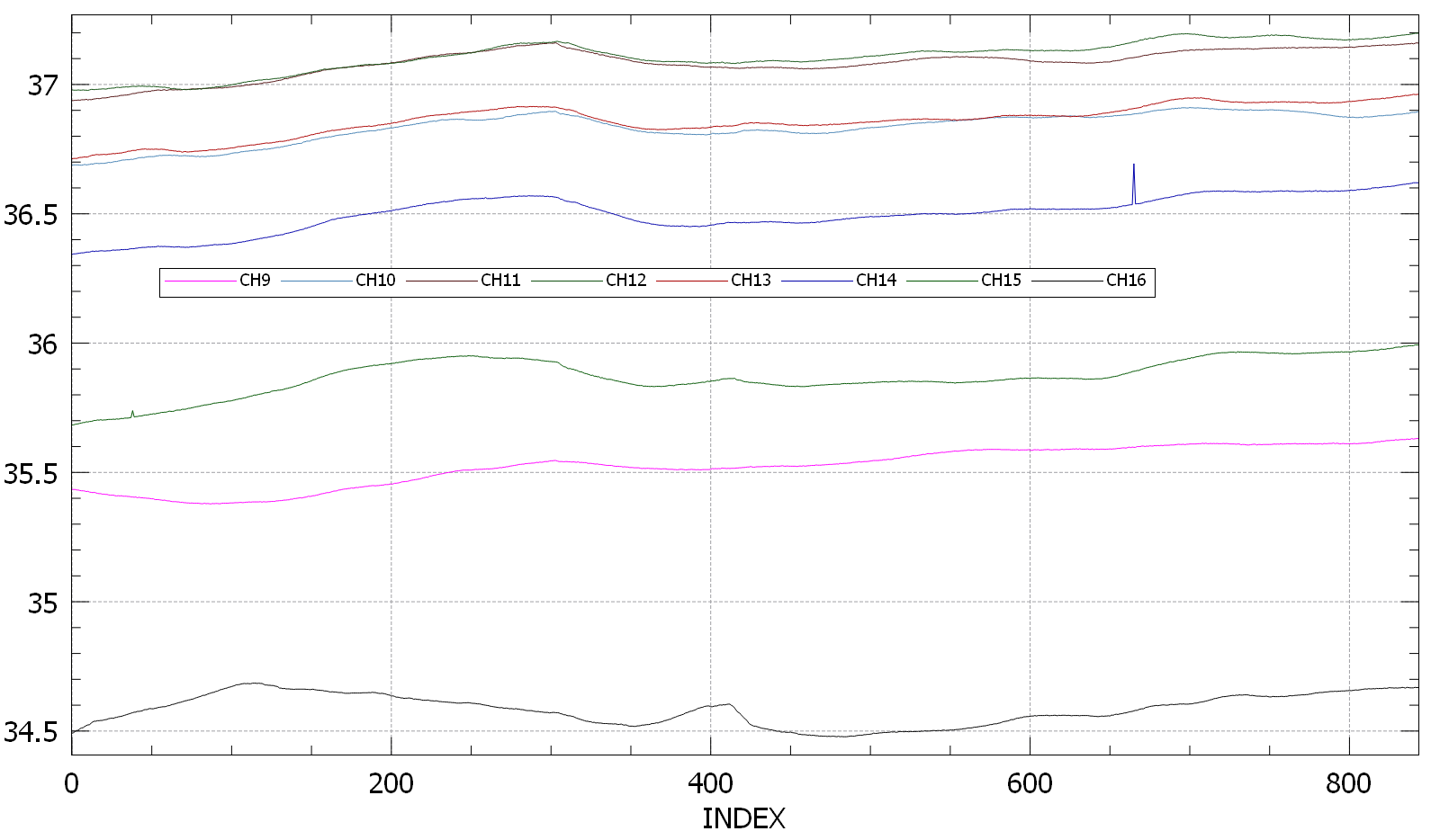

    I captured one channel with up/down spikes, a part of a long acquisition is in the Excel document (one channel only).
    Spikes in both directions.xlsx
    Joseph Wu said:
    Some channels have a high correllation to other channels. Also in some of these errors, the errors are similar in magnitude.
    I noticed that too, sometimes it looks like spikes are approaching a particular level. Please notice that vertical scale is temperature of a sensor, as the sensor is close to the ADC it somehow reflects temperature of the chip as well. When temperature changes intensity of spikes changes as well, that is why I thought that temperature affects the issue. Actually I think (a theory only) that it possibly does but indirectly: temperature affects significantly a frequency of the internal oscillator of the ASD1248 (manifests by extending or shortening distance form a start of conversion to DRDY, the internal clock cannot be observed directly). The measurements in our application are requested asynchronously to the internal clock of the ADC, it might be that at some temperatures probability of the spike effect is higher as relation between the internal ADC clock and the asynchronous conversion request (SYNC command in our case) favours it.

    - to provide an external short to a thermocouple channel AIN0-AIN1 (voltage always 0V (+offset+noise))
    - additionally to not to toggle the gain and in the stage 2 it was also PGA=1
    - in addition to not to change the input and it was always a thermistor (AIN2-AIN3)
    In all cases the spikes were present if only Vref was changed from 2V to 0.6V. If the Vref was not changed (another test(s)) and it was always either 2.048V or constantly 0.6V no a single spike was observed.
    Maybe the issue is related (or similar) to overload condition not at the ADC input but rather from Vref side and internal circuits get unstable. How such instability  caused by overloading inputs looks like? Last time I sent some results showing two consecutive measurement taken from each ADC channel, I observed that sometimes the spike is present in the second measurement, usually of a lower amplitude, sometimes in an opposite direction to the expected value than the first spike. Can it suggest some internal instability of the chopper?
    Robert
