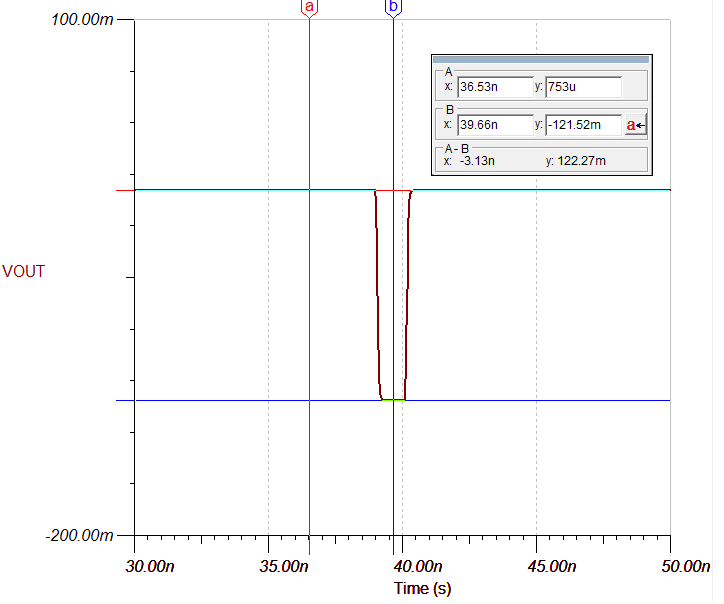

  • Bing,
    If you are using the VT1 in series with the PMT current source, then I don't think it is providing the right termination for the TI ADC board. The termination needs to be shunt across the PMT current source to provide proper 50-ohm termination. One way to think about this is that the current source and the shunt termination is a Norton equivalent of the voltage source and series resistor.
    To make this change, you could replace the R168 in the board schematic with 44 ohms instead of the 365 ohms, as shown below on the PMT source input (VIN-). Also, I just wanted to confirm that you should be using a 50-ohm external termination on the un-driven (VIN+) input like the Mini-circuits: MCL ANNE-50X+. I have verified the below setup in TINA-TI simulator and it does not seem to show any undershoot in the pulse response.
    Rohit
    Output pulse response:
  • Rohit, Thanks again. One thing is that the VT1 is a parallel 50ohm termination, not a serial terminator, so do you think we will need to change the resistor?
    Thanks, Bing
  • Bing,
    I think you are right that the VT1 is a parallel 50ohm termination, so you will not need to change the resistor. However, I do feel that the VT1 is bandwidth limited to <500MHz which might be responsible for the undershoot in the pulse response. One way to prove this is by eliminating the VT1 from the signal chain by replacing the R168 with 44 ohms and driving the PMT source directly. I think this might give you some clue as to where the undershoot is coming from.
    Rohit

  • Bing,
    I think the excess undershoot that you are noticing in your data capture might be a result of peaking in the transfer function of the signal path, while converting a single-ended signal to a differential signal. One way to reduce this peaking, is to operate the front-end amplifier at a slightly lesser bandwidth such that the peaking is reduced.
    I would recommend you to make the following changes to the schematic at the LMH5401 front-end, to reduce the excess undershoot. I was able to capture the data without much undershoot for a 1 ns pulse on the same board you are using.
    Rohit
  • Rohit, just want to confirm with you before we make the mod -- you did notice the undershooting for 1ns pulse with the configuration I used?
    Another question -- can you recommend a site to buy those resistors you suggested? Some were difficult to find...
    Thanks, Bing
  • Bing,
    Yes, I did see the undershoot for 1ns pulse for the falling edge as you saw in your data capture.
    I think these resistors are standard values available at sites such as digikey or mouser. http://www.digikey.com/product-search/en/resistors/chip-resistor-surface-mount/65769?k=Automotive%20Resistors. If you don't find the values I suggested, then the closer value resistor should also work.
