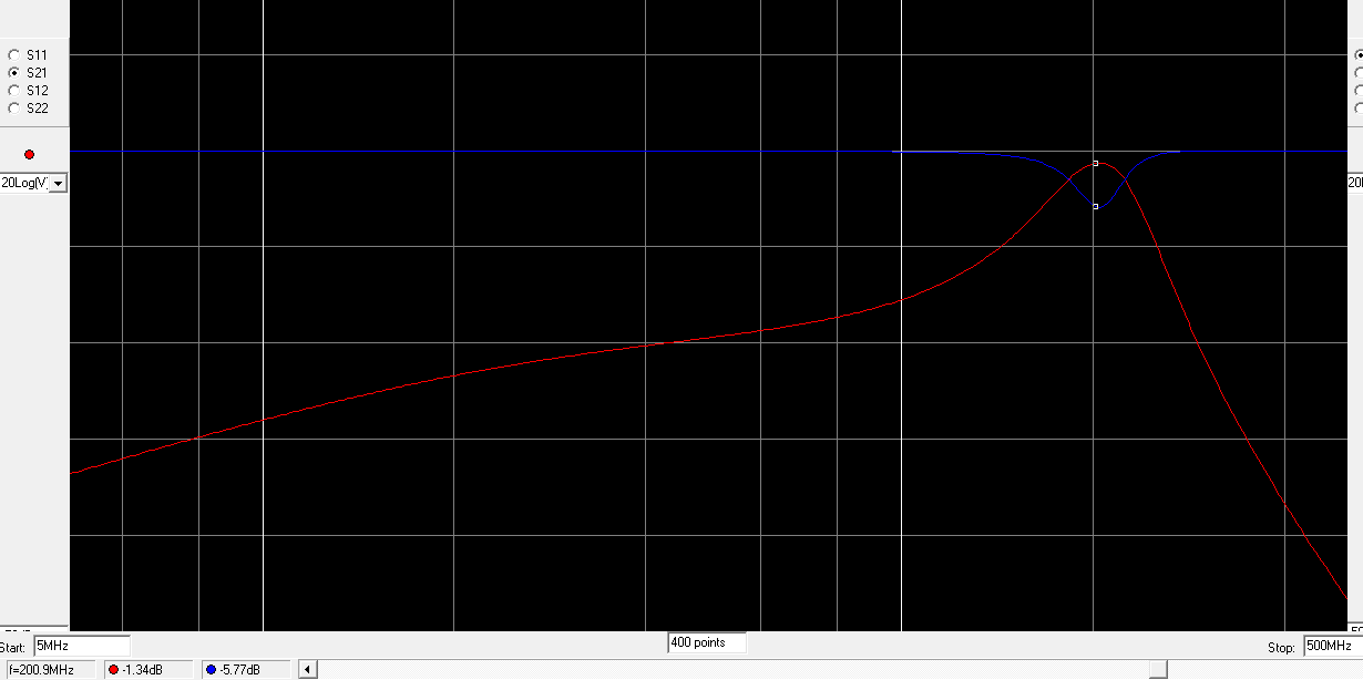

I have some issue with differential filter design.
Our board has the same configuration as SP16160CH1RB Design Board. But the bandpass filter must be with the next characteristics:
Center frequency - 18MHz
Bandwidth - 30MHz
Ripple <= 1dB
I am found some articles: SLWA053B "Design of Differential Filters for High-Speed Signal Chains" and SBAA108A "RLC Filter Design for ADC Interface Applications". With their help I make some converting with filter [From Differential Filter to Single-Ended].
Differential filter after converting:
Simulation in RFSim:
Bandpass filter has the same profile as on Figure 7 [snau079], but centered on frequency 200MHz (no on 192MHz). Maybe it is mistake in my converting.
Tell me please, how to change proposed in snau079 filter for my parameters ?
Maybe you have some formulas or program to calculate aforecited filter.
I am hope for your help.
