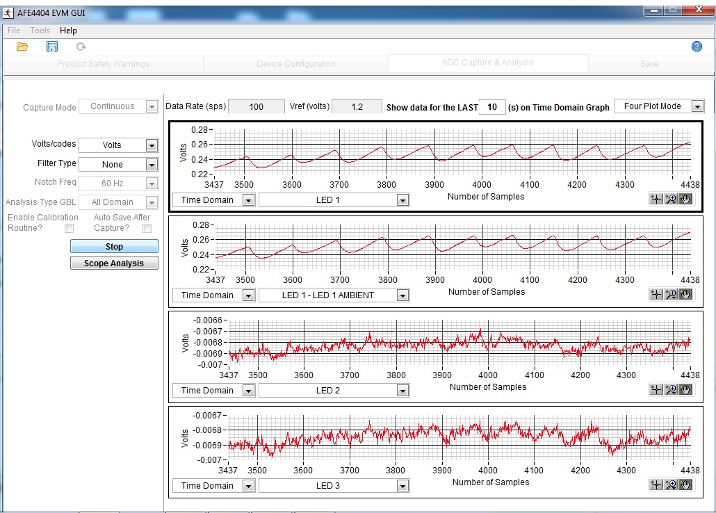

Hello All,
I have purchased AFE4404 IC as well as AFE4404  EVM,
I have configured EVM GUI and got sawtooth wave forms so taken those registers settings and went ahed after applying so many other ways I am not able to get heart rate.
There is not a single response from TI support side, even I found no document mentioning about the heart rate , I have posted even some of the queries related to that but got deleted and in initial conversation I got some of the links
- e2e.ti.com/.../1653596
- e2e.ti.com/.../369445 (see #18 question)
- e2e.ti.com/.../462275
I tried to follow them even but still I am unable to get heart rate so I request you to help me to get heart rate.
Or is there any one who has/had worked upon this IC to calculate heart rate ?
Did I chose the wrong IC to calculate Heart rate ?
Any help on this would be greatly appreciated.
Thanks & Regards,
Rutvij.

  • Hello Praveen Aroul,
    I have used the same code before to start work with but unfortunately it didn't work.
    I have commented SPO2  calculation part but Heart rate calculation is used as it is.
    I have used may configuration then after for register configurations.

    You mentioned that you configured the EVM and got sawtooth waveform instead of PPG signals.
    Can you attach the register configuration and the GUI waveform plots?
  • Hi Praveen Aroul,
    Thank you very for your reply really appreciated.
    I have attached here register settings and two of captured photos with the same settings.
    These were my last known good configurations I have tried many others as well.
    Settings were:
    PRF - 100Hz
    Duty cycle -1%
    Tx stage -> LED1- 24mA current  ,LED2- 0mA current, LED3- 0mA current
    Rx stage -> TIA_CF 22.5 TIA_GAIN 25k

  • Hi Praveen Aroul,
    It seems like you didn't get the time to view my previous posts, but anyway here is my new approach.
    While working on the code(which had been attached in the previous discussion) and GUI (which had been sent by you as a link), I tried to compare the resultant 2F register's output values (LED1-LED1 AMBIENT) I got following of them which seems different so requested to guide me here.Also note that in both the cases my finger was on the LED module.
    Resultant values from the AFE4409 TI's GUI of 2F register:-
    0x107379
    0x13E225
    0x1683c4
    0xef995
    0x10fc9b
    0x10c1f2
    0x11cafe
    0x11a5af
    0x127d8b
    0x12e65d
    0x10c4b7
    0x12940c
    Resultant values from the source code: -
    0xFFF7BD85
    0x00012626
    0x00012226
    0x00013459
    0x00012861
    0x00012FD6
    0x00012997
    0x000111E7
    0x0001053F
    0x00012878
    0x00011DDB
    In both the cases my register settings are same i.e 24mA- LED1 current, LED2 Current - 0 mA ,LED3 Current - 0 mA,PRF = 100 Hz, duty cycle - 1%.
    Please let me know if I can provide any further details.
    Thanks & Regards,
    Rutvij
  • Hi Rutvij,
    The PPG waveforms that you have attached from the EVM GUI are as expected.
    The periodicity of the pulsatile signal averaged a period of time should give the heart rate.
    There is no other documentation available associated with the source code.
    The AFE4404_Reg_Init() function in AFE4404.c under AFE4404 directory will list the register values the EVM is programmed with initially through the firmware.
    Regarding the difference in the 0x2F register output values, are you using the following snippet in your code?
    if (offsetDACcalibFlag == 0)
    if (readDataFlag)
    readDataFlag = 0;
    offsetDACcalibFlag = OFFSET_DAC_Code_Est(AFE4404_Reg_Read(45));
    if (offsetDACcalibFlag)
    AFE4404_ADCRDY_Interrupt_Disable(); // Enable DRDY interrupt
    If you are using, you may want to skip over this by setting offsetDACcalibFlag to 1.
    Also instead of reading 0x2F register, can you read 0x2C and 0x2D registers separately and then compare the values?
