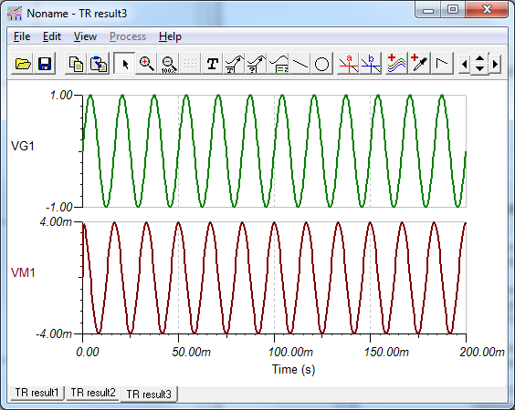

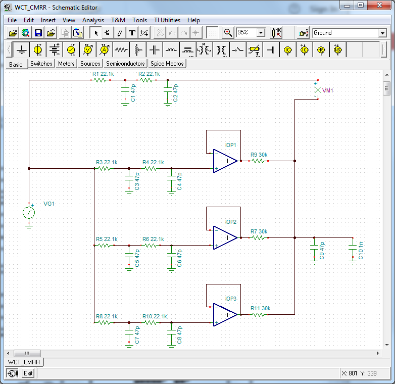

  • César,
    What you're seeing is 60 Hz utility interference produced by mismatch in the transfer functions of the respective negative and positive inputs' RC filters.
    Note how the electrode inputs have the second order RC filter with a cutoff frequency of ~227 kHz. The WCT output that gets fed to the negative channel input has an RC cuttoff of approximately 5 kHz. This is due to the low pass transfer function of the WCT circuit. Look at page 36 of the datasheet. There are 30 kOhm resistors at the output of each WCT amp. Then, in your circuit, there is a 1nF capacitor at the WCT pin.
    The result of this is that the 60 Hz mains interference (which is common to all electrodes) gets filtered more heavily buy the WCT circuit and so it appears smaller at the IN1N input than it does at the IN1P input. This allows it to pass to the ADC. I simulated the ideal circuit in TINA-TI. Below I show the schematic where a common 60 Hz signal is fed to a single positive input through the RC filter and then to 3 other inputs that correspond to the limb leads. They are then buffered like they are on the WCT amplifier and sent to the negative input of a voltmeter. I attached the simulation file to the end of this message in case you want to simulate the behavior yourself or see how modifications will affect performance.
    The results illustrate my point about common mode rejection.
    If you want to fix this, I recommend setting the cutoff frequency of the WCT circuit much higher in frequency and also bringing down the cutoff frequency of the electrode RC filter slightly. Please download TINA-TI and play with the attached simulation file to find a good combination.
    Brian Pisani
