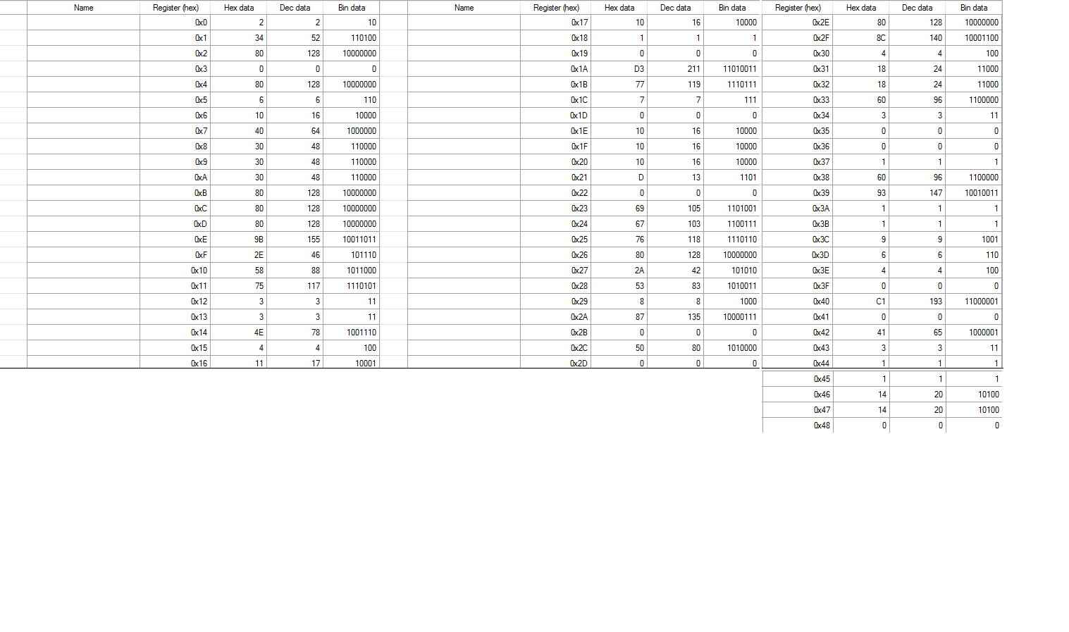

    Thanks for looking.  I was able to get the setup files in manually set up the registers one at a time using a USB to I2C utility. I am getting lines drawn across the screen but the not image that should be displayed.  I am having trouble getting the HSYCN pulse width to be the correct value to match the LCD spec.  I have been able to get the Data Enable, VSYNC, and Dot Clock to all be the correct frequency and duration but nothing I seem to do has an impact on the HSYNC.  I have data coming out on the data bus but obviously since my HYSNC is incorrect it all just looks like garbage.  While I am happy that at least something is coming out I seem to be spinning my wheels at the moment.  Below is an image of my entire memory space for all the registers.  I have tried adjusting the HYSNC width explicitly as well as other registers but to no avail.  The pulse width is currently around 400usec and needs to be around 70usec.  Any ideas what you would look for or that I am overlooking?
    Thanks again,
    Dave

  • The LCD is 800x480 so the source MUST match this, otherwise you will get clipping and/or other issues.
    Earlier you mentioned that the analog source was 720x480i so you cannot simply connect the digital signal to the LCD.
    The resolution is wrong (720x480) and needs scaling to 800x480. More critically though the analog source is interlaced and the LCD requires progressive. This necessitates a de-interlacer.
    The TVP7002 is simply an ADC and does not contain either a scaler nor a de-interlace.
