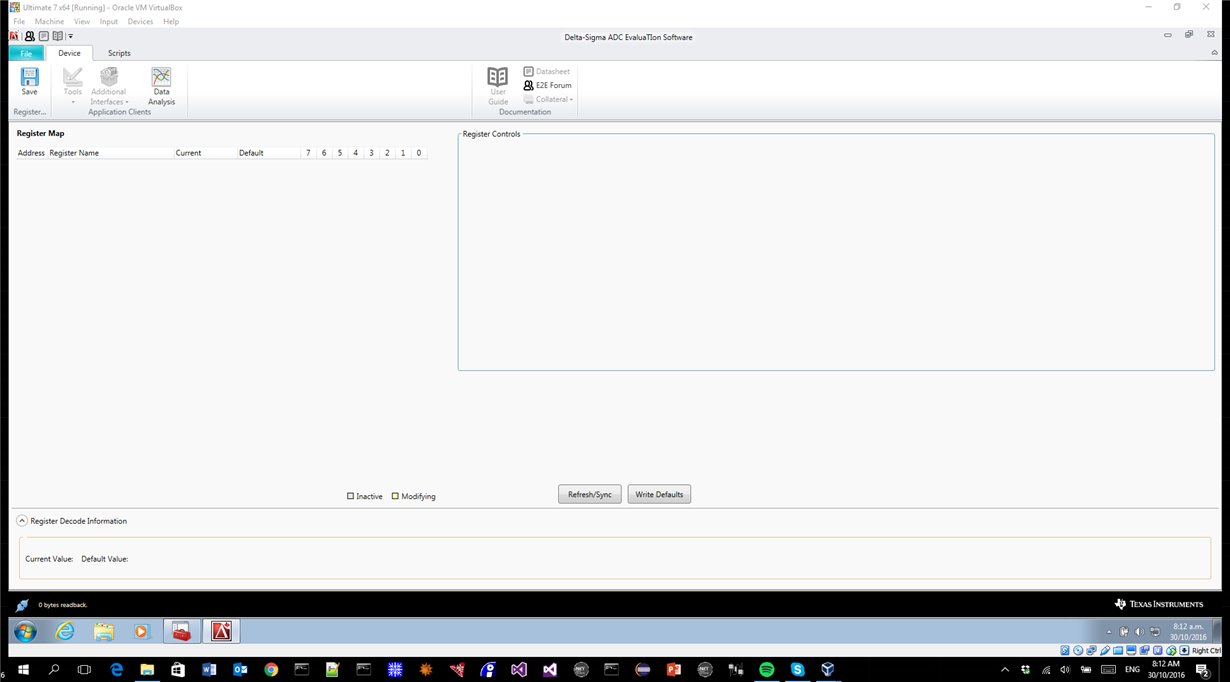

    Regarding the Win7 VM. Yes, it is listed as the TivaWave Bulk Device. Windows thinks is installed OK and operating correctly.
    On running the application the first time it crashed, then on second run it started and appeared to connect, but it did not display the registers.
    Running the app in the Win7 will sometimes crash. Above screen shot achieved after a reboot of the host, and only plugging in the USB withthe focus inside the VM and not having presented the USB before launching the VM.

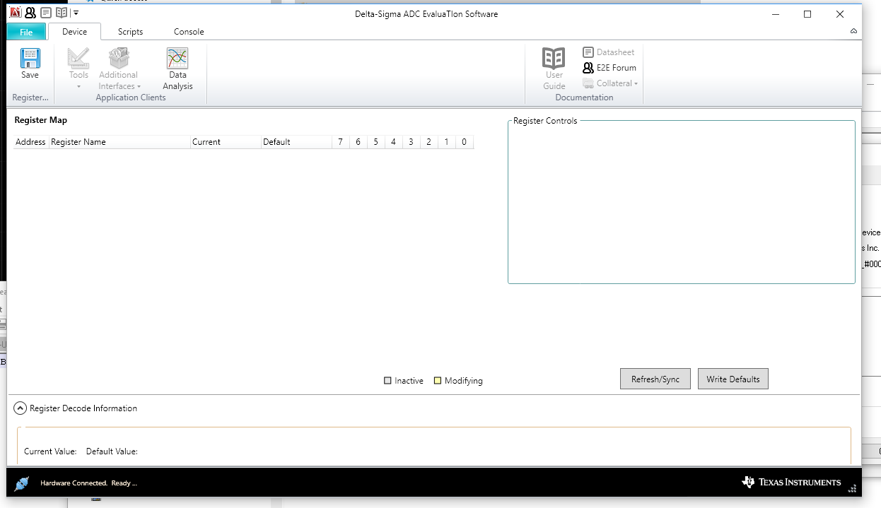

    I disabled driver signature checks in Win10. The USB bulk driver installed.
    What should be displayed in the TI test application after it connects to the EVAL board? How do I record a measurement...
    Screen shot showing driver installed.
    When I run the eval software not that initially it displays the following message in lower left corner during start up ....
    but then changes to "Hardware Connected. Ready.
    But no register data displayed? Is it working as expected? something else I need to do?
    Richard
  • Hi Richard,
    The fact that the GUI updated to show the screen above and reads "Hardware Connected. Ready..." indicates that the firmware is running properly and communicating with the evaluation software. If the Register Map is simply not loading, make sure that the GUI is pointed to the correct folder where the ADS127L01 Device Package files are saved, such as "C:\...\Documents\DSEvalSW\Devices\ADS127L01." You can verify this in the GUI under File->Options->User Directory.

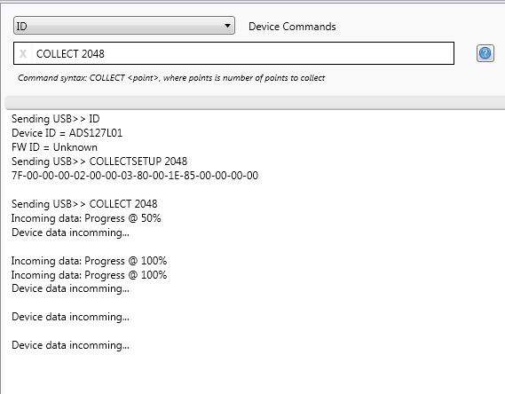

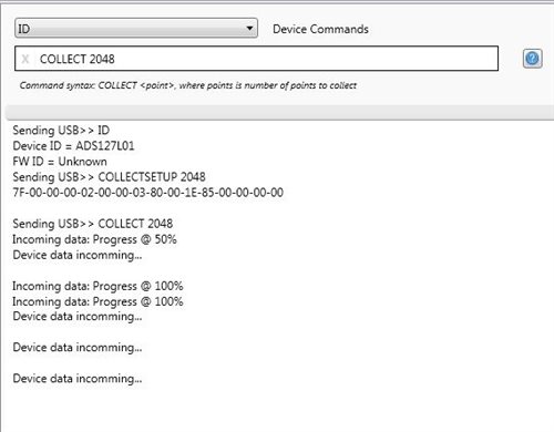

  • Hi Richard,
    The software can hang up if no data is received following the COLLECT <n> command. The COLLECT <n> command can be issued from the Data Analysis window or from the Console directly, both do the same thing. When data is collected, it is shared simultaneously to all opened Data Analysis windows and can be viewed through any of the available tools (i.e. scope, histogram, etc.). The message "Client went away!" simply indicates that you closed a Data Analysis window, but it's not a problem (opening a new one will display the same data you previously collected).
    When you issue this command, the log screen on the Console should display something like the image below:
    If data there is no data sent to the GUI, please try the following:
    1. Unplug the EVM and close the GUI (Data Analysis windows too).
    2. Plug in the EVM and configure the jumpers/switches per the Default Settings in the User Guide.
    3. Probe the /DRDY pin to ensure that the device is converting and outputting data.
    4. Start the GUI.
    5. Refresh the Register Map and verify that the register contents update with the correct settings.
    6. Issue the COLLECT <n> command from the Console or Data Analysis window.
    Let me know whether you are able to collect data after this or if any of the above steps failed for you.

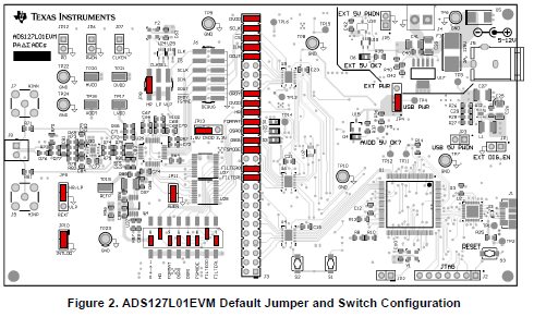

  • Hi Ryan,
    Thanks. Its working now.
    I re-checked the jumpers and found I had overlooked the DVDD selection jumper (was open circuit).
    Setting that to the default 1.8V clearly made all the difference :-)
    For the benefit of other readers, the reference diagram from the user guide.
    Data analysis shows ENOB of 18.2 bits with the inputs open or shorted.
    Thanks for the help.
