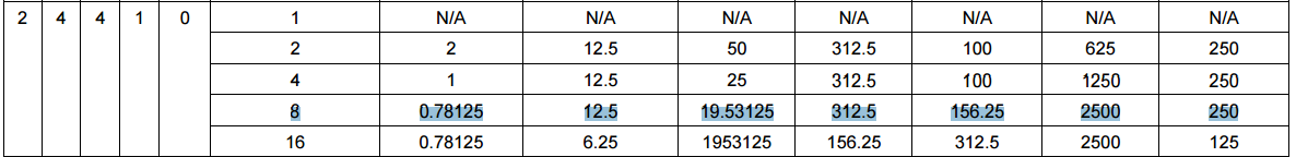

  • Hi Jim
    Looking on table 11 on the data sheet, it looks like the only option for me is
    So I will have to use X8 interpolation. Can you please explain how the serdes rate is calculated

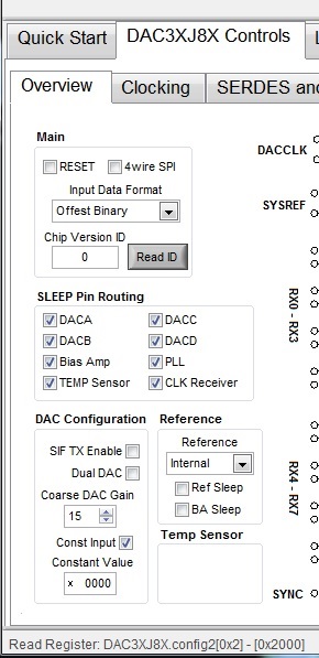

    When I use the NCO mode for DACC and DACD, What is the values of the data lanes? since I don't have any data, I am using only the NCO

    Based on a int of 8x, the serdes lane rate will be 9.6Gbps. The input data rate will be 240MHz. The shortest time to change the NCO setting would be when using a SCLK period of 100ns. This would take 4 register writes, which would be 9.6us. What do you mean by "What is the values of the data lanes?"

  • When I use only NCO mode,  what value is required in the serdes lanes,  because basically they should be DC.
    Can you please explain the serdes rate calculation?
  • Izik,
    When using the NCO as an output tone, set the Input Data Format to "Offset Binary" and select the Constant Input box as shown in the attached slide.

  • Ken hello,
    Using data formats offset binary or two's complement, how can the DAC be set to full scale (constant value of all ones or other) using the SPI only, without need of the high speed serdes (JESD 204B).
    We have an application that only constant frequency signal need to be generated, and we want  that the DAC high speed serdes lines will not be connected at all. Is it possible ?

    You may set the DAC with constant input value.  For offset binary you may use x0000 or xFFFF (min or max value).
    For 2s complement the min value will be x8000, the max value will be x7FFF.  x0000 and xFFFF are 0 and -1 for 2s complement.
