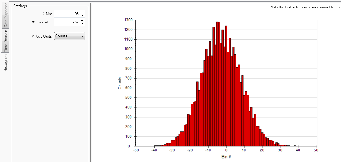

  • Hi Ryan
    Was looking at the noise data and noticed that histogram has some noticeable small scale pattern on top of nice looking larger scale Gaussian shape. Any ideas what could be a cause of this?
    Best regards
    Zerg
  • Hi Zerg,
    To me, this looks like a matter of using a non-integer bin resolution, where the number of codes/bin is not an integer multiple of the LSB size of the ADS127L01. If you were size the bins to contain say 10 codes/bin, this smaller distribution pattern should disappear.
    Our new GUI has a built-in histogram tool that allows you to customize the plot by specifying either an integer number of bins (from which codes/bin is calculated) or an integer number of codes/bin. You can experiment with different bin sizes to see the effect on the same set of data.

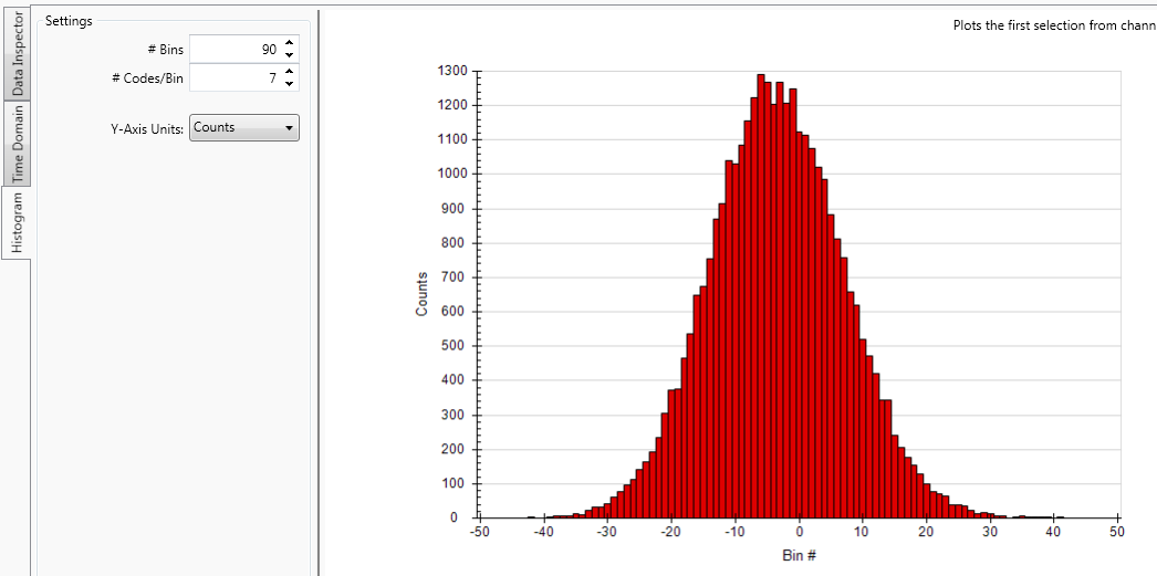

  • For example:
    6.57 codes/bin
    7 codes/bin
  • Hi Ryan
    To avoid any truncation issue I aligned bins to get integers exactly at the bins center. So, I would say there should not be problems with math I'm doing. Going to double check it to be sure, but I'm quite confident on this stage.
    I agree that making bins wide enough would wipe those peaks, and it is unlikely  to be an issue in our application. Although it is good to have a good understanding of hat is going on.
    I would suspect that this is a result of truncation on  on of the decimation filter stages.  I'm a bit surprised that it is still visible with such amount of analogue noise present.
    Zerg
  • Here are my bin edges. Look quite half integer too me. Also TI software turns to agree with my results:
  • Hmm. In that case, I really am not sure what the cause may be. I agree that the way you've set up your bins looks correct to me and the fact that the GUI shows exactly the same result should confirm that's not the issue.
