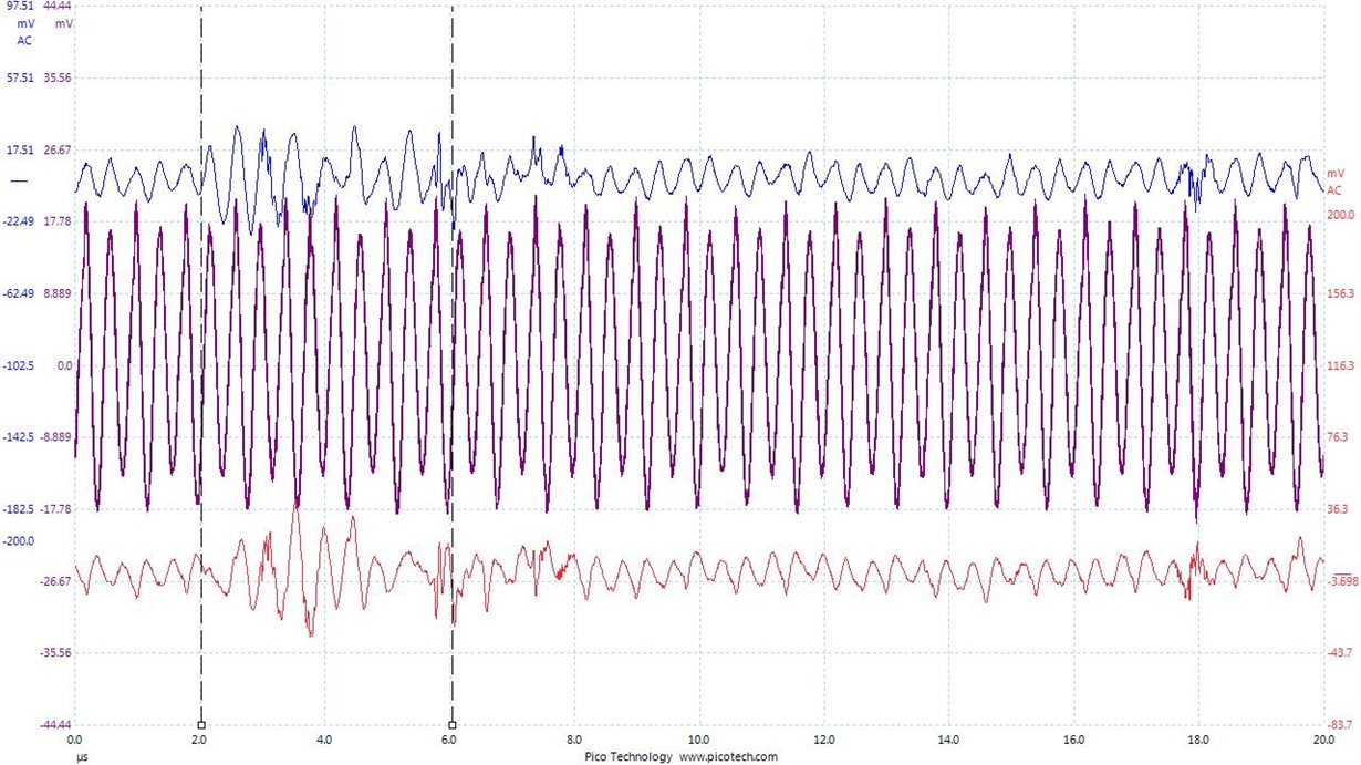

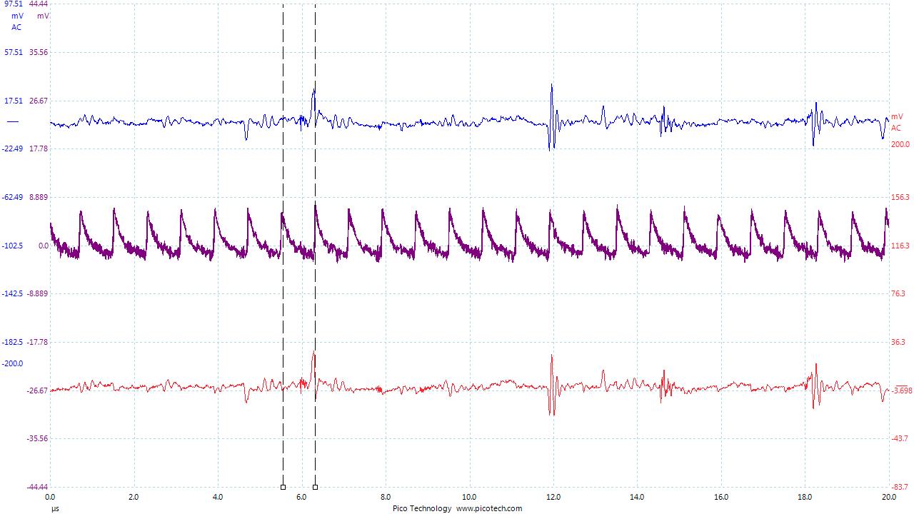

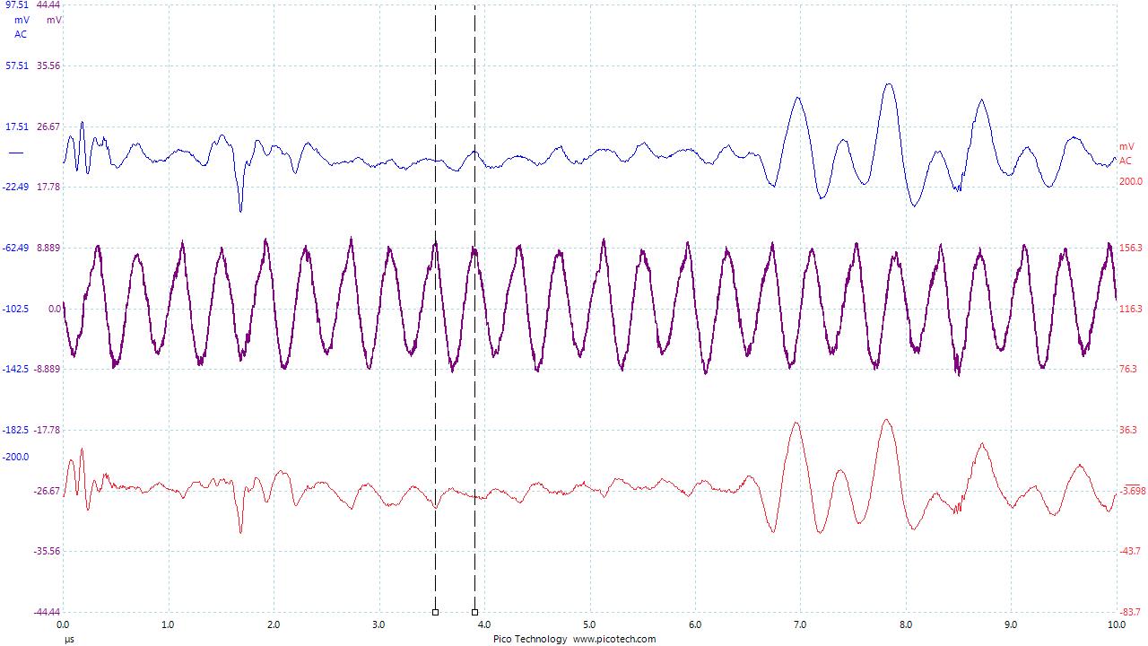

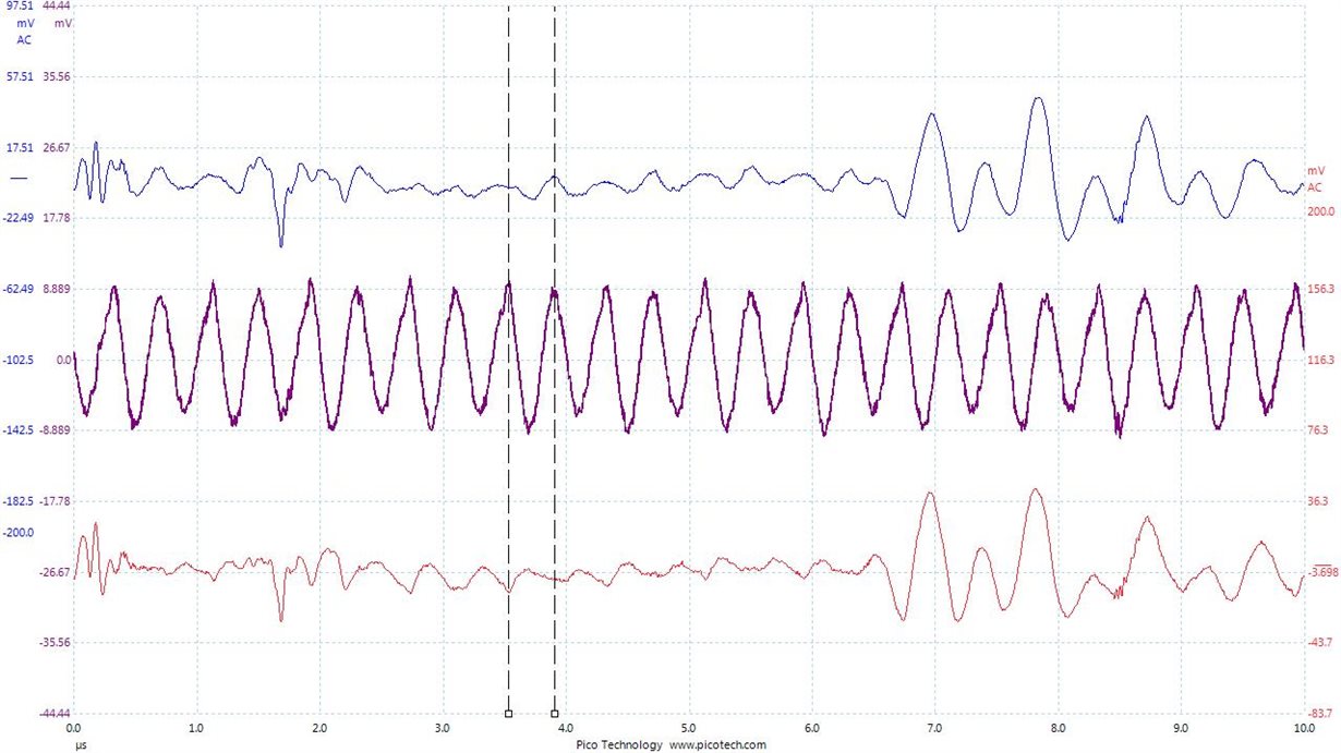

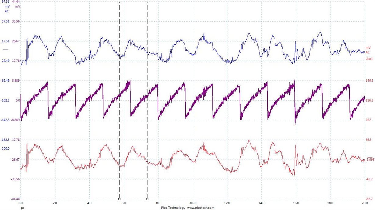

  • Ryan,
    On the un buffered demo board there definitely are larger transients than with the buffer on.  It's possible this is what is causing the gain errors (the 1278 is sampling at a different point on the sine wave at different frequencies causing larger errors at those frequencies.  The transient values definitely increase at large Vins and the error is always within the magnitude of the transients.  With the buffer on there is still some transients however the waveform has areas when it goes to zero and perhaps the A2D is always sampling there.  Also note that at 5Mhz input frequency for some reason the ripple value on the unbuffered signal doubles.  I checked this several times and it always seems to happen at 5 MHz.  I did not see this at any other frequency.
    On my prototype board however the ripple is somewhere between the two but the error is larger than either.  On my board the error is well outside of the ripple value at some sampling rate.
    Below is a table of my measurements as well as a couple of scope traces.   To measure the ripple I had to subtract two single ended scope measurements so there is a bit more noise in the signal then I would like but it still seems to be an ok measurement.  The predicted VIn is based on the sensitivity at 1 Mhz between 0 and 1 Volt in.  my prototype board has a 10x buffer which is why the input voltages are different.  The voltage there is the voltage after the 10x buffer.

    5MHz Input No Buffer  1 Volt in
    5MHz Input No Buffer  2 Volt in
    5MHz Input Buffer  2 Volt in
    5 MHz Proto Board 1.8 Volt in
  • Hi Joseph,
    Very nice job with the scope measurements. I myself have struggled with making similar measurements that were clean and conclusive.
    The input buffer is absolutely needed to settle the input voltage between samples. I'm assuming the purple curve in the middle of each plot is the differential voltage at the ADC inputs (i.e. the difference between the curves above and below)? Without the input buffer, I believe you are seeing the inputs oscillating (this is still a DC input voltage, correct? :) )
    The two plots with the input buffer at the bottom look closer to what I would expect to see. The input voltage settling is following the R-C time constant at the buffer output. Although the voltage does not flatten and fully settle, it should reach the same point after each sample for a given sampling frequency and DC input voltage, resulting only in a gain error. The gain error measurements will not be valid if the inputs to the ADC are ringing as shown in the first two images.
    Also, I noticed that the modulator frequency is only 625kHz in the last image taken from your proto board. Can you confirm that you are using the same ADC configuration?
  • Ryan,
    Yes, the purple curve is the difference. I think I figured out what my problem was. The input buffer on the individual channels was working well but I did not have a sufficient buffer on the reference input. Because the reference input changes impedance so much with sampling rate I couldn't put the same kind of RC filter on it. I improved the buffer on my board and it is working well now.
    BTW the reason that the bottom image was sampled at 625 kHz was due to a error in my code which was giving me the wrong sampling clock.
