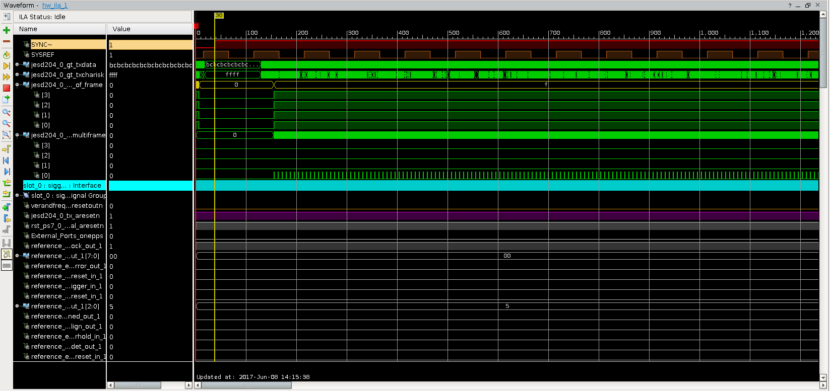

I'm trying to use the Xilinx JESD204B transmitter IP core to send data to a DAC39J82 on our board.  I'm having problems getting a healthy link established.  I'll try to describe my problem first, and then I'll go over how I'm trying to setup the JESD link.
When bringing up the link I believe my system is failing to achieve ILA.  I have both the JESD FPGA core and DAC initialized, and my SYSYREF signal set as a continuous periodic pulse.  The SYNC~ from the DAC goes low, indicating that we are trying to resync.  It then goes high, which I thought only happens after code group synchronization is achieved.  The core then tried to put out some data and the DAC almost immediately drives the SYNC~ low again, trying to resync.  This continues in a loop, and I have a waveform capture of the process from a logic analyzer core in my FPGA at the bottom of this post.  The DAC lane alarm registers (config100 - 107) are indicating that my 4 lanes in use are all getting the "code synchronization error" and "8b/10b disparity error" bits set.  These are defined in the actual JESD JEDEC standard sec 7.6.1 table 18 as "The state machine for code group synchronization has returned to the CS_INIT state" and "The received code group exists in the 8B/10B decoding table, but is not found in the proper column according to the current running disparity." respectively.
If you look at the included screencap you see that my JESD transmitter core is properly sending out the K28.5 commas (0xBC on txdata line) when SYNC~ goes low... so if I'm getting a disparity error I think that means the data is possibly getting corrupted en route to the DAC, or in the DAC itself.  I am looking for advice on next steps to take to try to resolve my ILA issues.  I feel like using the various test sequences is probably the answer, and I've tried, but I think I'm missing something in the setup because the TESTFAIL pin always just reads 0 (passing test), even when I intentionally feed in an incorrect sequence. I've tried using the PRBS 7 sequence and the continuous K28.5 character sequence.
My JESD setup is as follows: LMK is set to 421, 32 frames per multiframe, HD = 1, S = 1, elastic buffer = 31, serdes line rate is 6.25 Gbps total throughput, so 1.5625 GHz lane speed.  My clocking is using a 1.25 GHz input at DACCLKp/n, I'm bypassing the DAC PLL and dividing down by 4 prior so that the serdes PLL reference clock is 312.5 MHz.  This then is multiplied by 5 internally, and my serdes PLL output is then 1.5625 GHz.  Register config108 is reading 0x07, indicating that serdes block 0 PLL is locking, block 1 is out of lock (expected since I'm only using the 4 lanes for block 0) and the DAC PLL is out of lock (expected since I'm bypassing it.)  My JESD clock is set to be the DACCLK divided down by 8, so 156.25 MHz.  My serdes is configured with ENOC = 1, fully adaptive EQ, CDR = 0, full rate, AC coupled termination, 20 bit bus width, gain boost = 0, LOS disabled and hold EQ off.  I'll attach a print out of all my register settings as read from SPI (ie not sure alarms and such will be right because I literally am just reading all the registers in a loop.)
Sorry this post turned into a bit of a knowledge dump, but I don't know exactly what details you'll need to know to help me.  Any advice?  What additional info can I try to provide for clarification?  I'm also talking to Xilinx support via email, but I'm more confident in the transmitter at this point due to there being fewer moving parts (less rope to hang myself with), and clearer documentation for that IP core than what TI provides for the DAC.

  • DAC38J82_421_983p04.pptx7181.DAC3xJ8x Device Initialization and SYSREF Configuration.pdf156.25_LMF_4211.cfgKyle,
    We are very short handed right now due to trade shows and vacation. See if the following helps. I am assuming you are interpolating by 8 and have an input data rate of 156.25MHz. I generated a config file based on this as well as your other inputs and attached it with a few other documents. TI has a TSW14J10EVM that allows users to test our EVM's with off the shelf Xilinx development boards. Go to this product folder on the TI website to obtain documents regarding this along with sample source code.
    Jim

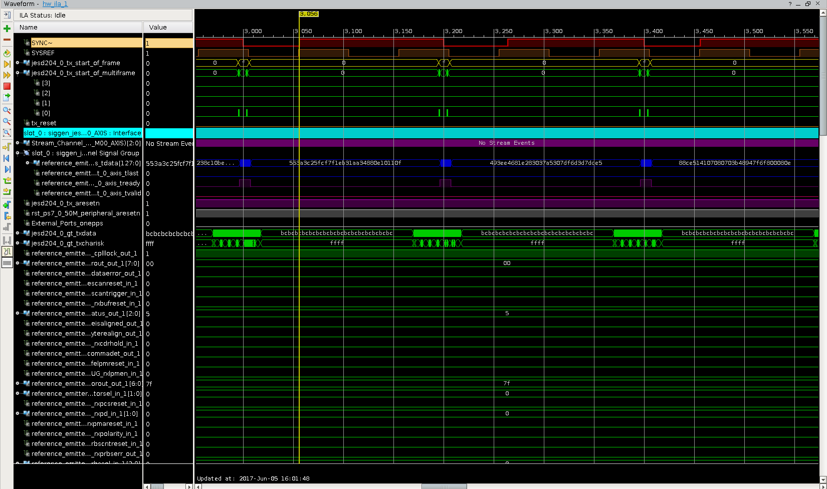

  • Hi Jim,
    Thanks for your timely reply.  I've made some progress from my last post, and I believe I am getting lane alignment properly now!  I changed my JESD clock divider from an 8 to a 4 (setting the JESD clock to 312.5 MHz instead of 156.25 MHz.)  The Disparity and code sync errors are no longer triggering on the DAC.  I am, however, still getting errors for each of my four lanes complaining about: "write_error : Asserted if write request and FIFO is full" and "read_error : Asserted if read request with empty FIFO".  I am clearing and polling these registers every two seconds while running my system.
    I've attached a new updated system timing diagram as seen by the logic analyzer core built into my FPGA showing the ILA sequence and data getting through.
    The TI datasheet on my DAC has practically no details about the FIFOs... my best interpretation of my errors is simply that something about my DAC timing configuration is still messed up.  Is there any other insight that you could provide into those FIFO errors?  Have you seen problems with them before very often?  What are the typical issues at play in those cases?
    Thank you very much for your time,
    Kyle Harris
  • Kyle,
    FIFO errors are usually caused by using an incorrect clock frequency, either for the data rate coming into the device or the DAC sample clock when interpolation is set to any value other than 1.
    Jim
  • Hi Jim,
    Since my last post we've cleared up the write_errors in the FIFO, but we still are getting read_errors.  I'm going to try to slow down our system (use 3.2 Gbps line rate instead of 6.25 Gbps) and see if that affects anything, but I have a hard time believing it's just a clock configuration issue because  I've gone over the numbers quite a few times now, and _most_ of our data is getting across just fine.  We're verifying by generating our own modulated PRN sequence in our FPGA and sending that through the JESD to the DAC.  We are then correlating our DACs output with a pristine PRN file and we get a very high SNR, telling me what we're sending is very close to what it should be.  But whenever I reset and poll the lane error registers during transmission I always get that read_error.
    Should I try setting interpolation to 1 and seeing if it goes away?  Is there any chance my slow down test will yield something useful, or is that a waste of time?  Have you guys ever seen something like this before, where the ILAS is working fine, SYNC is not getting lost, but there are persistent FIFO errors?
    Thanks again,
    Kyle Harris
  • Kyle,
    What is the actual register address and error data value that you are getting? There is a FIFO read warning that customers sometimes confuse it to be an error. Did you clear the error registers before you read them? Can you send me your complete DAC configuration file and I can try this on our EVM with both an Altera FPGA and Xilinx FPGA to see if I can duplicate it?
    Jim
  • Hi Jim,
    Thanks for the timely reply! The registers I get the read_error bit set on are config100 - config103, all four of those (one for each of our lanes.) Specifically each of those registers is reading as 0x0002, and that bit set reads as follows in the TI DAC39J82 datasheet: "bit1 = read_error : Asserted if read request with empty FIFO". I am clearing those registers before I read them, as they are not automatically reset.
    I am not using the TI EVM, but I'll see if I can send the python code we're using for setup to you.
  • Kyle,
    I think I was able to duplicate your problem. On our setup, if I load the DAC configuration and then reset the JESD core before sending data to the DAC, I get these errors even with valid data coming out of the DAC. When I write a "0" to the error register to clear it, this does not clear it and I still read back the FIFO read error. I was informed that these errors occurred since the FPGA was not sending data, and the only way to clear this error register is to do another DAC JESD core rest. After doing this, the errors went away. If I had FPGA data present to the DAC before issuing the DAC JESD core reset sequence, I did not get these errors at all. I think the data sheet will need to update the information pertaining to clearing these registers.
    Jim
  • Jim,
    That worked, thanks!  Unfortunately for me it means that this FIFO error isn't the cause of a different problem we're seeing with our output, but it's good to know not to spend more time worrying over it.
