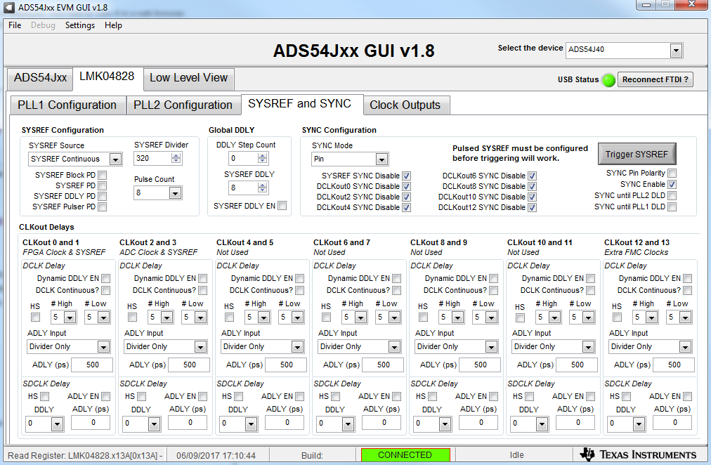

    If you are sending an external 1GHz clock to the LMK, you must use the LMK device in external clock mode. Can you send screen shots of the LMK output clocks and sysref and sync tabs? There are certain settings that must be set and I think you may have one of these wrong.
    Jim
  • For the case where I'm using the refClk to drive the core (125MHz). The SYSREF is setup to be 3.125MHz.
    I have also tried reconfiguring the Xilinx core to use separate ref and glbl clocks. For this I change the clkout 0 divide to 4 to drive refclk with 250MHz and enable clkout8 with a divider of 8 to provide the glbl clock.
  • Richard,
    When dividing by 1 with the DCLK in the LMK tab, you must set the DCLK Divider to "Divider+DCC+HS". Other wise the output is unstable. In our example when using a very similar setup (see attached), we provide a core clock that is the ADC sample rate/4 (250MHz in your case) to the KCU105. You may want to try this as well.

    The GUI buttons are unstable and I would suggest not using them. Stick with the provided configuration files, create your own configuration files, or use the low level register read write option only. Are you issuing the board reset after the sample clock is up and running? How much current is your power supply able to provide to the EVM? Make sure this is at least 3A. Did you change the DCLK divider setting like I mentioned in the last post? Did this help?
    Jim
  • Sorry for the delay in replying, I got it into a working state this morning and didn't want to fiddle with things whilst I was looking at some other aspects.
    I have switched to using a 250MHz refclk with 150MHz glbl (core) clock. Therefore I enable CLKout12 on the LMK. I had also switched the DCLK source. I have just power cycled everything and using these setting do seem to be able to achieve sync again although I do have to reprogram the FPGA. In our real design the FPGA will have access to the SPI lines for the ADC and LMK but for some reason you don't pass these down the FMC connector on your eval board. I'll have a play with holding the core in reset until i've set up the clocks via the GUI and hope that gives me consistent results.
