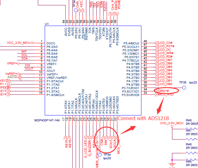

    I am sorry to bother you again. Recently I start to test the ADS1218 with MSP430F149. However,  the ADC does not work. I configure the ADC SETUP register and set the voltage reference out as 1.25V. But the voltage reference output is always 2.5V.  I found the SPI works well by using oscilloscope to observe the DOUT, DIN, SCLK, CS line when I send the command. The power supply of ADC is 3V. The POL pin of ADC is set high. And the SPI program and ADC configure program list below. Can you give some advice for this problem, thank you very much.

    //********The circuit diagram of ADS1218 and MSP430F149*********//
  • Hi user4908522,
    You have given a lot of useful information.  However, with respect to communication it would be helpful for me to actually see logic analyzer of oscilloscope shots of the communication; in particular, CS, SCLK, DIN and DOUT.  CS must go low and stay low throughout the entire communication transaction.  Based on the information it would appear that the ADS1218 is not responding to the communication.  The first place to start is to read the registers first to see if you get the default power up values.  You also need to check that all power supply connections to the ADS1218 are valid (both analog and digital supplies), and RESET, PDWN, DSYNC pins are high.  Also, you must have a valid clock, so verify that the crystal is truly oscillating.
    Bob B
  • Hi Bob,
    I had check all the points you mentioned above again and everything is ok. Then I run the code step by step, the voltage reference output become 1.25v just same as setting value. However, if I run all the code at once , the voltage reference output become 2.5v. It seems too weird. I doubt the the delay time in SPI Send and Receive function is too short. Therefore, I set the delay time from 80us to 200us in Send and Receive function (the SCLK is 100kHz) , however, this phenomenon still exist.

  • Hi Bob,
    Thank you very much for your patiently answer. The reason for that strange phenomenon I had found. Since the power supply is controlled by MSP430 digital IO in my PCB board, after power up the ADC, it need to wait some micro sencond to write and read ADC.  The final code structure as follows, then the ADC works ok.
