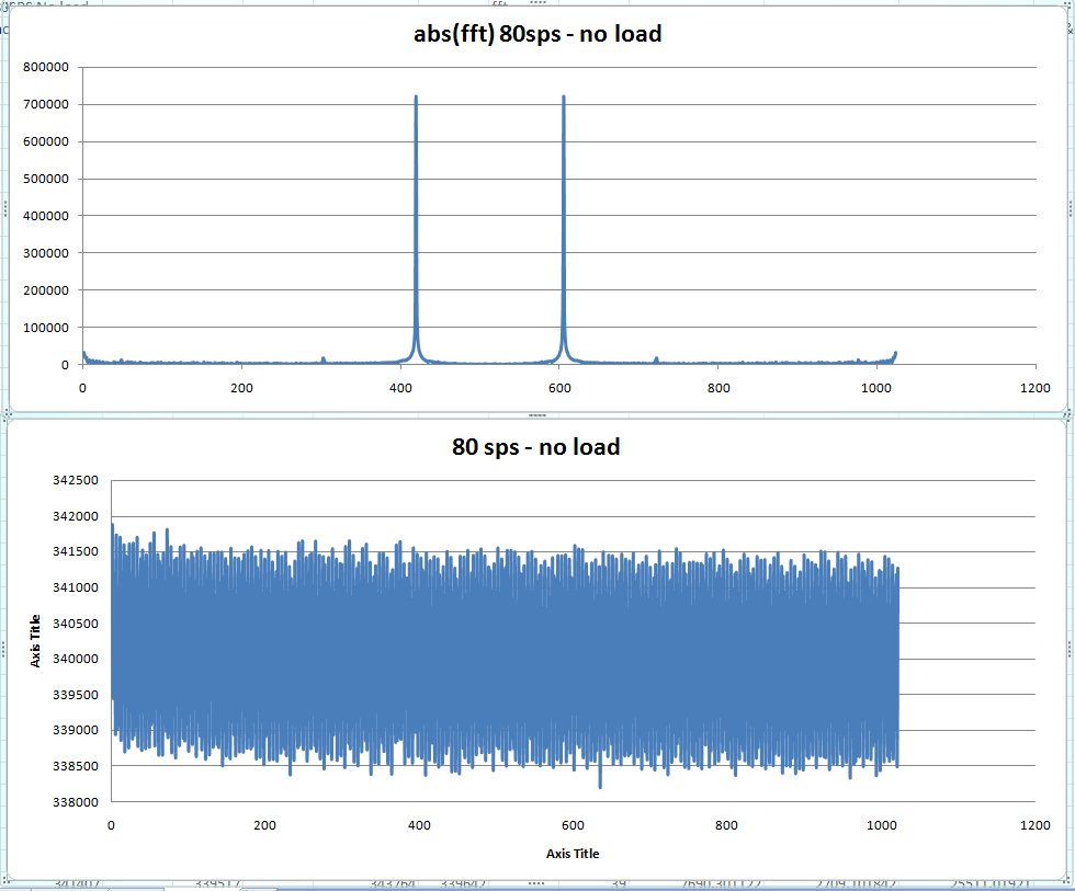

3.  Another thing is my data for 80sps seems too consistent and repeating a similar pattern & I do not know if this is to do with my power supply frequency or how I am obtaining the data? how can I get rid of that so that the data is more similar to the data sheet.
  • I have done the FFT for the 80sps no load results which appear with the results being periodic, I get two peaks on the 395th and 419th samples frequency 30.85Hz & 32.75Hz but I am not sure what that means. I am guessing I am getting some external noise somewhere? or could it be how I am obtaining the results like a coding issue?

    For the noise tables in the datasheet, the input is shorted together at mid-AVDD supply.  The amount of noise is determined from the peak to peak difference in codes from 1024 samples. The formulas used are shown directly above Table 1 on page 6. If you reverse the calculations you can see the number of noise codes.  Operating at 3V and 10sps, the noise-free codes is 16.8.  Total resolution is 24, so the noise is 24-16.8 which is 7.2.  2^7.2 is about 147 codes peak to peak.  This is a huge difference from the 1000 code no-load condition.  80sps will be worse, but not by 10000 codes.  So you need to find the source of the noise.  At 80sps no-load, there appears to be about 40 samples within one complete cycle which equates to about 2Hz.  This can be some low frequency vibration or possibly from aliasing.  Do you have any input filtering?  Also noise can be picked up along cabling as the cable acts as an antenna.  Eliminating noise from the measurement is not a trivial task and can be the most complicated part of the whole system design.

  • I have placed a 1uF cap between AINPP and AINPN and also I was using a DMM which I think was giving me some of the noises. Now I just get the 1 peak at about 31.5Hz (420th sample). Are there any areas I could have a look at to eliminate this? and does my data look more acceptable now? I get about 2400-3000 codes and using your calculations in a near perfect system like in the data sheet this should be 2^(24-15.4) = 388 codes.

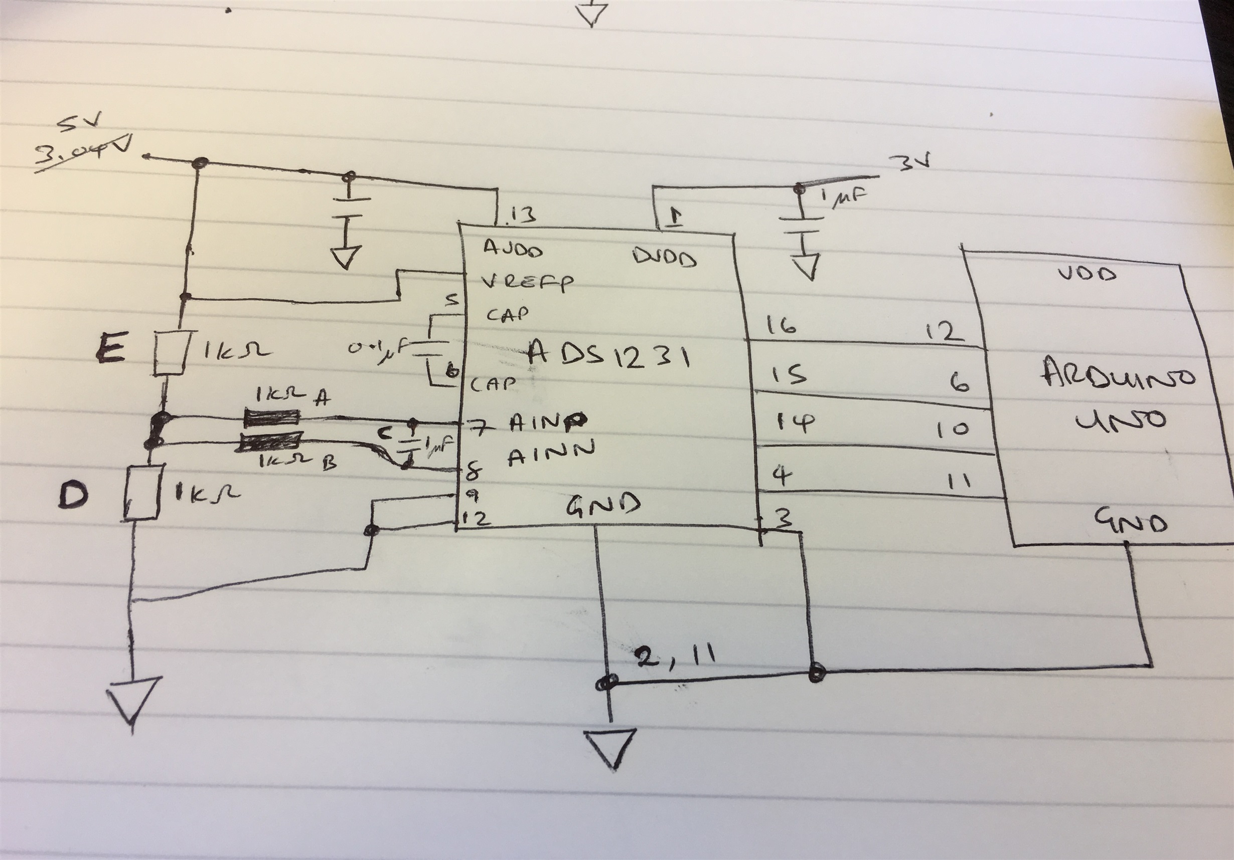

    2. "I would suggest simplifying the setup as much as possible.  Perhaps checking your noise first with a voltage divider at mid-AVDD and the inputs shorted to the mid-AVDD connection" I have attached my connection diagram could you please verify that this is okay? I will not be using resistors and cap labeled A,B&C for this simplification. so AINPP and AINN will be connected directly between resistor D&E
    3. I will be using a full bridge sensor (As described in the data sheet application instead of resistor D&E). Resistors A,B and Cap C will be connected to the inputs as shown on the diagram.
    Does this seem like what you have described?

    1. I am not sure I understand what you mean or how to go about it - " Make sure all supply connections are adequately bypassed at IC devices in your setup."[Bob B] These caps are the caps near the device supply pins.  So this looks ok in the drawing.
    2. "I would suggest simplifying the setup as much as possible.  Perhaps checking your noise first with a voltage divider at mid-AVDD and the inputs shorted to the mid-AVDD connection" I have attached my connection diagram could you please verify that this is okay? I will not be using resistors and cap labeled A,B&C for this simplification. so AINPP and AINN will be connected directly between resistor D&E [Bob B] I would suggest trying it both with and without the filter components to see if there is any noise pickup due to the filter.
    Does this seem like what you have described? [Bob B] Yes.  One other thing I should mention is the cap at pins 5 and 6 is extremely sensitive.  A high quality cap should be used and when breadboarding use very short leads.

    I have connected AVDD = DVDD = VREFP = VDD = 5V (using the same DC Power supply) and VREFN=SW=GND and connected the AINP and AINN to Mid AVDD as shown on my previous post. The results I get are negative but I am not sure why the negative offset? Ignoring that, I have attached the results below & If the calculations you showed me earlier are anything to go by then I am getting quite close to the full 17.4 bits noise free at 10 sps and 15.9 noise free bits @80 sps. (I get p-p 303 codes and 114 codes which are 17.16 and 15.76 noise free bits). If all this is okay, does that mean the noise is coming from the bridge sensor? since that is the only thing I have replaced or there is more to it than that?

    The result data does show a negative offset. but that is ok.  The ADS1231 datasheet states that the offset is typically 10uV.  This can be thousands of codes offset, so if you are seeing only a few hundred that is pretty good.  Also, when connecting and calibrating the sensor, the offset is easily removed.
    As far as the FFT, I didn't run through all the calculations, but I don't really believe what is shown.  Based on Nyquist, the bandwidth is 5Hz and 40Hz, or one half of the output data rate.
    Your noise is close to what to expect, so most likely the noise is being picked up at the sensor or within the cabling of the sensor.
