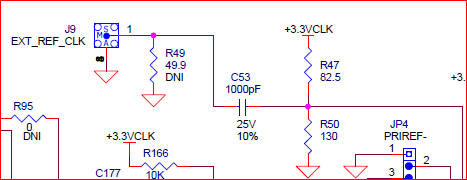

    1. External Clock to DAC3482EVM
    Currently the external clock to the DAC3482EVM is 25MHz sine, 0V to 1.3V.  Does it matter?  and how to adjust for this?
    I have the possibility of using another faster clock, but has 0V offset (goes +/-), but does the board have provision for this type of signal?

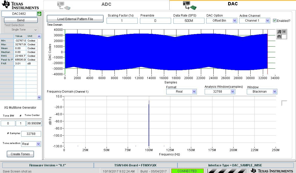

    4. The HSDCPro GUI shows I have a nice output (see below), but I see only noise on my 300MHz, 2.5GS/s scope (with only one scope input on) from any of the DAC3482EVM's 4 SMA outputs.  The DAC's GUI tab "Digital" "DAC Gain" and varying from 1 to 15 had no effect on either physical output or the HSDCPro GUI's min/max DAC codes (+/-32k is full scale).  I'm confused.

    You can send a reference clock with 0VDC offset since the EVM has provisions for this.

    The DAC3482EVM GUI comes with a few register settings, as you have seen, but this example is one that I created to show how the PLL can be used. Unfortunately, there is not a repository of files.
    If you made changes to the GUI files, I would recommend reinstalling the GUI to ensure factory settings have been restored.
    One extremely important item to note is that you must install and run (every time) the DAC3482EVM GUI as an administrator. I have noticed that it will not write to the registers reliably if you do not do this. This may be why you are not seeing an output.
