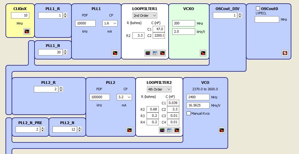

I have a customer having issues in getting the TSW4806EVM to produce a 100MHz clock. Here is the explanation that he gave:
I am doing everything I can to get the module generate a 300MHz and 100MHz clock using TSW4806 EVM board.
Instead, I got 303MHz and 101MHz, respectively and each clock has a fairly large jitter that varies from 298MHZ to 305MHz as a min. and max. repetitive rate.
Y2 VCXO is installed for PLL2.  Captured configuration used shown as below.
I have included a document which shows the setting that he is using.
TSW4806EVM Frequency Issue.docx
It almost sounds like this is unstable. Can you look at the setting and see if the customer is doing anything wrong?
Thanks for your help with this!
Richard Elmquist

  • Richard,
    I have a feeling the 200MHz VCXO the customer installed is drifting. They need to use the 10MHz input reference to get this VCXO locked at exactly 200MHz using PLL1 of the device.
    Jim

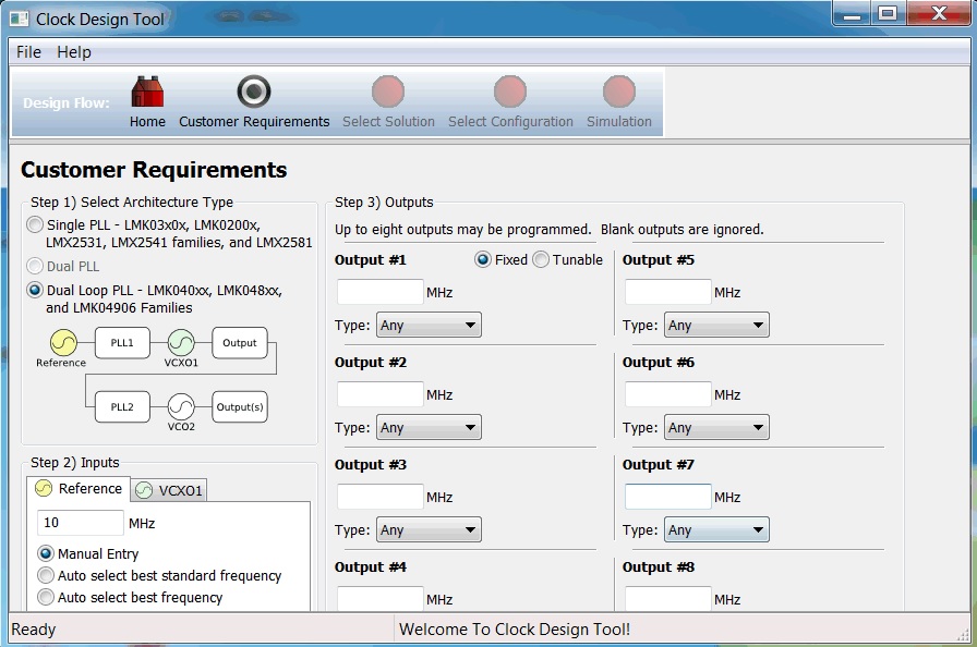

  • Hi Richard,
    Customer wants to use the device in PLL2 mode only and wants to generate the PLL settings with Clock design Tool, is my understanding correct?
    If that is the case then they can specify the same frequency in the "Reference" & "VCXO1" field. The tool will then generate the settings for PLL1 & PLL2. They can then just use the configuration for PLL2 and ignore the settings for PLL1.
    Best regards
    Puneet

  • Hi Richard
    If customer is trying to use the dual loop mode with VCXO, please ask them to share with me the registers setting they are programming. I think the PLL1 is not enabled correctly and is not locked. They can also use TICSpro tool to generate the register settings.
    If they want to use PLL2 only mode, then they can do what i said in my previous email.
    Best regards
    Puneet
  • Puneet,
    The customer is still having issues:
    I took your provided earlier suggestion by using an external 10MHz as an input.  I managed to have the PLL locked with the settings used as shown in figure1 below. These settings were derived from an example setting that came with the GUI installation and THIS SHOWED PLL LOCK (green LED "LOCK").  I also attached the setting_1111.txt for its register values used to configure the device (the settings below).

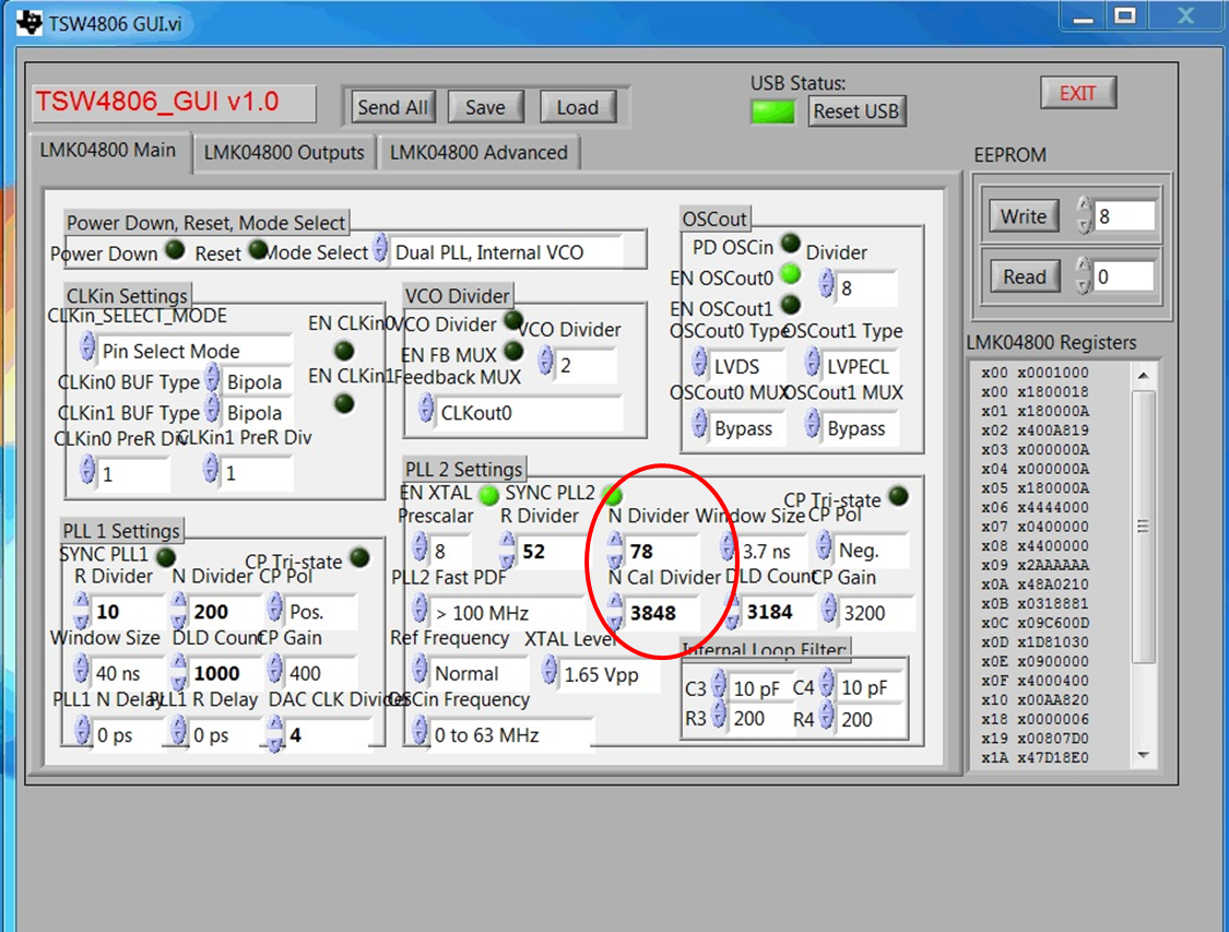

    The only issue with this configuration setting is that the frequencies generated are not exactly what I want (245.xxMHz and 102.xxMHz: vs. 240MHz and 100MHz on clkout0 and clkout11 respectively).
    My questions:
    1.  What change can I make to this setting to get exactly 240MHz and 100MHz.
    2.  Why does the figure 2 configuration not show PLL "LOCK"? I am getting 266xxMHz and 111xxMHz, instead.
    I have attached a document which references the figure mentioned in the customer's response.

  • Hi Richard
    Yes, i looked at the settings and i saw following issues:
    Setting 1: PLL1 N Divider should be 1920 ten PLL1 should lock. PLL2 settings are wrong. This will not give you 2400MH from 200MHz input.
    Settings 2: N Divider & N Cal Divider should be same (78 in this case).
    These are also not good settings for PLLs for performance.
    Please use the settings like in the snapshot below:
    Let me know if you still see any issue.
    Best regards

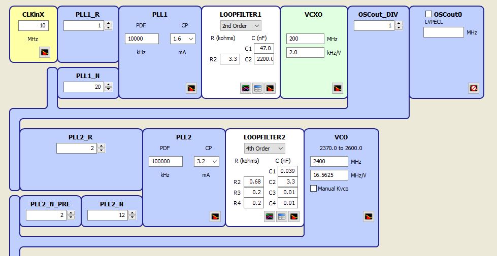

  • Puneet,
    The customer is still having issues.
    Please look at the attached document as it shows the issue that they are still seeing.
    TSW4806_TI_OLYMPUS_LMK_EXCHANGE_rev1_11_13_17.docx
    Please let me know if you have any further questions from the customer as it seems that the settings are not working properly. Could they have a problem with the board?
    Richard Elmquist
  • Hi Richard,
    "Clock Design Tool" is a simulation tool for PLL loop parameters.
    After used it, we should use "TICS Pro", input setting according to previous simulation result.
    TICS PRo could generates registers map. It also could find similar settings in "TSW4806EVM GUI".
    Then you could get a correct setting.
    I found some problems in your application.
    1, OSCin frequency range setting should match 200 MHz.
    2, 3.3V LVCMOS is over spec. for LMK04806 VOSCin range 0.2~2.4Vpp.
    3, PLL dividers are wrong, PLL2 is unlock.
    4, 300 MHz LVCMOS is not supported by LMK04806.
    OSCin_200M_OUT0_1_100M_OUT2_3_300 MHz.zip
    Try attached setting, the .txt file could be loaded by TSW4806 GUI.
    If necessary, external loop filter RC also need to be changed on board.
    Shawn
