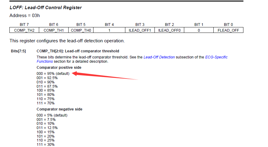

When using ADS1291, I have the following questions:
1.  What is the value of 95% in the red arrow in the figure below? Which 95% of the value?

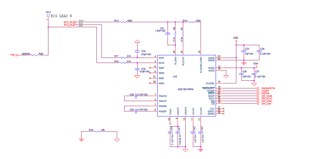

2.I can now collect the ECG signal of the ECG simulator. There is a QRS wave, but I can't acquire the ECG signal on the arm. When I collect the ECG signal from the human body,
what are the major parameters to adjust? The schematic is as follows:
    The settings listed in the LOFF[7:5] bits are the threshold voltages given as a percentage of the supply voltage (AVDD - AVSS) with respect to AVSS. For example, 95% for bipolar 5-V supply (+/- 2.5 V) would set the positive threshold at 0.95 * 5 V + (-2.5 V) = 2.25 V.
    There are many possible answers to this. First, I would substitute a real ECG input with a function generator. This will provide a controlled, consistent signal source as you evaluate and adjust your design. Most likely, the high electrode impedance is attenuating the smaller portion of the ECG waveform such that it disappears below the noise floor.
    I don't see anything immediately wrong with your schematic. Try to adjust the gain and data rate settings to maximize the noise performance and dynamic range of the ADC.
