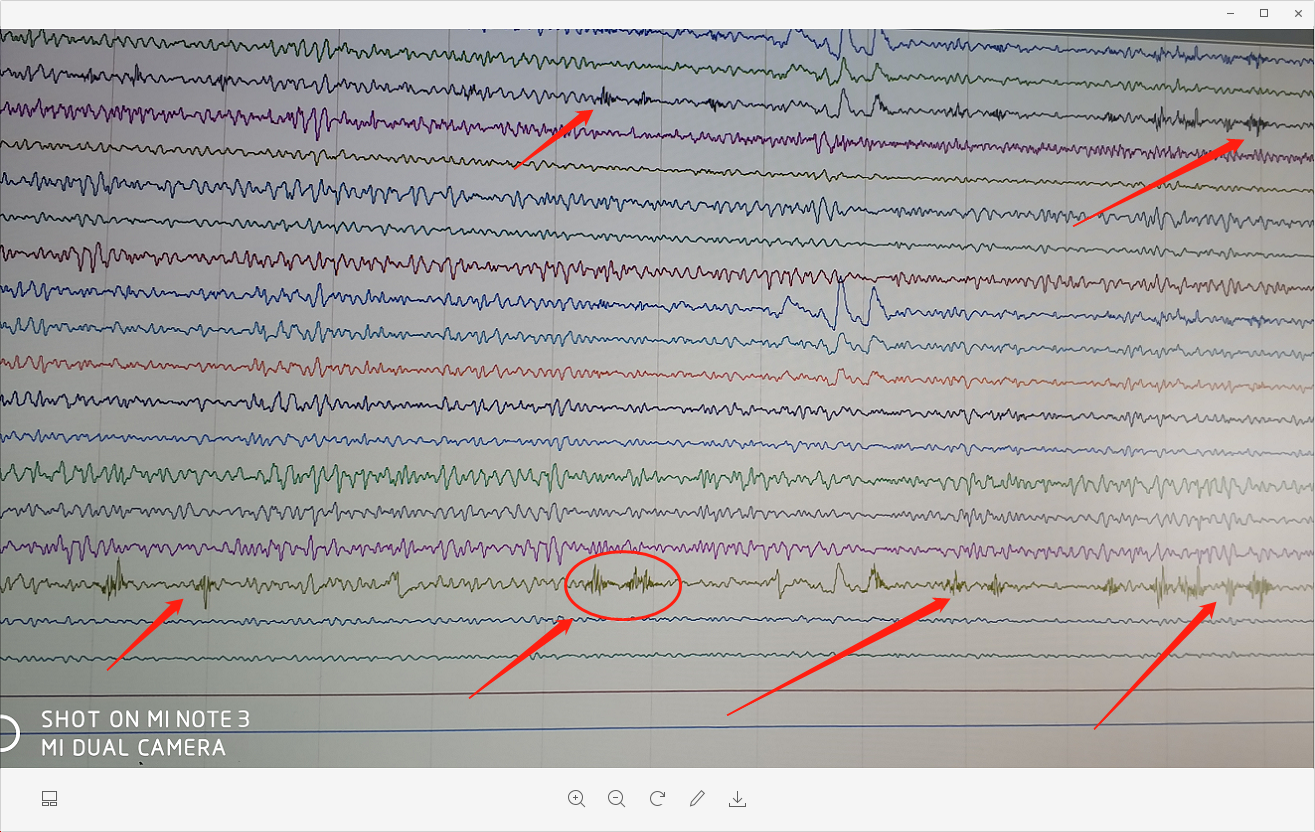

Our team used ads1299 to do EEG measuring about 2 years.
we have many difficulties. our system is a 24-channl EEG. We found our PC software show some bad wave like the following figure.
we use the montage in datasheet Figure 73.and Filter set  Digital Bandpass =1Hz-70Hz   Wave Limiter=50Hz。RC= 4.99K and 4.7nf ,bias RC=1M and 1.5nf
So, how can we do to make our sys better. This problem will be Make doctors makeWRONG judgments .
Help. I need help from your from TI.

    Where are these signals coming from? A patient or a generator?
    Have you verified that it is not a problem with the source?
    What makes the signal measurements bad or wrong?
    Can you provide a schematic?

    As you said. We have tried to find the problem.
    When we do the input impedance test, Similar situation we found.
    We add a RC model bettwen our system and sin single generator.
    R = 620K . C=47nF.
    This test is used to measure the input impedance.
    We are very surprised at our test results.This value is about 10M(No lead-off).
    This is much smaller than the value provided in the datasheet(min=1000M).
    So We don't know what is wrong we did?
    We want to konw how do you get the value(1000M), What instrument is used,and how?
