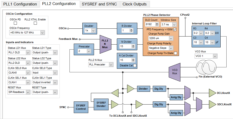

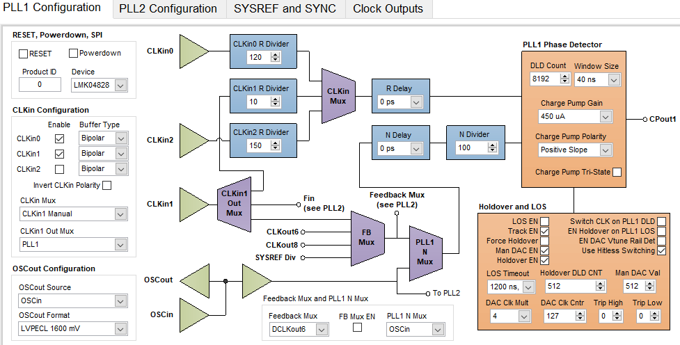

Below is the PLL1 configuration
I am using the on board VCXO. Do I need to update any other parameters for LMK04828?

  • Yogitha,
    In the box labeled as "PLL1 N Mux" (in the bottom of the GUI), change the setting to "Feedback". In the "Holdover and LOS" box, disable "Use Hitless Switching". Make sure jumper JP5 has the shunt installed between pins 1-2 and JP2 has a shunt between pins 1-2.
    Jim

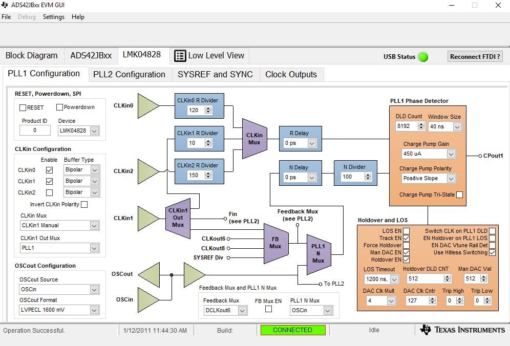

    Below are the configuration settings
    Yogitha

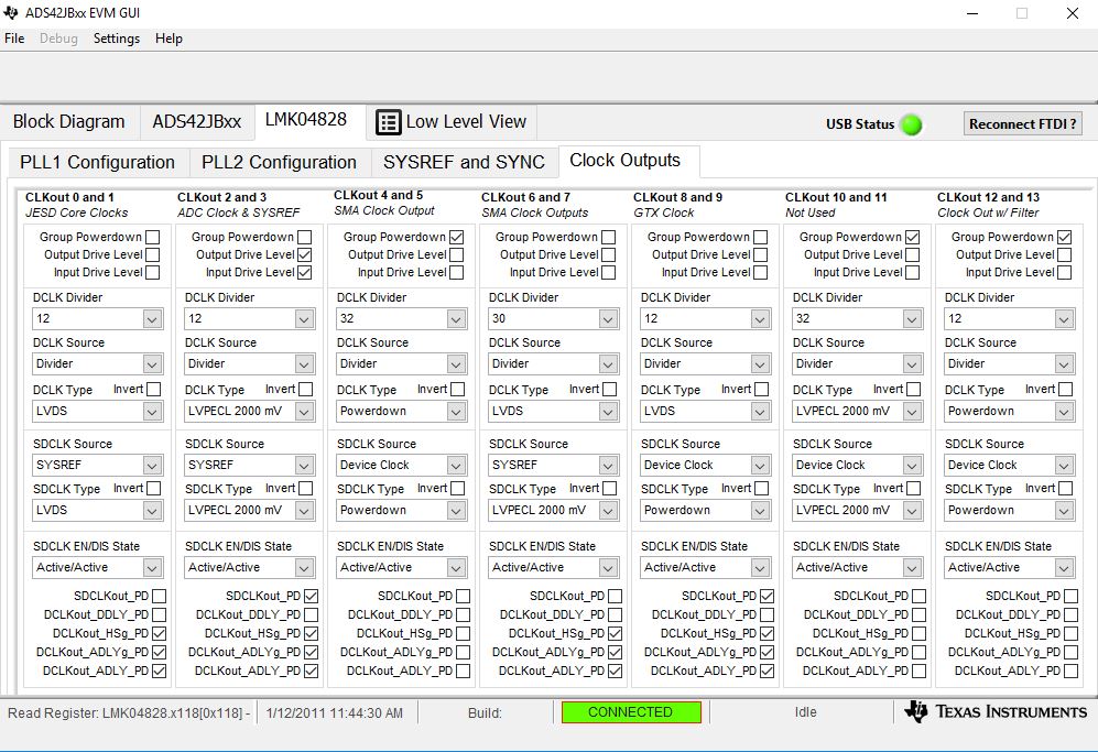

  • Yogitha,

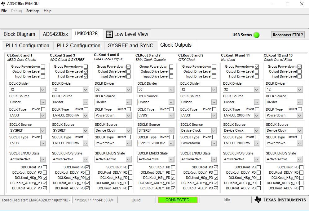

    You did not answer my question regarding the 10MHz oscillator. This board has both an 100MHz VCXO and an 10MHz oscillator. Do you see 10MHz on R19 when using an oscilloscope? The 10MHz is only used to lock the 100MHz VCO to this 10MHz. It is not required for the LMK to operate properly.
    Here is another test to try;
    1. Power up the board, press the ADC reset switch, then load the conf file called "ADS42JB69_EVM_LMF421_250M.cfg".
    2. Click on the LMK04828 tab, then the Clock outputs tab.
    3. Uncheck the "Group powerdown for CLKout 6 and 7.
    4. Change the DCLK Type for CLKout 6 to "LVPECL 2000mv". Change the DCLK divider for this output to 30.
    5. You should now see 100MHz on SMA J10. If not, I think you may need to get a replacement board.
    Jim
  • Hi Jim,
    I generated a 100Mhz clock on SMA J10 and connected it to KC705. Through signal tap I could see a decent clock on the FPGA port. I will confirm the clock quality using the oscilloscope. I will also confirm the 10MHz clock on R19  soon.

  • Hi Jim,

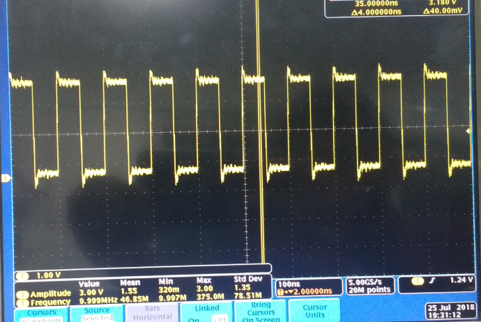

    I have checked the R19 installed on back of the board. I could see 10MHz clock on both sides of the resistor. I have followed the steps you have mentioned to generate 100MHz clock on ClockOut6. I see a ~248Mhz clock instead of 100. For whatever divider value I set for the clock, it always generates 248MHz clcok.
    Below are the oscilloscope snapshots.
    Clock on both sides of R19
    DclockOut6 with divider set to 30
    Yogitha

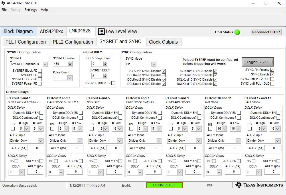

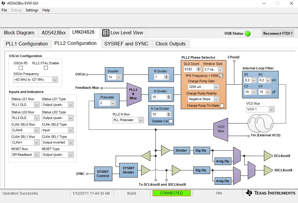

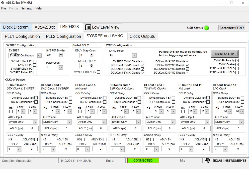

  • Yogitha,
    In the GUI, there is a LMK04828 tab. Click on this then send me screen shots of every tab under this one. Then send the register settings for the ADC and LMK that you are using by going to the Low Level View and clicking on "Save Config".  While in the Low Level View tab, did you verify you can write and read properly to the registers in both parts?
    Jim
  • config_file.cfgHi Jim,
    Please find the screenshots below
    I was able to verify the Register read and writes through GUI.
    Yogitha
  • Yogitha,
    Everything looks fine as far as I can tell. You may just have a bad board. See the link below regarding EVM exchange/returns.
