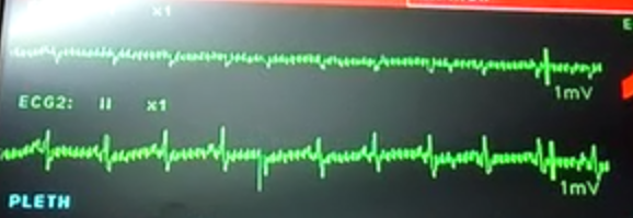

  We are using ADS1298 board in our Patient monitoring product.
Normally in battery condition, the wave-forms are perfect.
whenever try to connected power cord to unit total ECG wave-forms are collapsed.
Kindly suggest how to reduce this type of interference by using internal filter or protection ,otherwise we have to implement any digital filters.

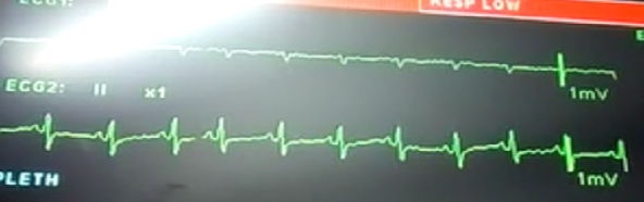

      That is related with cautery noise issue it seems. Here we have power line interferrence noise issue without cautery diathermy device. Shall we continue with this threat?
    Kindly help us with this issue
    This image is 3 pin power cord connected
    This image is 2 pin power cord connected
    Guna
  • Hi Guna,
    Thank you for the clarification.
    A 2 pin power cord does not have a ground connection. The noise appears to be caused by the system not having sufficient connections to ground.
    Can you provide a schematic? If you are not comfortable posting the schematic online, with your permission I can contact you through email.

  • Hi Guna,
    I hope you are well.
    I agree with Brian that the schematic looks good.
    The signal improves significantly with the addition of a ground connection from the power cord. When the cautery device is used there is significant interference that appears to be introducing itself into the signal path instead of being passed to ground properly.
    Due to these two reasons I believe these issues are caused by a deficiency in how the system itself is grounded. This could be due to board layout or system construction. To debug this issue I recommend adding robust ground connections at various points throughout the system and see if there is an improvement. If you post your layout and/or provide any information on the system grounding I can suggest some points to test.
    Signal isolation could be an issue as well, but that would require a more intensive board re-design.
