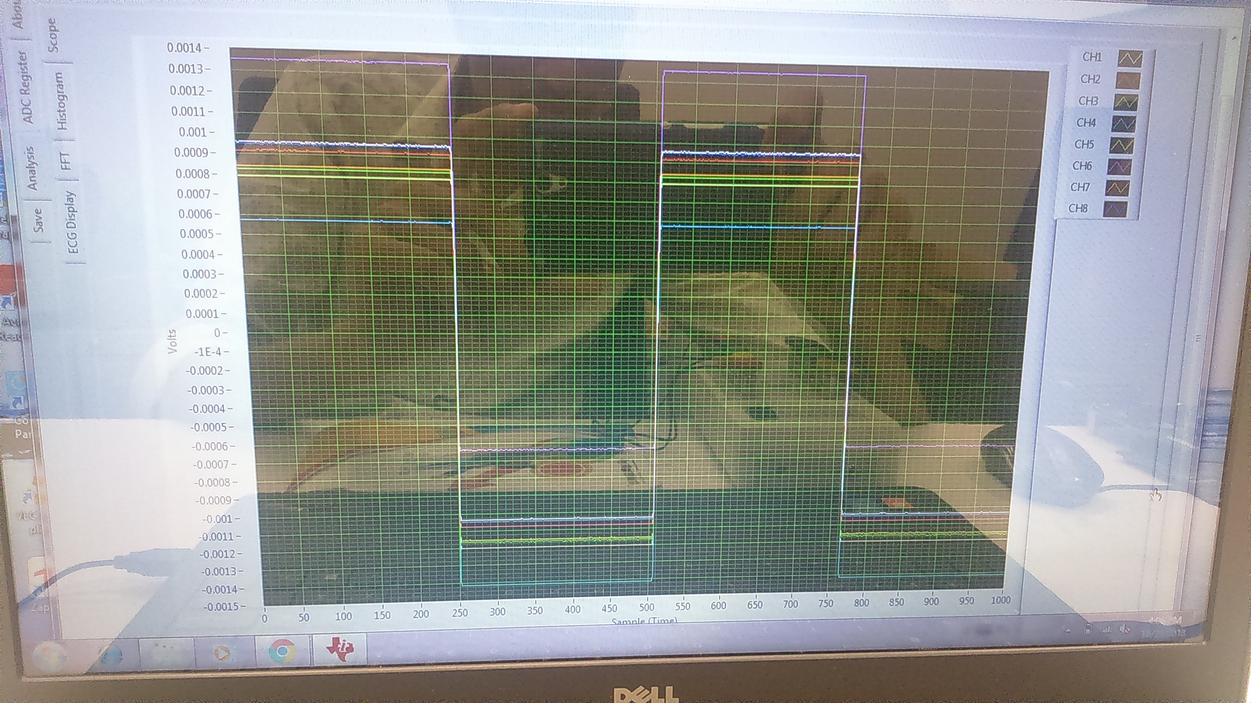

  • Hello sir
    When i connects ADS 1298 board with Host MMB0 board and try to check ECG signal on TI software then obtain the results look like below i attached picture.I used ECG simulator to get signals.
    and when i remove ECG simulator then also get same signal on ECG display(software).
    what is the reason behind it?
    Is my ads 1298 ic is damaged?
    Picture - with ECG simulator signal on s/w.
  • Hi Sagar,
    This looks like the internal test signal, and that would explain why there is no difference when the ECG simulator is connected.
    You can probe the VCAP pins to check your IC: e2e.ti.com/.../2677107
