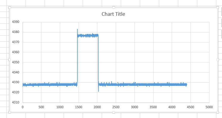

    I resolved the problem regarding calibration. Apparently in my case since the frequency is very low (cutoff at 60Hz) there is no need to take care of frequency dependent nonidealities (INL for example).  I calibrated however for static nonidealities.
    I have now a new problem that deserves some explanation and correction. I would like now to digitally compensate for signal degradation in low frequency range. You may look in the attach where square waves are recorded in time domain and as can be seen there are certain overshoots that don't exist in the original square wave signal (It is 15mV signal, sampled at 250S/s). My opinion is that my analog signal chain introduced this because of the nonlinear behaviour at low frequencies. I can't change the hardware so software intervention should be performed. Also I attached application note from TI where similar problem with square waves was discussed(TI app. note). I would need some help to improve on this.
    I wish you all Happy New 2019.
    We're going to need need a little more information about what you're doing to continue effectively supporting this thread. What ADC are you using and can you share the schematic of the analog front-end? I agree with your assessment that the overshoot is likely coming from overshoot in the AFE as a result of an under-damped system. Since you are not able to modify your AFE, other than the techniques described in the attached app note I'm not sure what you'll be able to do about the overshoot other than try to "blank" it out if you know it's coming.
