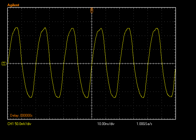

    What characteristics should have a LVCMOS clock signal from FPGA?
    I tried to clock the ADS5282 using a 2.5Vpp 50MHZ clock from the FPGA with no success....
    Attached is the output clock in an oscilloscope...

  • Hello Matt,
    I measured the voltage level in clock input and find it 0.4Vpp.
    How this can happen as before connect it to J26 clock input i measured it and find it 2.5Vpp?

  • Hello Matt,
    0.4Vpp is single-ended measured on JP3(2) pin. The outut from FPGA pin is 2.5Vpp as mentioned above. In JP4 and JP5 i  measure 0.2 Vpp differential.
    What is between J26 and JP3 that cause this voltage drop? I have no impendance on the line....

  • Lefteris,
    If I'm looking at the correct point (page 10, header on right side, pin 8) it appears that there is a 200ohm resistor in the path from the FPGA to the ADC board. That resistor is going to form a voltage divider with the 50 ohm input resistance of the ADC board. 2.5 * ( 50 / (200+50) )  = 500mV. If you measure the output of the FPGA before hooking it up to the board, then yes you would see 2.5V, but once the 50ohm load of the ADC is present, this would limit the voltage at the board.  I would suggest removing this resistor (R96) and see if that fixes your problem.
    Matt Guibord
