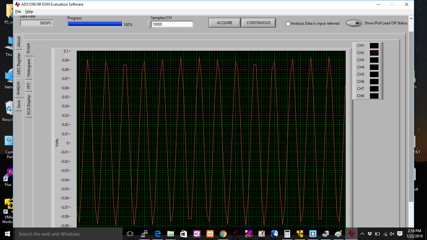

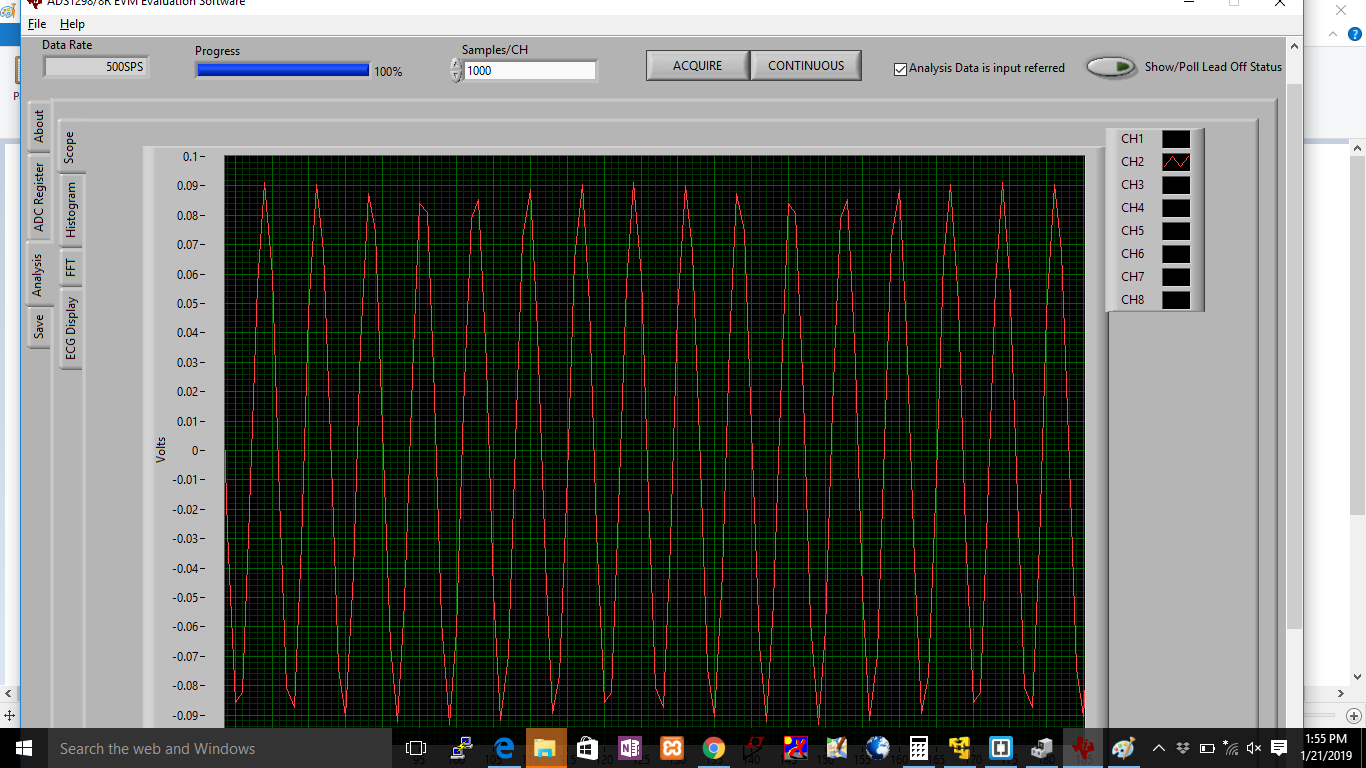

we were able to set up the EVM to receive the signals. we gave a signal of 100mVpp to channel 2(+ 50mV) of the device, it is receiving the signal and is being shown in the scope with a gain of 2. But when we change
the programmable gain(PGA) setting from control registers, the result remains the same i.e. no change in the output signal in the scope.
Kindly clarify the issue, i.e. how to change the gain and view the update result on scope.

    Try unchecking "Analysis Data is input referred" in the scope analysis window.
    If you're measuring signals centered around GND, make sure that you're running the device using the bipolar power supply configuration.

    1. Differential input of 100mVpp sinewave was given to channel 2(+ 50mV) of the device, but the output seen on scope is not pure sine even though we used 10000 samples/ch.

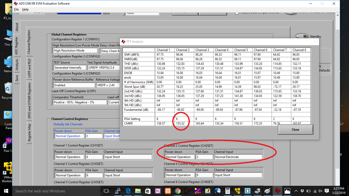

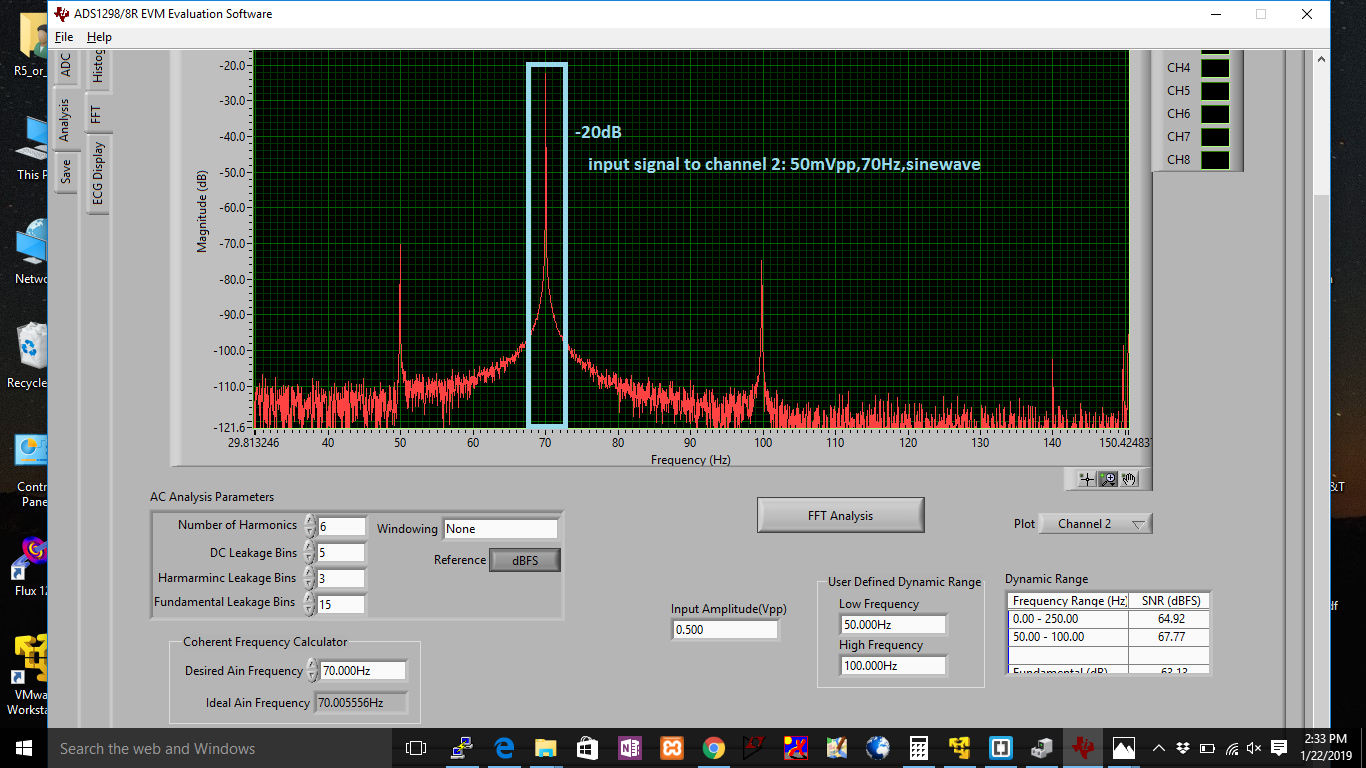

    2. FFT analysis shows magnitude plot, the gain showed here doesnt match the gain set from the GUI.for eg we set gain of 2 but magnitude plot gain is -10dB.One more thing also when opened FFT analysis window PGA gain setting showing is always 1 in fig.2.

    1. You need to change the sampling rate under the OSR in the registers tab. Changing the samples/ch just means that it performs the measurement for a longer time.

  • Please explain point 2 in the above querry regarding FFT analysis related doubts . we attached the screenshot with highlighted ones.
  • Hi Vasanth,
    Sorry about that, I should not have used the acronym "OSR" which stands for "Oversampling Ratio". Might have been confusing.
    Try adjusting this ratio and let me know if it fixes both problems. This is important for the FFT as well, please see figure 52. of the datasheet for additional details.
