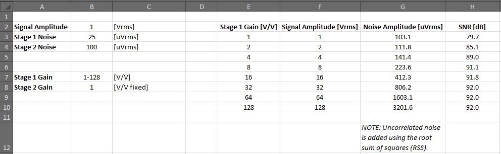

  • Hi Mario,
    If you use the INA in front of the ADC with a gain of 100 V/V, you will be adding the INA's noise to your signal and gaining up this noise by 100. Notice that the input signal and the INA noise will both be gained up by the same amount; therefore, the signal-to-noise (or resolution) is already limited just by the choice of amplifier and not by the ADC.
    NOTE: The benefit of using gain ONLY comes from the case where you have multiple active stages in your circuit and first stage has lower noise (and higher gain) than the second active stage in your system. In this case you can gain up the signal and the noise of the first, while keeping the noise of the second stage constant. The net effect is that the signal is amplified more so than the overall noise. However, as soon as the gain increases to the point of causing the amplified noise of the first stage to exceed the noise of the (non-amplified) second stage then the signal-to-noise ratio no longer shows any significant improvements. Here is a numerical example, notice that above a gain of 32 V/V the SNR no longer increases with additional gain.
    Here is the Excel file you can reference to see the computations: SNR-Example.xlsx
    The ADS1262's internal amplifier is a very low noise amplifier, the noise spectral density is around 7 nVrms / sqrt[Hz]. Compare this to the INA125's noise spectral density of 38 nVrms / sqrt[Hz]. Even though you can only achieve a gain of 32 V/V, you will still get better resolution with the ADS1262. Besides, you'll also save on the cost, PCB area, and improved accuracy (lower system offset and gain error) by removing the INA125.

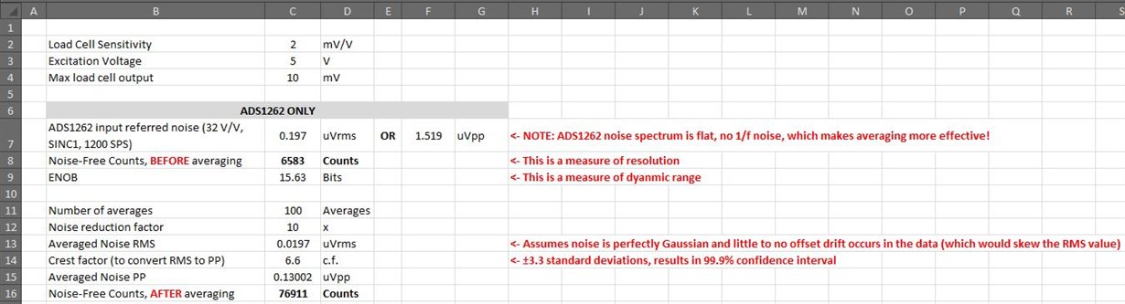

  • Hi Mario,
    Sorry for the delayed response.
    You are correct that not utilizing the full input range of the ADC will reduce the ENOB; however, keep in mind that ENOB is a measure of "dynamic range" (calculated as the ratio of the full-scale input voltage to the input-referred noise).  "Resolution" on the other hand is limited by the input-referred noise, and while gaining up a signal will improve the ADC's input range-utilization, it does not necessarily improve the input-referred noise of the system.
    Here are my calculations for what you could achieve using the ADS1262 by itself (plus the performance after post-process averaging):
    Source File: ADS1262-Load-Cell-Resolution.xlsx
    Going through these same calculations with the INA125 + ADS1262 is a lot more complicated but there are a few things to be aware of...
    • The INA125 noise is much much higher than the ADS1262 PGA noise, so input-referred noise will be much higher and resolution will be worse, even with the higher gains. All you have to do is compare your 10mV input voltage to the input-referred noise of the complete system to see what kind of resolution you can achieve (this is not too bad to compute when the ADC + PGA are integrated, with multiple ICs there is a lot more math involved).
    • The INA125 noise is not flat, as it is with the ADS1262. Rather the INA125 has a significant 1/f contribution (which also gets amplified by the INA's gain). 1/f noise is not Gaussian, so averaging 100 samples with this type of noise will not result in the same 10x noise reduction that I showed above. This another reason that I would point to for discouraging the use of an external amplifier circuit, unless you can find something with lower noise and no 1/f noise! In my search for such a device, the OPA388 comes the closest to such a thing but it is not the best op-amp for driving ADC inputs directly, so you'd still need to enable the ADS1262's internal buffer which adds to the noise.
