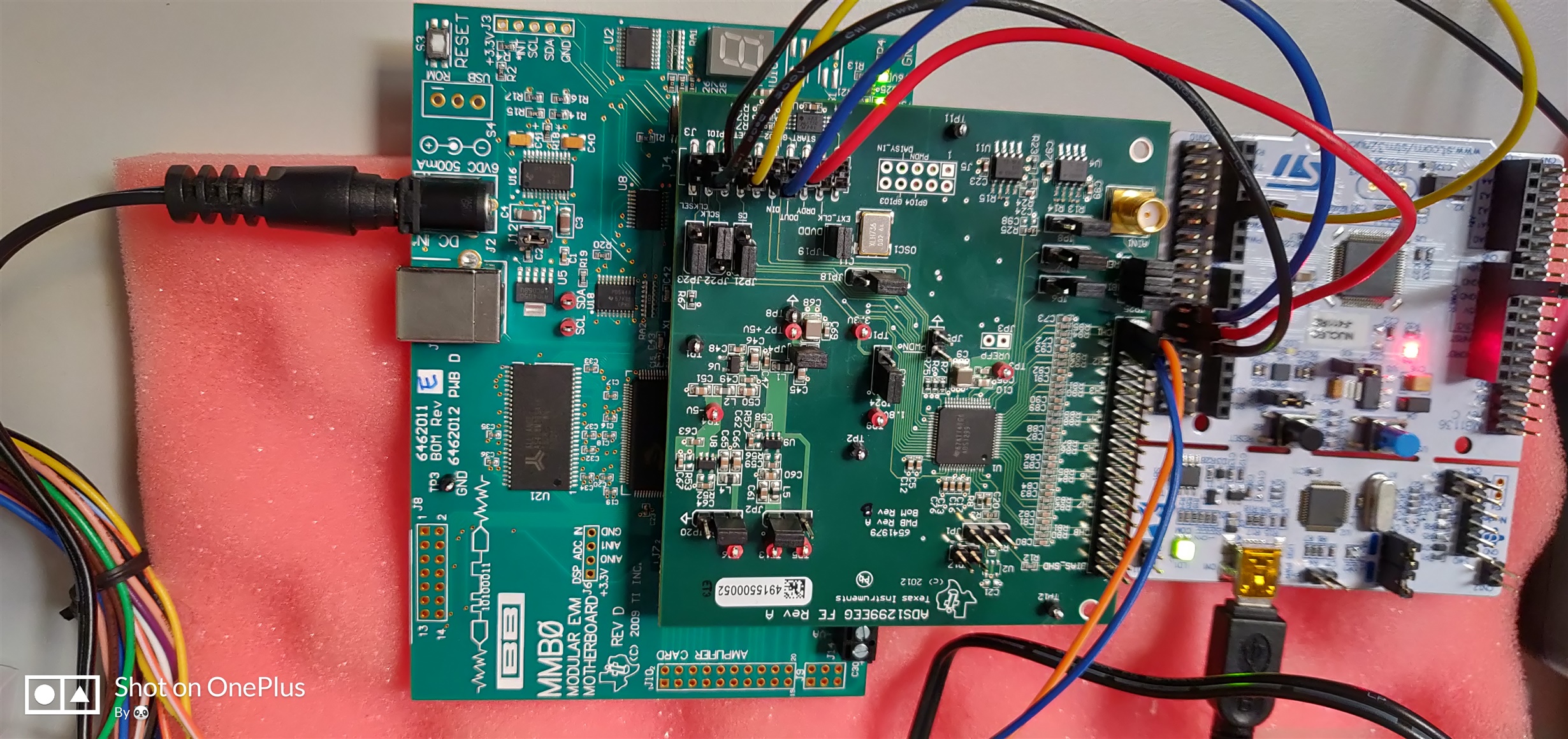

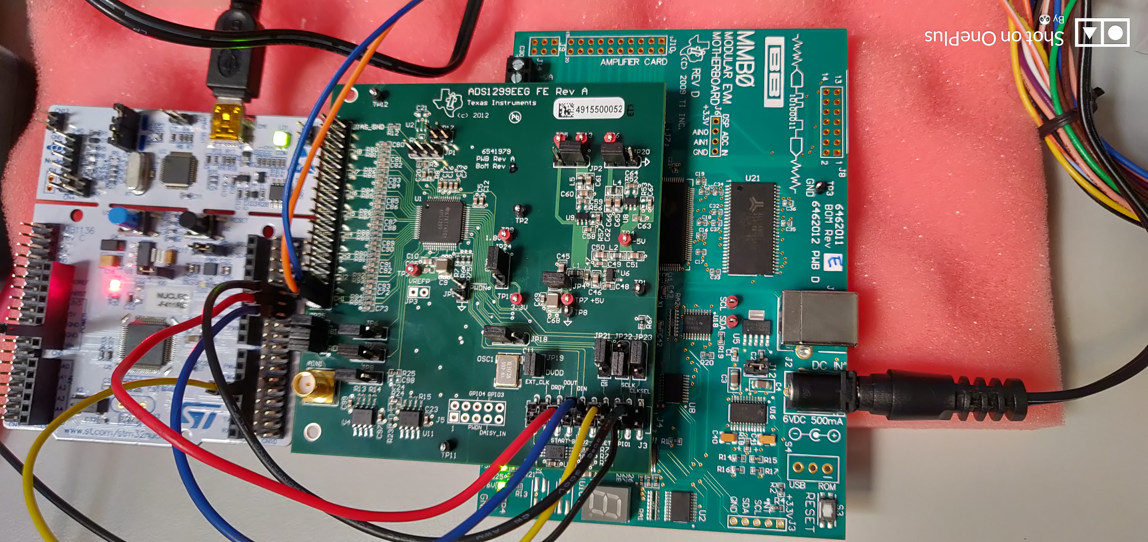

    I'm powering the ADS board through MMB0 board without using the ADS software.
    Do I have to power it in some other ways?
    I post a picture below to show the HW setup.

    You should be fine powering through the MMB0, but to confirm you can probe the power pins to ensure that the device is receiving power.

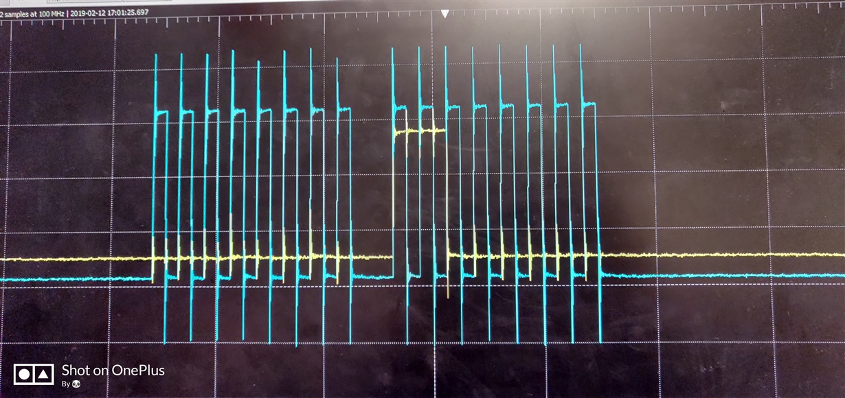

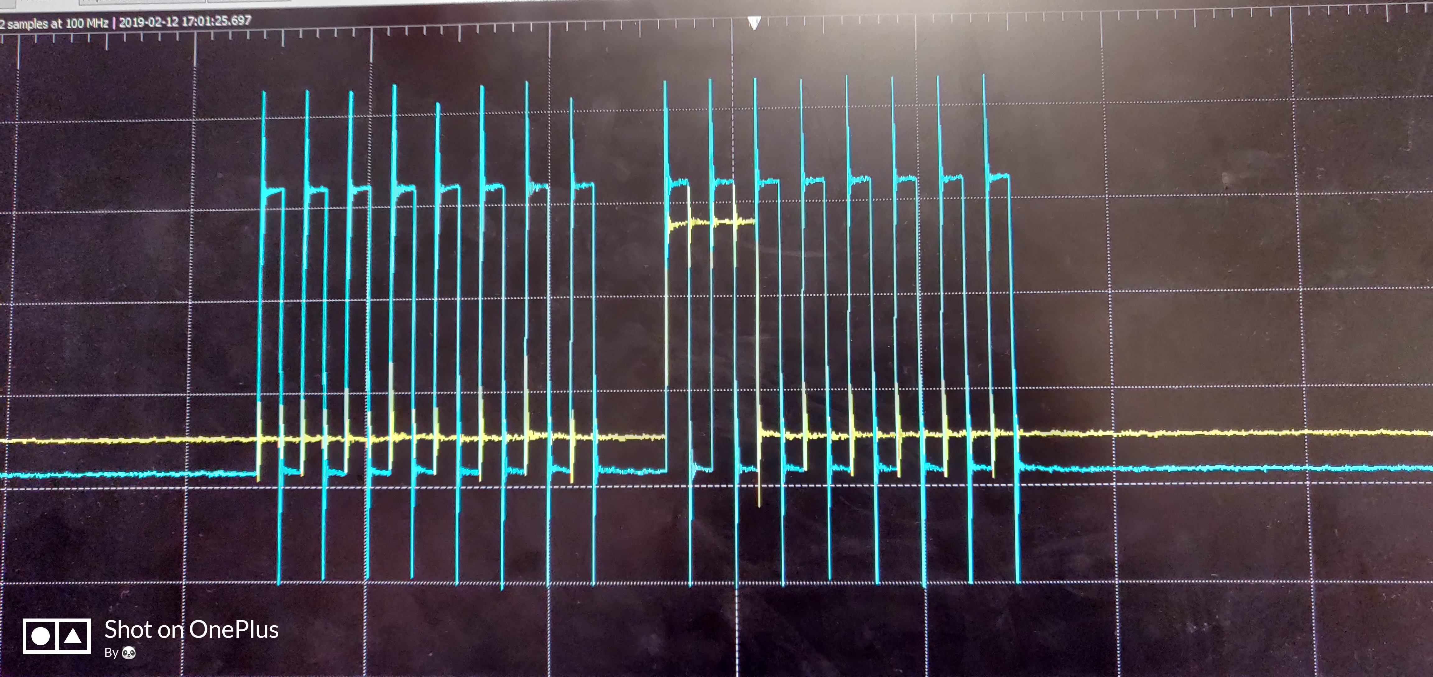

  •  The above picture the blue line refers to SCLK and yellow DOUT, the DRDY  is always high isn't toggling.

    You have a high over/undershoot on your SCLK. Check to make sure that this over/undershoot is within the guidelines of the datasheet for digital communication. If the over/undershoot is out of specification then the device may not read the pulses properly.
    Additionally, check to make sure that the pin monitoring DRDY is not reserved/held in a constant high state by the MCU.
