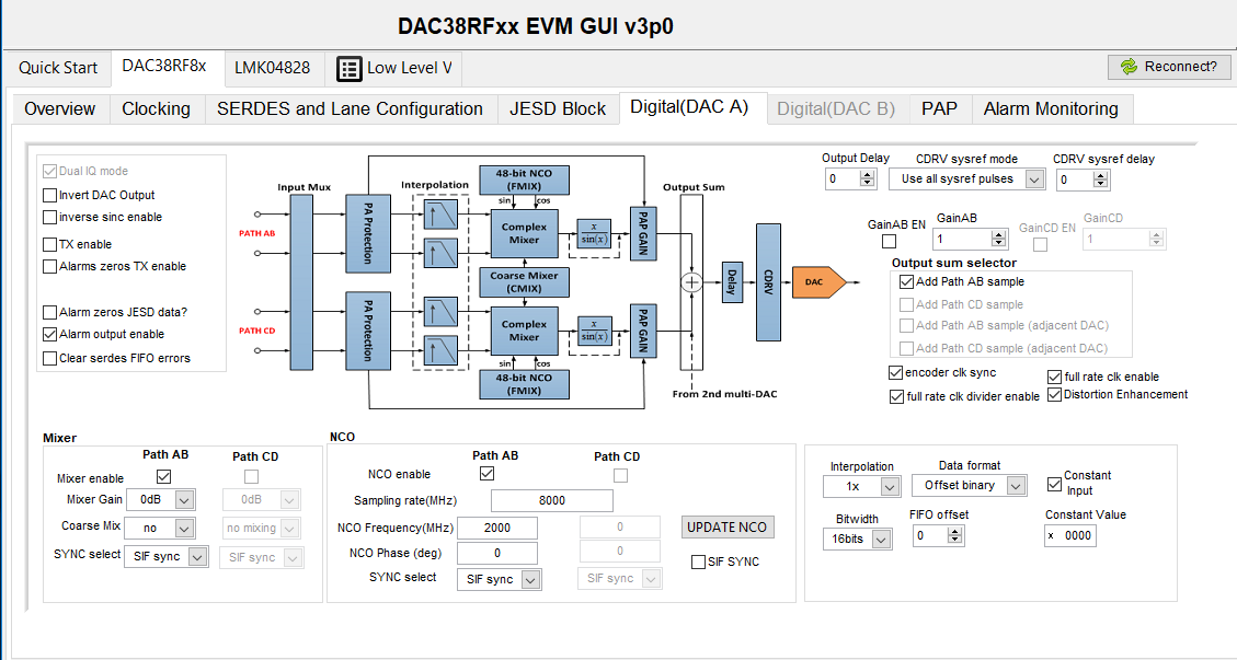

    This should not be an issue. When you try this test, are using the constant input mode and the data format set to Offset binary? Is the mixer enabled and coarse mixer disabled? Please send your register settings and we will take a look at them. Can you verify the clock going to the DAC is the correct frequency? I am wondering if you have a setting wrong with the LMX when you go above the default value. You may also want to consult wit the high speed clock group about setting the LMX registers properly.
    Jim
  • Jim,
    Yeah I have Constant Input, Offset Binary, the Mixer Enabled, and NCO Enabled all checked on. Here is a screenshot of my settings:
    Yeah I've been able to definitely verify that the clock is at the right frequency (I've been trying 8000 MHz). My biggest worry would be with the power output of the clock as I don't currently have an adequate way of measuring it, but based off the datasheet, I believe the power output should be sufficient.

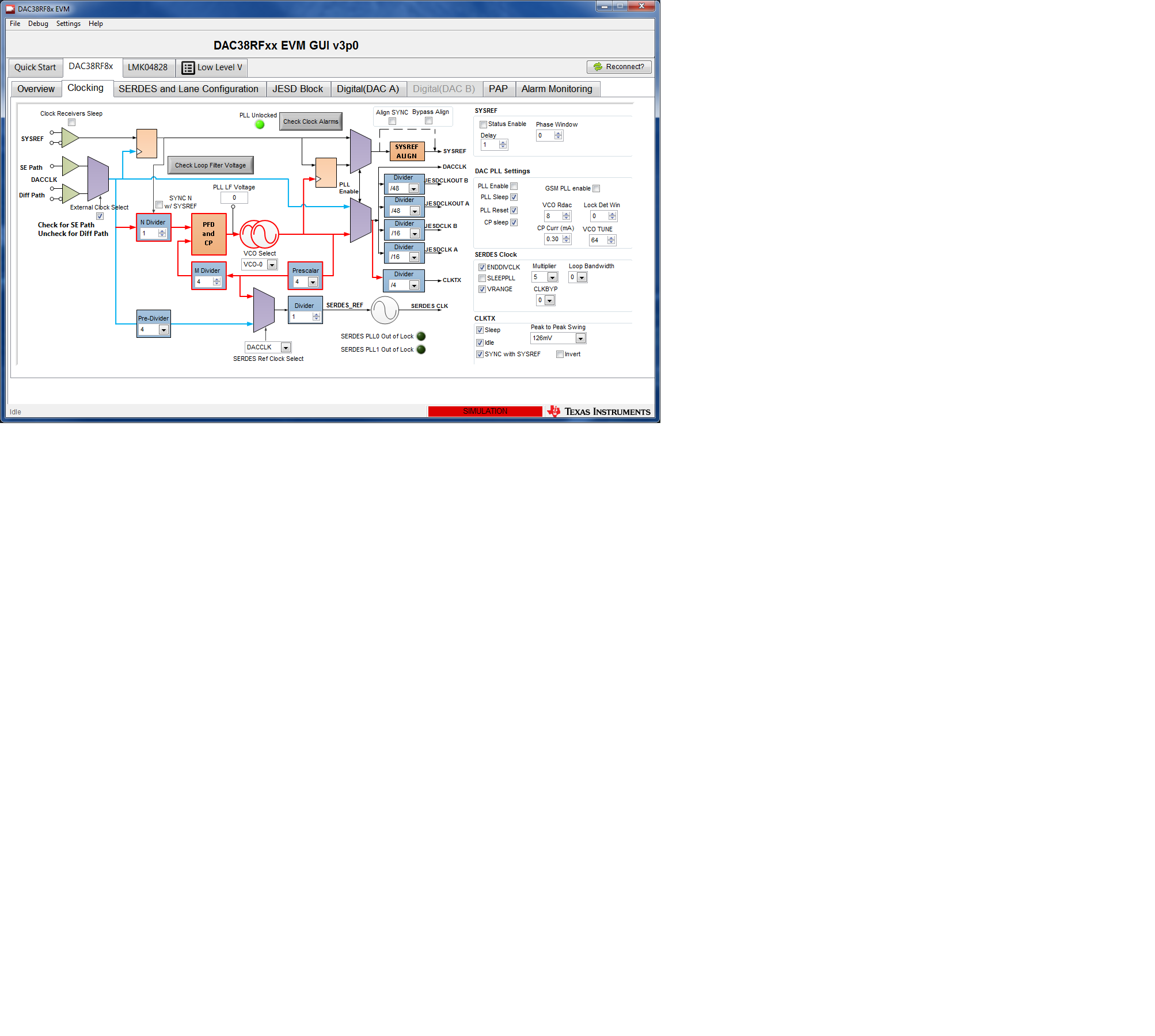

    Do you have the single-ended clock option checked as shown below? How much current can your 5V supply provide to the EVM?
    Jim
  • Did you click on "UPDATE NCO" after making all of the changes?
  • I've unchecked the single clock option so that the DAC is configured for a differential clock, I've been sure to click UPDATE NCO after making changes, and the DC power supply we are using is rated from 0-3 A and I haven't seen the current limit LED flash so I don't think it's a current issue.
