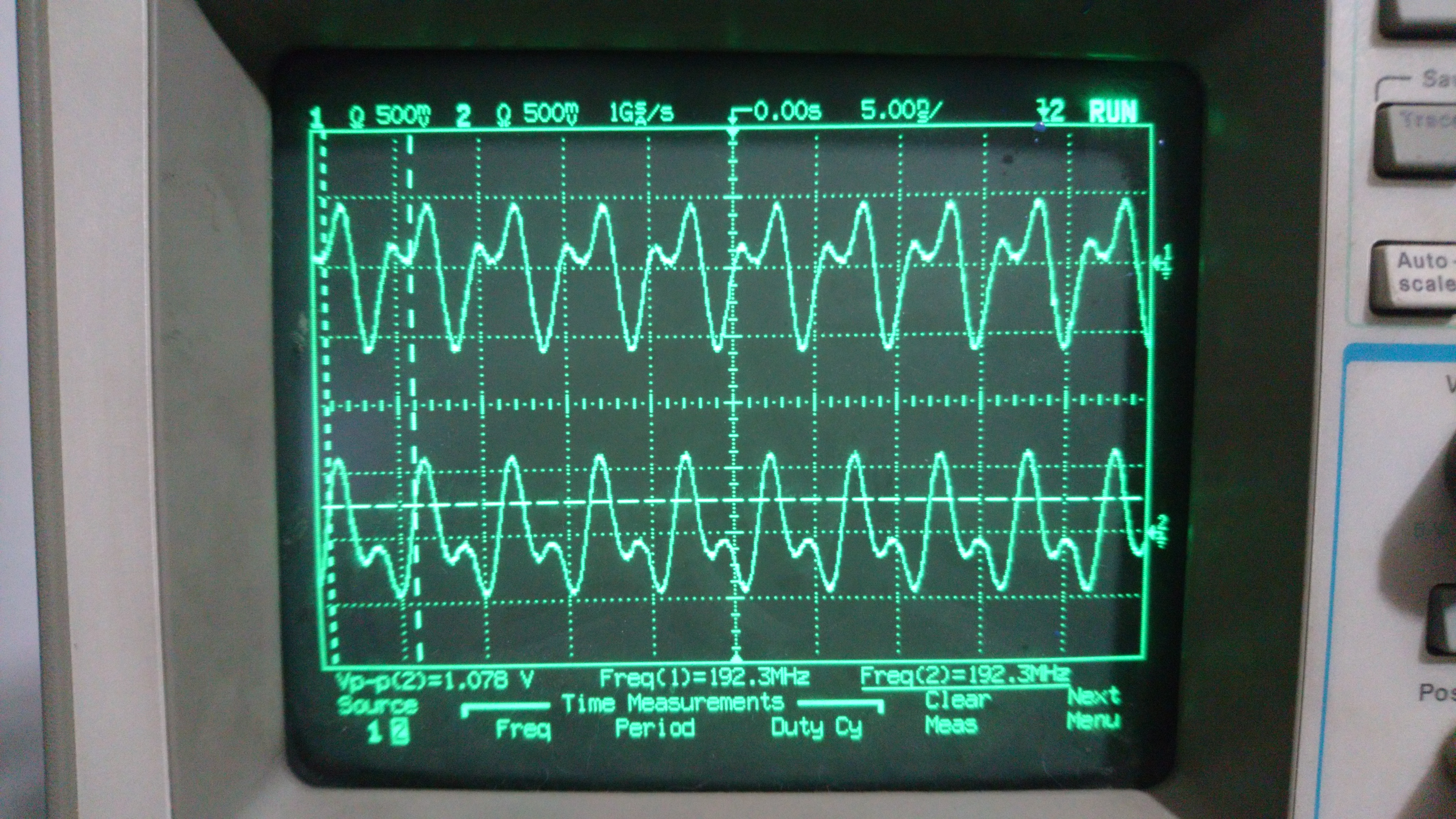

When I configure HSDCP to generate a 200 Mhz, I see on the scope a sinewave signal that looks good, only it's 192 Mhz, not 200.
The lower I go from 200, the more distorted 192 Mhz wave I get.
I configured DAC B to use constant input with NCO at 48 Mhz and mixer so we can easily see the signal on the scope and compare.
The following is a snapshot of me trying a 48Mhz sine on channel A, and a 48 Mhz sine generated by NCO and mixer on channel B.
The following is me trying to generate a 150 Mhz sine on DAC A, and DAC B generated 48 Mhz as above:

    2)  Here's a snapshot of HSDCP:
    Here's a picture of what I see on the scope (Channel 1 is connected to J6 - IOUTA , Channel 2 is J2 - IOUTB-SE ):

    My understanding of the current problem is the following:
    1. output higher frequencies tones (even with test tones) is limited to 192MHz
    2. the 192MHz has distortions in the time domain.
    Please confirm if my understanding is correct.
    I see that you have set HSDC PRO to output 300MHz, for instance, with data rate at 768MSPS. There are multiple interpolation stages happening in the DAC upconversion circuits. The initial interpolation by 2 circuit has roll-off bandwidht of roughly 80% of the data rate. With 768MSPS, the maximum I/Q complex bandwidth is 384MSPS. Since the DAC38RF82 is a real signal upconversion, we will have only 384MSPS of bandwidth. With 80% roll-off, you get 307.2MHz as the maximum. You are close to the edge of the roll-off, and it is possible some images during the interpolation process may leak into the main Nyquist zone. This may explain that the waveform changes as you reduce the output frequency.
    I recommend to observe the output in a spectrum analyzer with sufficient RF range to observe the output. The current time domain plot may have bandwidth limitations from your scope. The output of 192MHz may be combinations of the output and also its associated aliasing components, hence the additional distortion.
