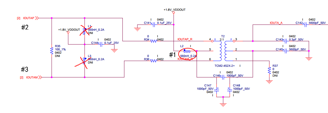

              I find some problem with my hardware,  The schematic diagram is shown below:
    1. IOUTAP(#2) and IOUTAM(#3) are not get the Voltage  1.8V_VDDOUT for the Welding problem of #1  inductor.
    2. We rewelded the  #1 inductor,Fusefarm Autoload sequence is set done of 0x7F register.
    my question: what is the reason of  IOUTAP(#2) and IOUTAM(#3) affect the Fusefarm Autoload sequence.

           I have solved my problem,But I have some questions to ask you I find some problem with my hardware,
         my question: what is the reason of IOUTAP(#2) and IOUTAM(#3) will affect the Fusefarm Autoload sequence?
                             Could  you explain the reason  for me ?
    Best ragards
  • My only guess is the +1.8V_VDDOUT supply is used by the device to do the Fusefarm autoload or you may have had an issue with another +1.8V supply. This probably had nothing to do with the IOUT signals but one of the DAC power supplies.
