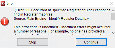

  • Hi Chen,
    I restarted everything and it started working, but at the end I got these errors
    (Error 5001 occurred at Specified Register or Block cannot be find in Register map tree.
    Source: Main Engine - Identify Register Details.vi
     This error code is undefined. Undefined errors might occur for a number of reasons. For example, no one has provided a description for the code, or you might have wired a number that is not an error code to the error code input.
     Additionally, undefined error codes might occur because the error relates to a third-party object, such as the operating system or ActiveX. For these third-party errors, you might be able to obtain a description of the error by searching the Web for the error code (5001) or for its hexadecimal representation (0x00001389).)
    Thank you,
    Mehran
  • Hi Mehran,
    When you can turn off your PC and power-off both AFE5818EVM and TSW1400EVM
    (including disconnect their USB connections and re-connect them back to PC after).
    If all the them still have problem to let the GUI up and running,
    then you may need to re-install HMC-DAC GUI and High Speed Data Converter Pro to your PC again.
    However before you are going to do so, you need to dis-install both of them in advance.
    If not, both softwares will not be allowed to do.
    Thank you and best regards,
    Chen

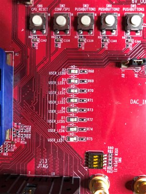

  • Hi Chen,
    Only C87 led turns on when I turned the switched ON on the board.  The rest is off even after the HSDC Pro (v5.00) shows the device is connected:
    the software recognizes the board as K1292917-TSW1400:
    and the status changed to HW connected after I hit ok and get the no FWmessage
    This is the board information I can see with FD_Prog
    Both software installations went without a problem the same it is shown in the user manuals. The only difference was that with HSDC Pro, the NI 2014 version was installed (manual mentioned 2010)  and after that with  HMC-DAQ GUI, the  NI 2010  was installed.
    Thank you,
    Mehran

    When you run High Speed Dataq Converter Pro (software of TSW1400)
    after you click on "OK" button
    and after you must choose "AFE5818" inside the following list shown as below:
    After you following the list,
    you will see D6 (should be off) and D5 (should be ON).
    This is to confirm with you that TSW1400EVM is ready to be used.
    If not (meaning when D5 still =off) , then TSW1400EVM is not ready to capture data at all.
    Please check it again.

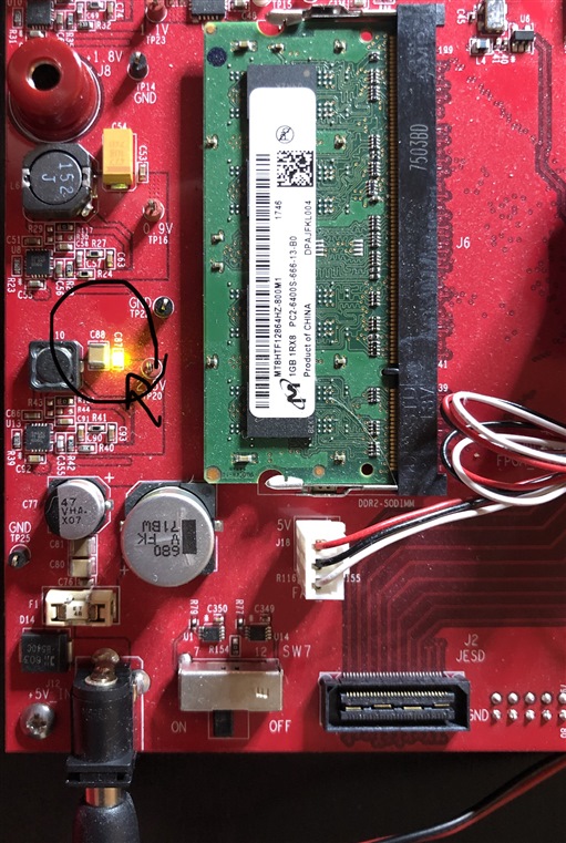

    One more questions: from your question, you mentioned about C87,
    what is this coming from?
    Thank you!

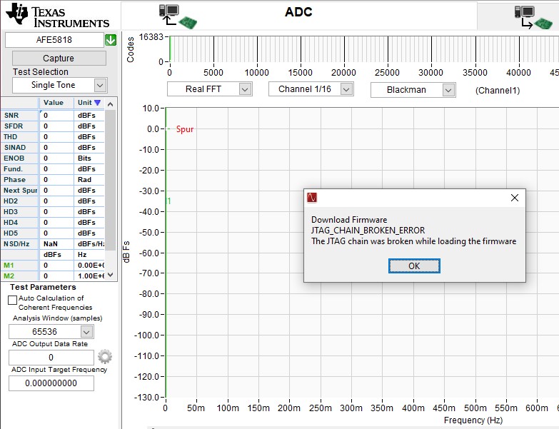

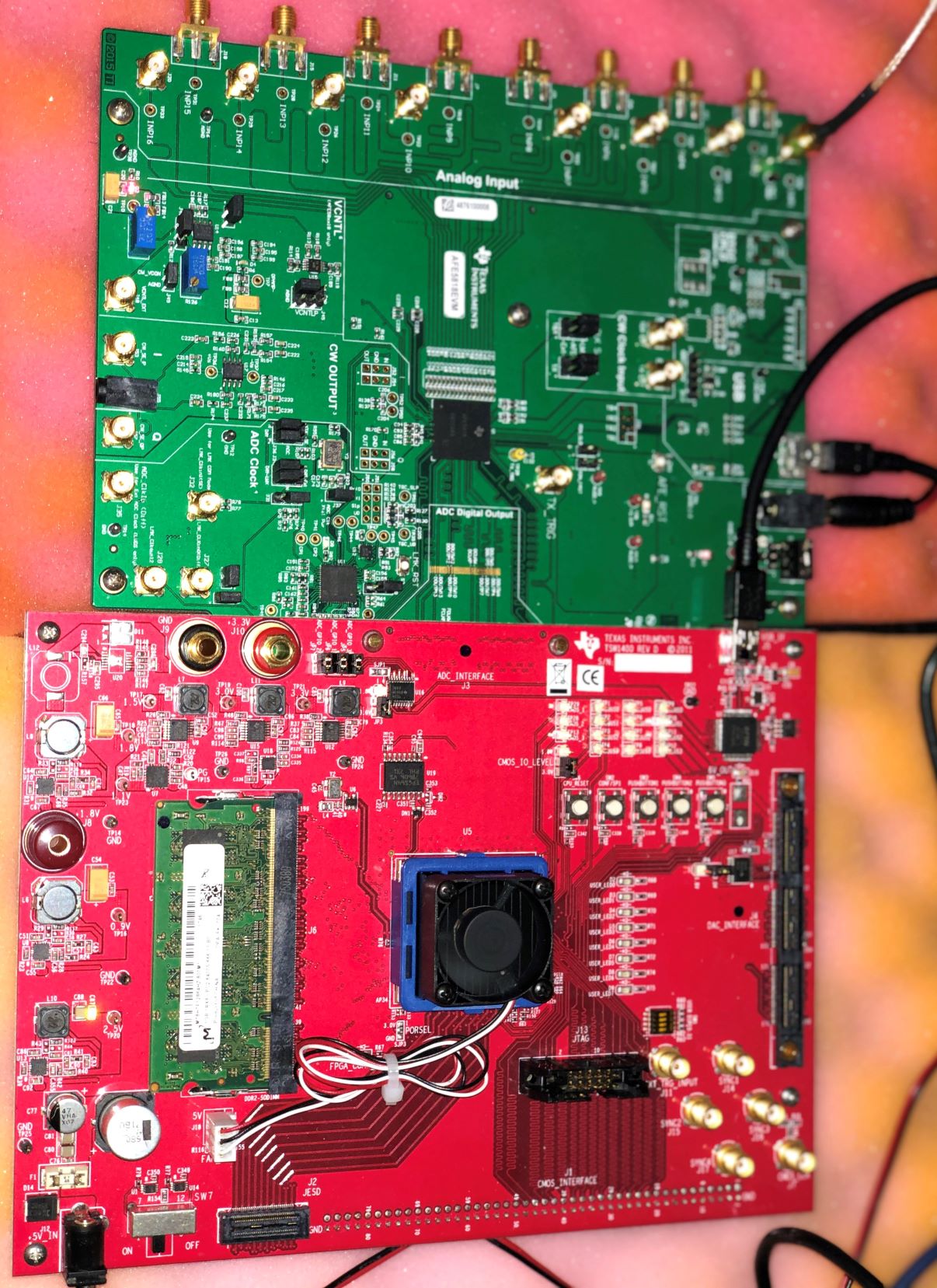

  • Dear Chen,
    I checked all the connections and switches that you mentioned.
    After Selectin AFE5818 from the list , a pop up question asks if I want to update the firmware. I clicked  Yes and after downloading the firmware te HMC-DAQ GUI was started within HSDC Pro , right at this time I notice all LEDs blined very shortly. But all lights remain OFF . In the HMC-DAQ GUI I did the DUT RESET and clicked on initialezed and got the errors that I mentioned n my previous messages.
    So should the LEDs turn on after initializing on HMC-DAQ GUI or before that?
    the picture shows how far I am
    after clicking ok this errors pooped up:
    regarding the C87, its the LED that turns on when the board is connected to power and SW7 is ON :
    Thank you,
    Mehran
