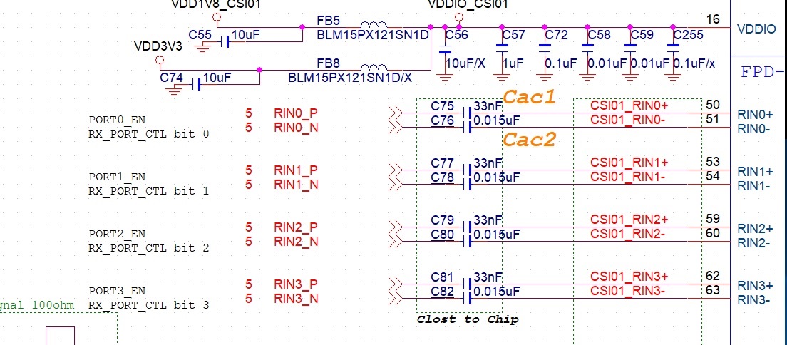

    For these comments in the schematic:
    DS90UB913A-Q1 and DS90UB933-Q1 R1=4.02K R2=4.02K L2=10uH Cac1=100nF Cac2=47nF L1=100nF
    DS90UB935-Q1 and DS90UB953-Q1 R2=4.02K L2=10uH L1= N/A R1=0 ohm/1% Cac1=33nf Cac2=15nf
    Please make the following changes:
    DS90UB913A-Q1 and DS90UB933-Q1 R1=2.0K R2=2.0K L2=10uH Cac1=100nF Cac2=47nF L1=100uF
    => get it.

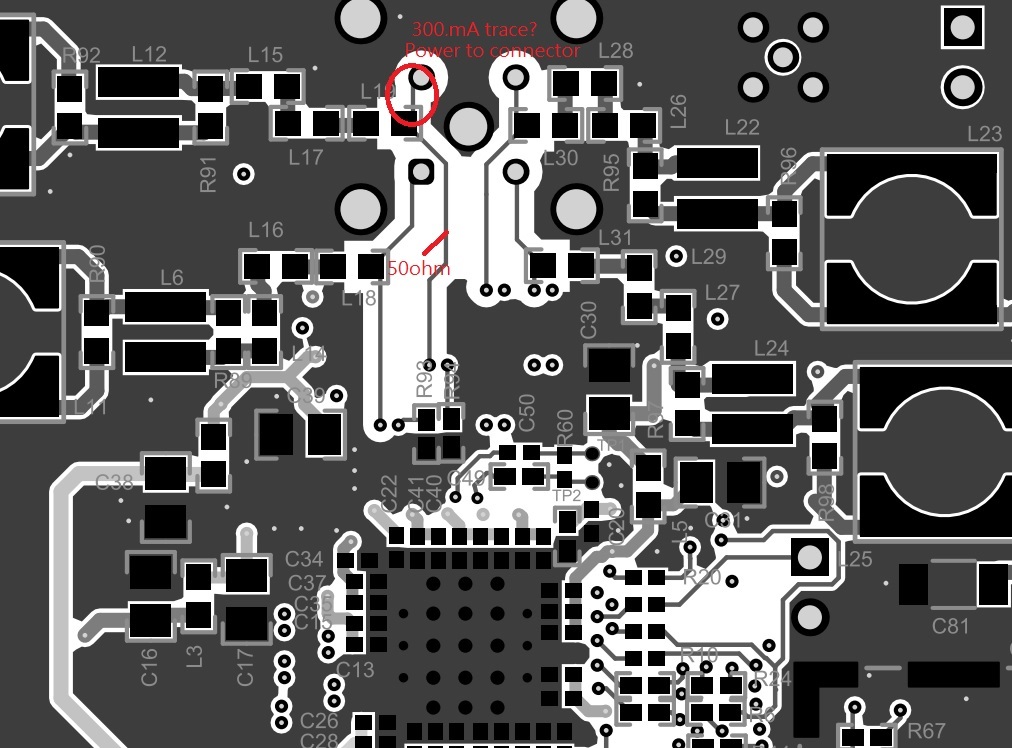

  • Thank you for your reply.
    If I chip and connector of a long distance, Such cac1 & cac2 to close chip or connector? (It seems to be close to the chip)
    In addition, I refer to the layout of the EVM. The PCB trace from Power to Connector is not widened. Can the current output 300mA~500mA? (How many mil? We 50ohm is 5mil, Is this enough?)
    Can you provide EVM board file for us layout reference?
  • Hello Ben,
    It is recommended to place the AC coupling caps as close as possible to the IC rather than the connector. The recommended PoC network from the datasheet is not suitable for 500mA current. It is only suitable for ~250mA max. If you need to supply more power, it is recommended to increase the PoC voltage.
    I will send you a private E2E message with the EVM file for reference.
    Casey
  • So it's okay for  PCB trace=5mil  at 250ma right?
    How do I get this file?

  • Hello Ben,
    Yes 5mil should no issue for 250mA. The oscillator specification does not look good because the electrical parameters are only specified at room temp. See the notes on page 3.

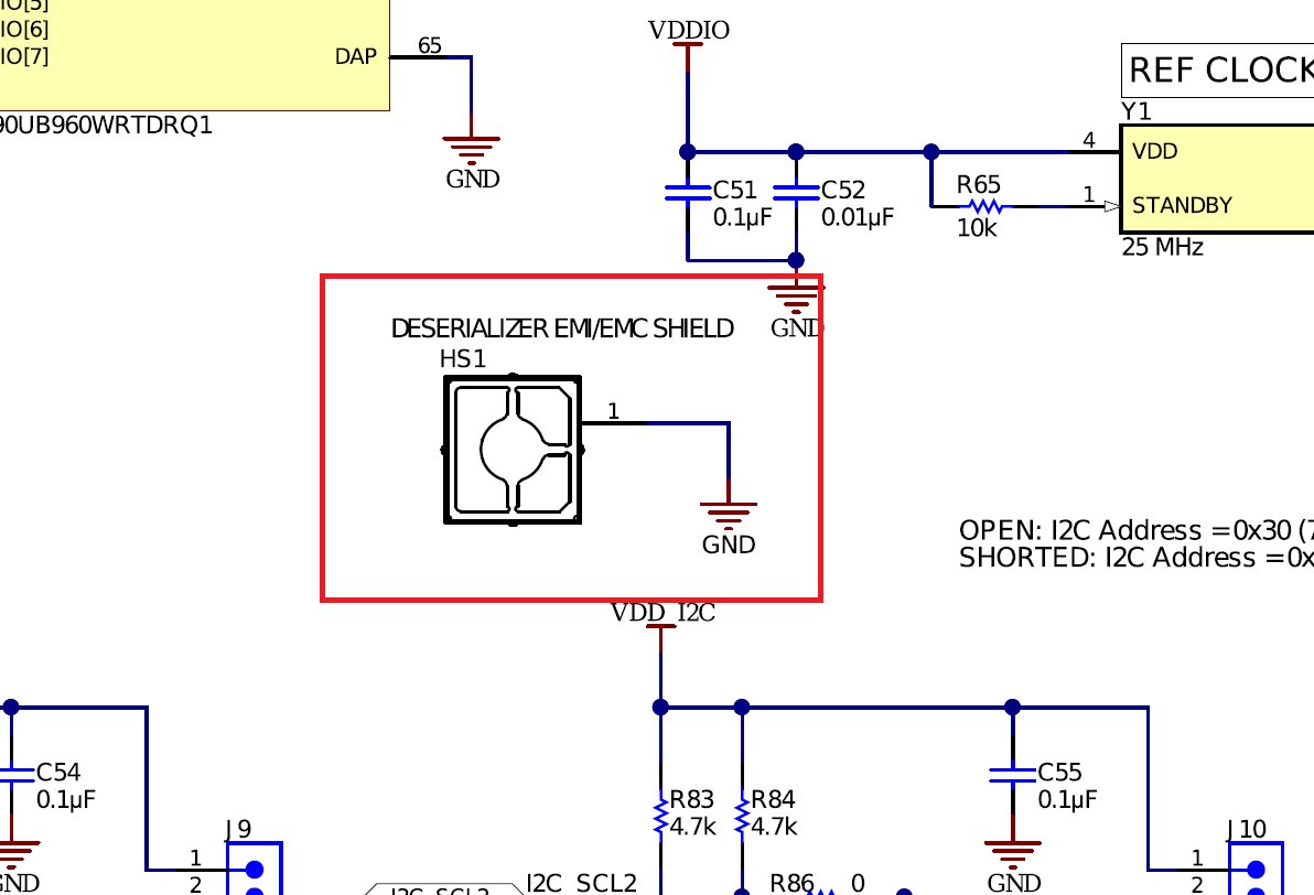

  • hi Casey,
    HS1 is necessary?
  • hi Casey,
    According to the experience under what circumstances will be used HS1?
  • Hello Ben,
    HS1 is not required but it may help reduce some radiated noise from the oscillator if it is populated.
    Casey
