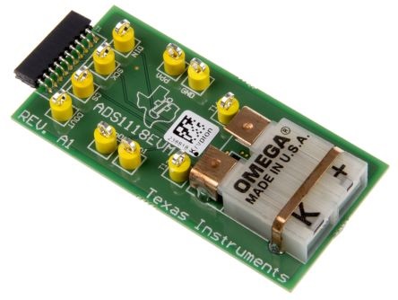

    For the thermocouple measurement to be accurate, the two leads of the thermocouple and the cold-junction measurement must all be at the same temperature. Generally, the PCB is designed so that all three are close together, so the temperature should be the same. In the ADS1118EVM which shows this as an application, the device is placed between the two contacts for the thermocouple. It's a little hard to see, but it's the black device near the "OMEGA" lettering as you can see in the following picture:
    You can find more information about the EVM here: http://www.ti.com/tool/ADS1118EVM

    To calculate the thermocouple voltage, you follow these steps:
    1. Determine the cold-junction temperature and convert the cold-junction temperature(TCJ) to a voltage (VCJ)
    2. Add the cold-junction voltage to the measured thermocouple voltage (VCJ + VTC)
    3. Convert the summed cold-junction voltage and thermocouple voltage to the thermocouple temperature (TTC)
    As a figure, it looks like this:
    For determining the temperature to voltage for the cold junction and the voltage to temperature calculation for the thermocouple, you could use the polynomial calculation, but often, people use a lookup table. Both can be found here for a variety of thermocouples:
