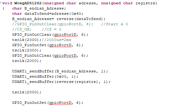

  • yes im using an internal oscillator ,and i use the Start pin , and my  ADC device is powered properly , but i didnt understand what i should do with " set theGPIOs(for reset and power-down) to the correct states in order for /DRDY to toggle and for SPI communications to work as expected" !?
    and her is a photo about my write and reading registers, and read data.

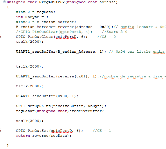

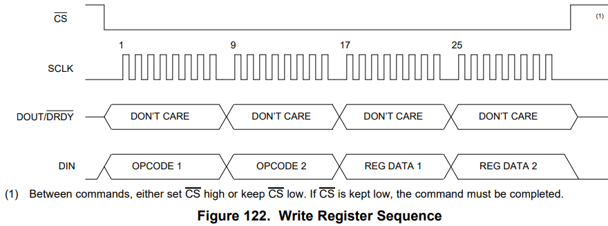

  • Hi Julien,
    1. For WregADS1262( ) subroutine,the /CS pin does not need to be toggles so many times. Setting it low at the beginning of the SPI frame and high at the end of the frame should be sufficient. Also, I do not understand your purpose to use reverse().
    2. In RregADS1262( ) subroutine, I do not understand your reverse(). Also, you may need to call SPI1_setupRXInt() BEFORE you call USART1_sendBuffer().
    3. In Read_Data_Call_Back (void) subroutine, I have same question about your reverse command byte 0x12. This is usually not necessary unless your MCU sends the LSB first.
    The ADS1262 doesn’t require any delay between bytes when sending an SPI command. Only a ~50 ns delay between when /CS goes low to the first SCLK rising edge is required. In most cases the MCU will not be able to trigger a SPI send command this quickly, in which case no call to tsclk() may be needed at all.
    Dale
  • hello Dale ,
    the read and write commande is working perfectly  after i  called SPI1_setupRXInt() BEFORE you call USART1_sendBuffer().
    and the reverse function is  just for little to big indian  ,

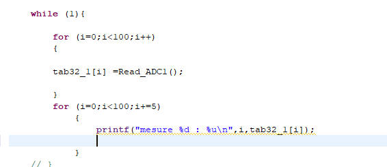

  • Hi Chris,
    i read the ADC code to voltage conversion before  ,  but what im reading here is just the 32b_ data , at first  all the  data_32b were the same  , after i tried to change the config of some registers , like ysing Chop mode and IDAC rotation ,delay conversion, magnitude current , even there is no need to use some of them , but i  just  give it a try and i actualy  recieved some  reasonable  data at the speed  of 14400 sps, but i know its not the real solution .
    this is my main ,im trying to fill a chart and then read it
