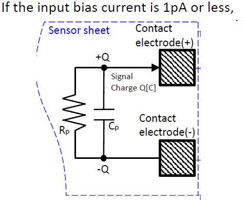

Customer are looking for 24bits ADC which with lower input bias current (<1pA) and SPI output.
Did you have any suggested solution? thanks

ADS124S08, ADS1292, and ADS1299 are going to be the best alternatives to ADS1298 in terms of bias current, however they are not less than 1pA.

Lower input bias current is one of spec of sensor (as the pic I attached in last post).
If we don't have suitable solution now, can we design with OPAMP to implement this application.
