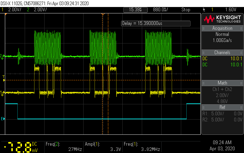

    The first image contains a complete cycle of transmission. I read out 3x32 bit of the ADC and write 3 times the control register content to it. Green is CLK, yellow SDI and blue FS.

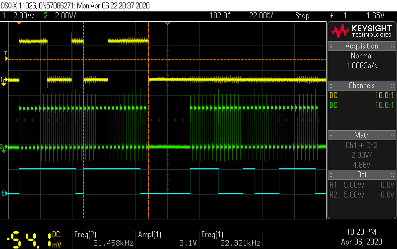

    On the second image is only one 32bit transmission shown, to see better whats happening, the FS is still low.
    (Second image)

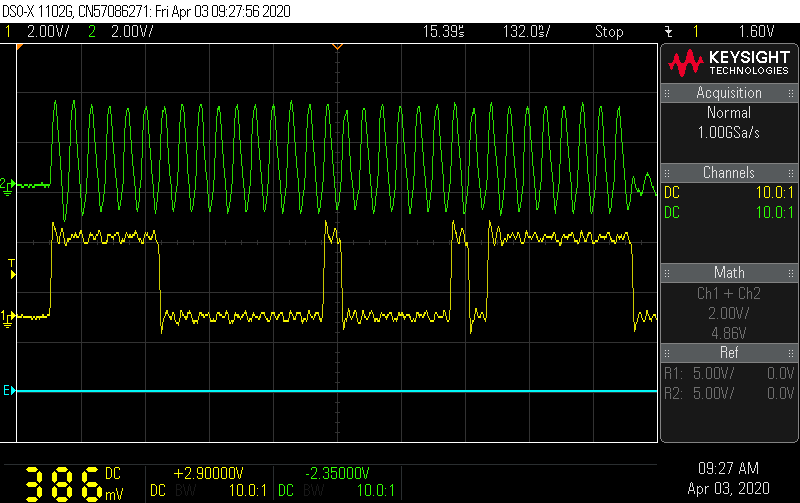

    I'v done it like you told and monitored it with the oscilloscope, shown in the screenshot (channel 1 SDI, channel 2 CLK, channel 3(EX) SDO).
    Interestingly this yields 1.24V on the REFIO pin.
    Michael
  • Thanks, this is good information.
    The SDO read out, if I am looking correctly, has the last bit low, although it was programed to be high. So it does seem that there is a discrepancy.
    Would you confirm that you are using SPI mode1? The SDI and SDO data should change state at rising edges of SCLK, and be read on falling edges of SCLK.

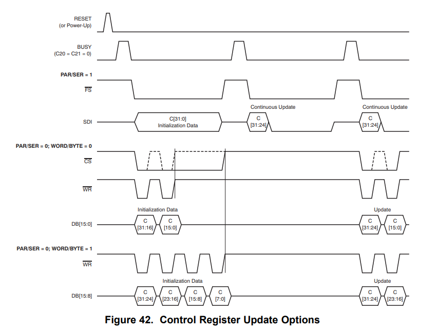

    Looking at the timing diagram to update the CS, shown below, there are a few aspects that need to be considered.
    Note that the BUSY signal goes high after the first frame, this means that a CONVST was initiated between the two frames. after the first frame, you need to be sure to toggle CONVST and wait until BUSY goes low again before the second frame. Also, be mindful of the state of CS, as this also needs to be low.
