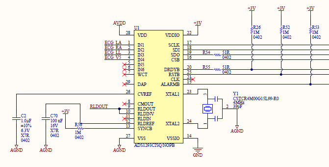

  • Hi Ryan,
    Here is the ads1293 resonator connection.
    Thank you.
    Carlo
  • Hi Carlo,
    Thanks for sharing a portion of their schematic.
    After review the measurement diagram in the resonator datasheet, I believe it is connected correctly in the customer's schematic above. The orientation of pin 1 vs. 3 relative to the ADS1293 should not make a difference. Pin 2 should be referenced to the digital ground of the circuit.
