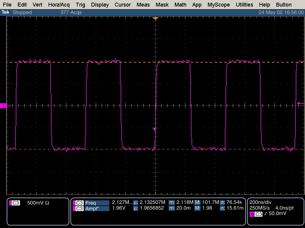

I am trying to design with ADC12DL3200 in single Channel mode at 6GSPS, 4-Bus, Staggered-Mode Timing (LDEMUX = 1, DES_EN = 1, LALIGNED = 0) as datasheet figure 6. the ADC use external input device clock 3GHz and steady before ADC power on.
now i can access all registers via SPI correctly, I followed the initialization set up on datasheet 8.3 part to initialize ADC.
but on FPGA side, i failed to get lock to the DxCLK, i tested the DxCLK with high speed oscilloscope on my board, which surprised me that frequency of all the 4 LVDS buses DxCLKs are ~2.12M instead of 750MHz as I supposed. the 2.12MHz clock is stable with very good SI. and this clock show up once power on even no 3GHz device clock enabled  or FPGA firmware download.(equal to disconnect all the SPI/LVDS to FPGA) .
NO sysref/TMSTP provided since only single ADC used on my project.
Do you think the DxCLK behave correctly? why is 2.12MHz ? if it's not correct behavior, any suggestions to further debug on this situation?

  • User,
    The 2.12MHz clock is possibly due to the “self-toggling” clock in the ADC that is there to prevent asymmetric aging when the ADC is in power-down mode.
    Can you verify the logic state of the power down pin of the ADC? Also verify the power down register is not set to power down mode.

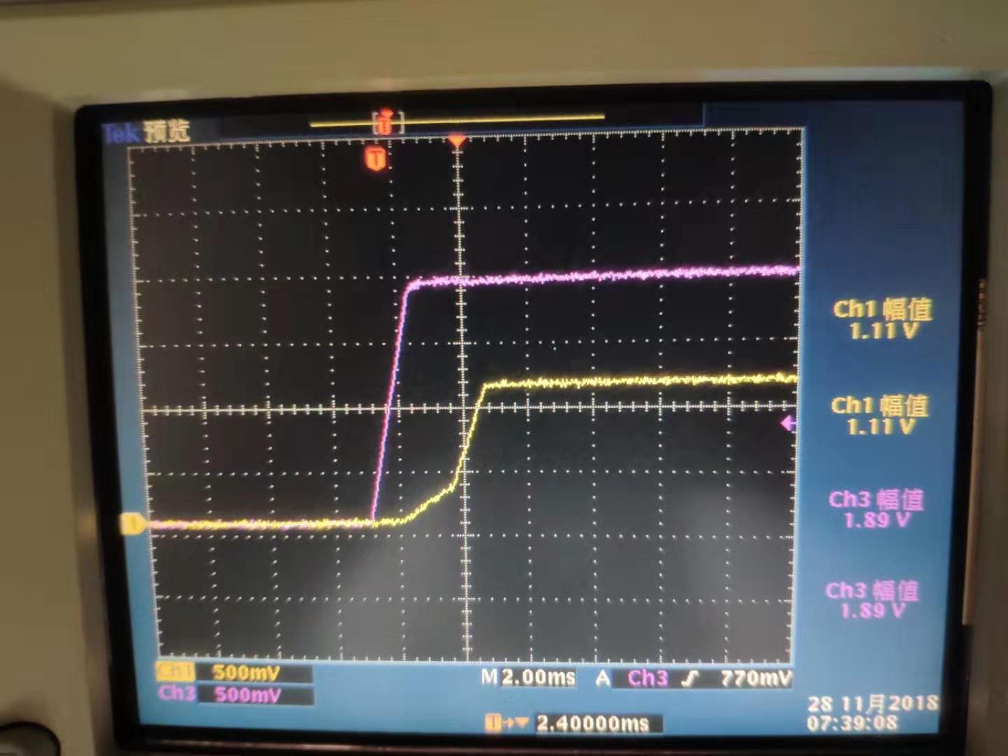

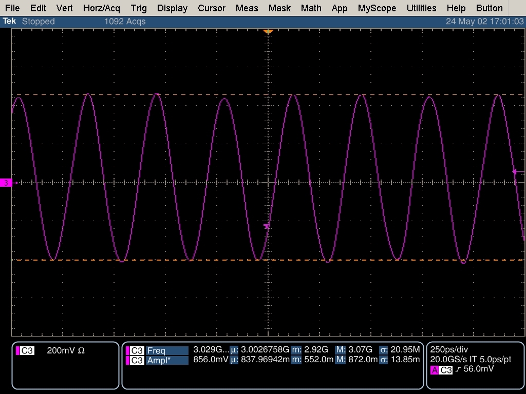

    1, the ADC clock input is correct, i made a measurement at the AC capacitors which the closest to ADC pin as below picture.
    2,the DxCLK output always present once power up, also present even if no 3GHz reference clock providing. and never change when power cycling or register configuration. the DxCLK shown as below picture, the amplitude is ~2V.
    3, i can read/write all register, also i can disable the DxCLK by write reg 0x200=0.
    4, now the total power consumption is about 0.25A*12V = 3W.
    pic1: ADC 3GHz ref clk close to ADC CLK IN pin.
    pic 2: DxCLK output

    i design the power topology as datasheet Figure 179, now the 12V import consume 0.25A, that's for ADC and all the DCDC regulators&LDO loss. no other components use this 12V power rail. it's always 0.25A, no change while power cycling.
    i tried to change a slower clock 2GHz and 1GHz, always the same 2.13MHz output at DxCLK.
    i tried to config ADC as datasheet chapter 8.3, also set user defined test pattern, but the problem is since no correct DxCLK, i can't bring up the LVDS interface in FPGA side, the PLL in FPGA cant get lock, so i can't extract any data...
    since the DxCLK output behave like 'default status' of ADC, is any such as 'shadow register' or any suggestion to check the ADC status?

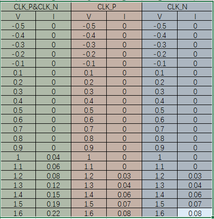

    1. Measure the IV-Characteristics of the CLK pins wrt chip GND
      • sorry I can't got the mean of this case. could you explain more details on this one?
        1. Power up the part.
        2. Short the positive and negative CLK input to your + connector of a voltage source
        3. Connect the – connector of your voltage source to AGND
        4. Sweep the voltage on your voltage source from -0.5V to 1.6V
        5. Measure the current flowing out of your voltage source
        6. Repeat measurement with + connector of the voltage source only connected to CLK+ pin of the chip
        7. Repeat measurement with + connector of the voltage source only connected to CLK- pin of the chip

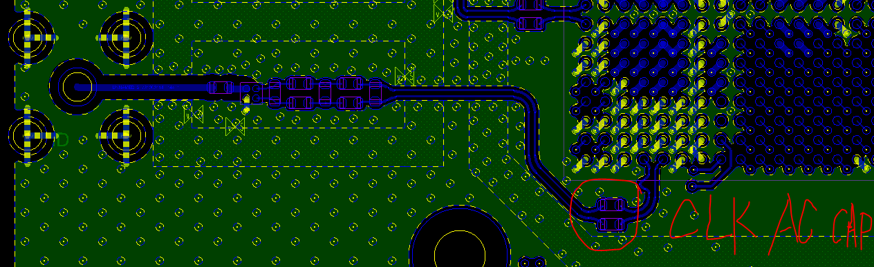

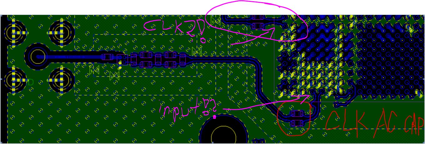

    Would it be possible to get a picture of the board layout? Would be sufficient to see the area between the ADC and the AC Caps for the clk.

    2, I-V character wrt GND as below pic:
    3, the differential resistance is 142.2ohm when power off, and 79ohm when power on and CLK input removed.(ensure less than 0.5V differential voltage)
    4, shall we grasp this clue and dig in to see why it's not 0.3V?
    5, the AC CAP is closed to ADC as possible as below pic:
    Thanks and Best Regards.
  • User,
    I assume that the units in the IV-Characteristics are V and A. So they are 220mA flowing when 1.6V is applied.
    Looking at the marked net in your layout, the Vcm measurement and the IV-Characteristics, it appears like you may be measuring the wrong pin.
    The marked pin in the layout looks more like inA or inB (based viewpoint of the layout). Please see attached. This would explain all of the phenomena observed.
    We also looked into the SPI writes to the part. Independent of the problem with the wrong CLK frequency, register address 0x61 has to be set to 0x1 before setting address 0x200 back to 0x1. Otherwise the calibration engine holds the ADC sample generation in reset.
    Jim
  • Hi
    I was shocked from this reply and finally i realized that i made such a stupid mistake: i mis-connected the ADC RF input and clock input..  that's why i am failed to get the clock output on DxCLK. now everything works well now.
    even feeling a little bit frustrated on such kind of mistake, but that is part of work and life. anyhow, here i would sincerely appreciate all of you TI guys help me to find the root cause out. thanks for your professionalism, insistence, and patience! really great support! you guys made my day. now just take a cup of coffee and chat with your colleagues: hejhej~ i got a funny case, here is a nerd who made such a stupid mistake blabla,  :-)
