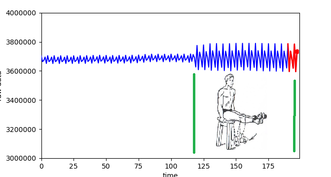

  • Hello, Alex, sorry I still have the problem. Now checked different settings and made graphs.
    1. When I use bias out electrode - measurement depends on the connections legs and floor. When legs connect to the floor I have a big noise.

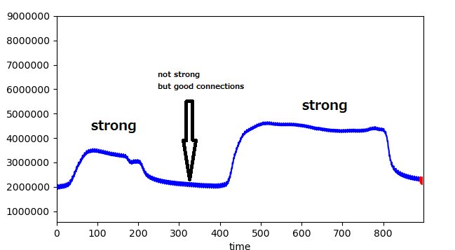

    2.When bias out register - OFF. (0x0D, 0x0E, 0x0F,0x10,0x11 = 00h)
    Bias out electrode is very sensitive. Every time when the bias electrode connects to the ear I receive a different result. In the photo lower you can see differences between strong fixation bias out electrode and not strong.

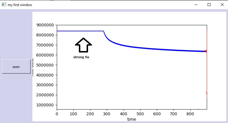

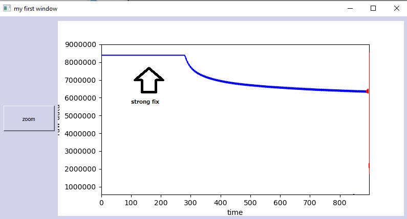

    3. 2.When bias out register - On (0x0D=01h, 0x0E, 0x0F,0x10,0x11 = 00h)
    Bias out electrode is very sensitive.How you can see in the photo lower when I connect biases out electrode with good fixation I receive saturation of the amplifier
    same result when i use 2M, 1M, 500K, 100 K

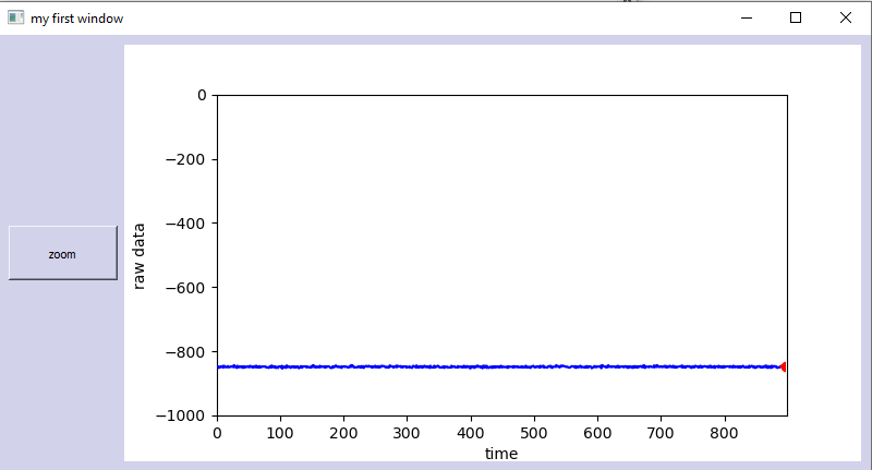

    4. without bias electrode I receive a stable result. But this signal without useful information. without any frequency. It looks not correct.
    It is very strange - when i measure the voltage between biasout and GND in the board i have - 0.7 V. but should be 0

  • Hi Ildar,
    These results are due to changing electrode connection impedance, or changing how the patient is grounded. This is a dynamic electrical system, so seeing changing to electrical signals when there is a changing impedance in the feedback loop is not surprising. Similar for when the patient grounding (legs up or down) changes.  I recommend focusing on your digital filtering techniques if you would like to remove these motion artifacts.
