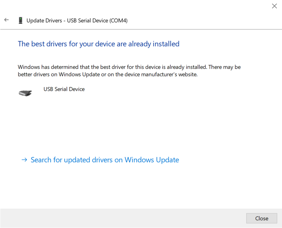

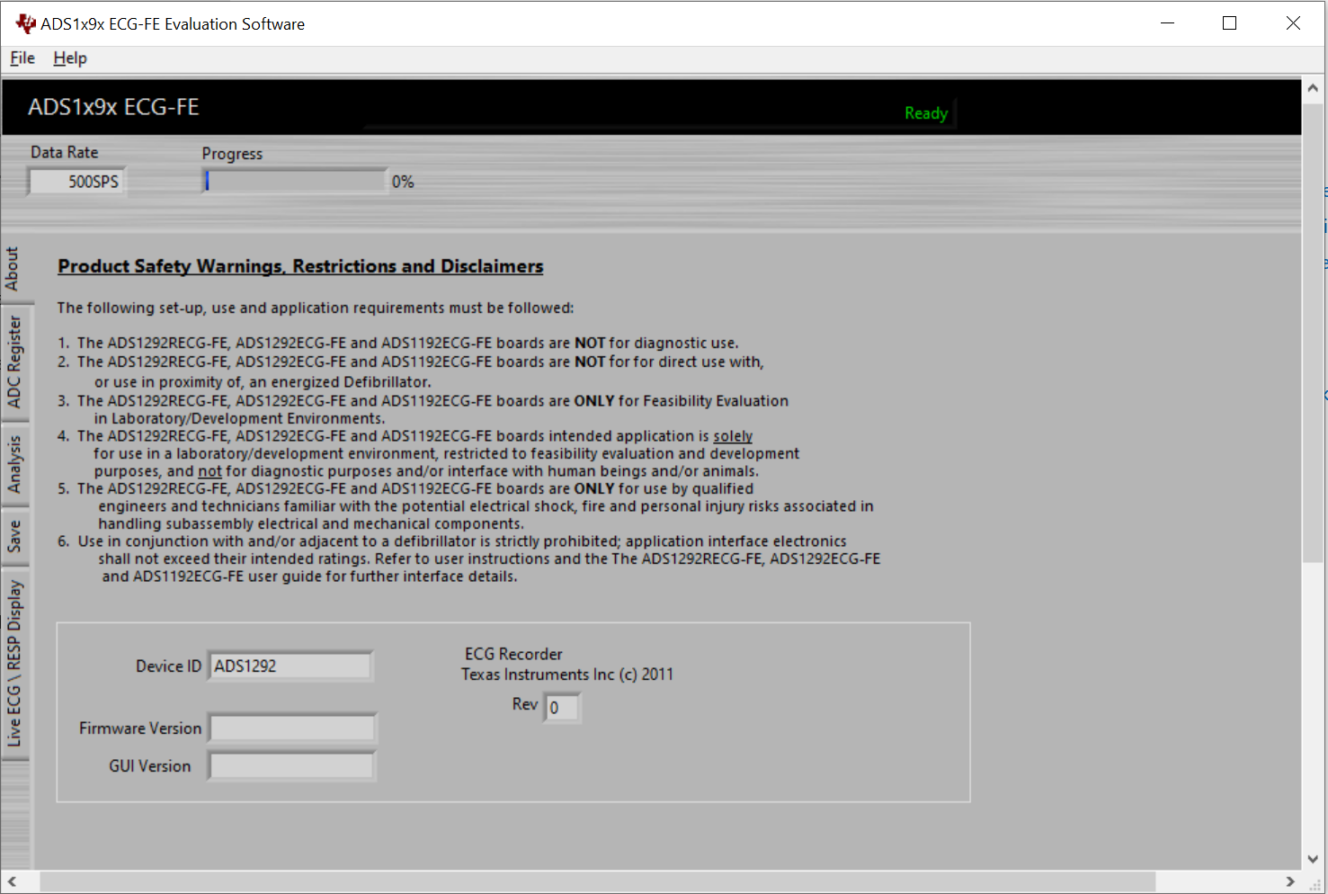

  • So I cant find "ADS1x9x ECG Recorder" in my device manager but I am able to open this (see attached screenshot). Is this okay?

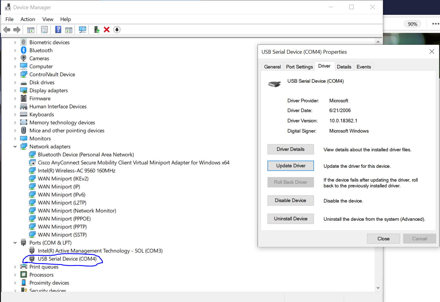

    Please share a screen capture of the Device Manager with the GUI closed and the EVM plugged in. If the EVM does not enumerate properly, the GUI will not be able to communicate with it.
    You may have to force the driver to install if it didn't do it automatically, right-click on the device in Device Manager (it will probably say Unknown Device) and select Update Driver Software. Then, manually point to the following folder: "C:\Program Files (x86)\Texas Instruments\ADS1x9xevm\USB Drivers".
  • Hi Ryan! Thanks for your prompt reply. I am attacing two screenshots of my device manager and the usb port through which my pdk is connected is called "USB Port (COM 4)".
