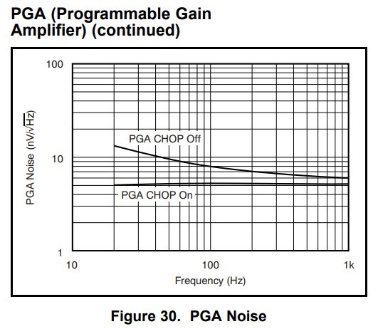

    Also for Seismics applications, a device like the ADS1282 or ADS1283 would also provide an integrated PGA. The integrated PGA on these devices is very low noise (5nVrms/ sqrt[Hz]) and chopped to remove 1/f noise. There really aren't many comparable discrete amplifiers available that would provide the same level of noise performance:
