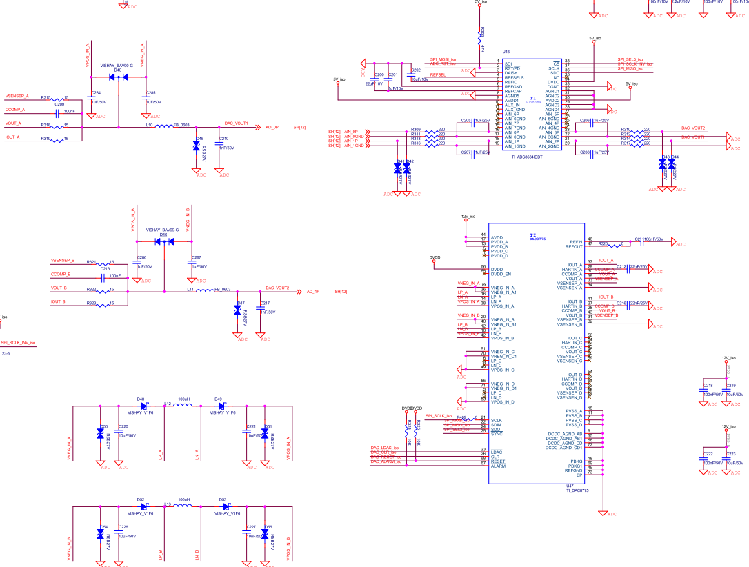

The DAC8775 related part of schematic as below
some one can help me to figure out the problem?

  • Hi Akhilesh K
    I posed my schematic as below,please help me to check.
    This design is +/-10V voltage output and 0~20ma current output
    by the way, i am so confusion that the voltage and current in same trace,so how can i check that the current output is correct by my setting?
    for example, when i setting different current output value,i can still measure the different voltage in same node? right?

    i already reattach a part of schematic
    two DAC output are feedback to ADC input for monitor, if this design have any Inappropriate ,please help us to find out it.
    For your system, it looks like you're using the Buck-boost converter for channels A and B. I would enable the buck-boost converter, and set it to enable the PCLMP and NCLMP for the CCLP bits and then set the clamps to +15V and then -15V. This should enable the buck boost to put that voltage to VPOSx and VNEGx.
    That should allow for the VOUT mode of the DAC. After that you can set up the DAC as you would to output something in voltage mode.
    Once you have this programmed, check the output voltages of the VPOSx and VNEGx. If that appears correct, then check the VOUT of the DAC. Note that with IOUT mode, this may change the VPOSx and VNEGx settings as the IOUT changes.

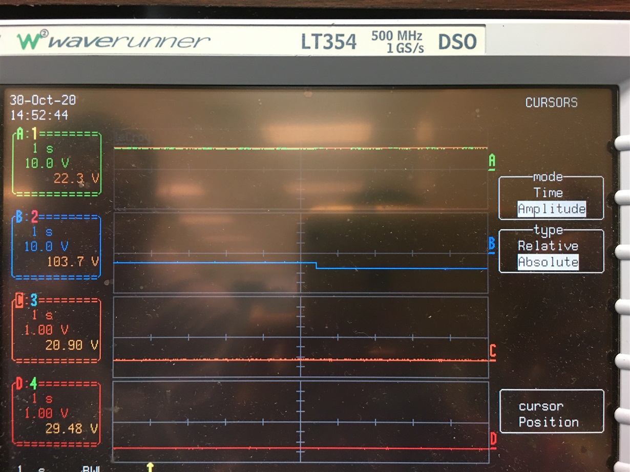

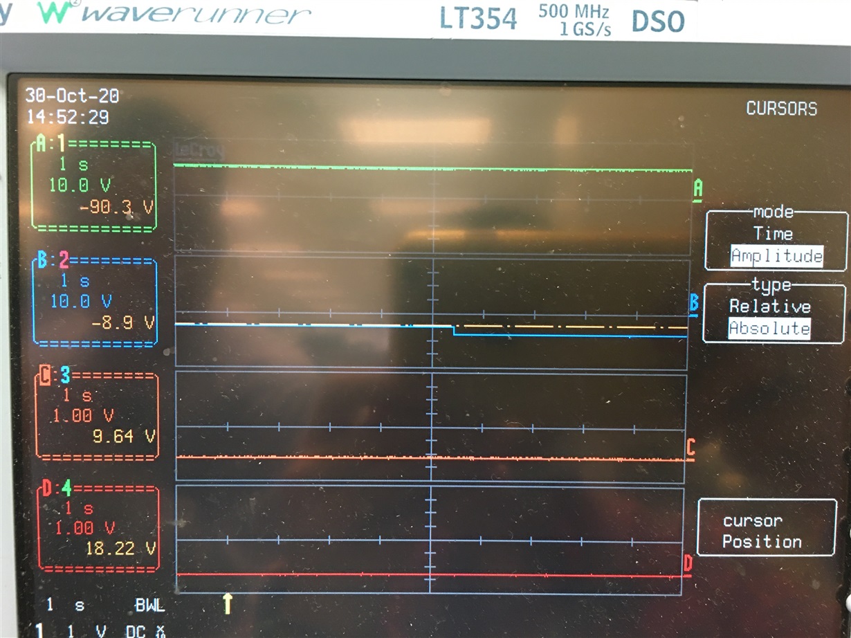

  • Hi Joseph
    following your mention before, when i useing the buck-boost converter
    and setting PCLMP and NCLP for -15V~+15V rang ,then check VPOS_A and VENG_A
    No matter what i change another level,only setting NCLP is correct by measure VENG_A
    VPOS_A seems keep around 22.3V whatever i set +9V or +15V as below picture
    Of course i still can't get right value by DAC output in voltage mode.
    So what is next step by your suggestion
    Ch1. VPOS_A (green)
    Ch2. VNEG_A (blue)
    I would try to verify the write to the device. At this point the output voltage of 22.3V for VPOS_A is unusual for a voltage output and the clamp shouldn't work at to that setting. However, at the current output mode, you may get different VPOS settings for different current outputs depending on the load resistance and what headroom you might need for the output.
    Try setting the registers and reading them back to verify that the write has taken place correctly. I would read back all of the registers just to ensure that the setting is correct. Normally, by setting and enabling the range to a voltage output setting, the buck-boost converter will automatically set the buck-boost to the ±15V settings.
