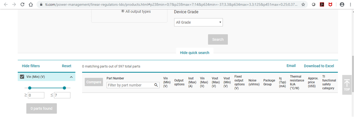

Here is a pre-filtered list of LDOs which look like they'll work for your system: https://www.ti.com/power-management/linear-regulators-ldo/products.html#p238min=0;7&p238max=7;14&p634min=-37;3.3&p634max=3.3;125&p451max=0.25;0.375&p182=
Hmm, strange. The results I'd seen had 7 products and I didn't implement a 250mA limit so something odd must have happened. Anyways, since you've found the LDO search page I think you'll be able to find products that work for your application to power the ADS7038 and the other products on the same supply rail. Please sort for a current that works well for your total system needs.

We have the ADS7038Q1EVM-PDK available to evaluate the ADS7038 and there is the TPS78001DDCR LDO used for the AVDD supply. Since your request is a little specific about looking for high EMI robustness I'd like to suggest you the TPS78001 since we use it successfully in standard lab environments without issue and then that you start a new thread to the LDO team to discuss the best solutions for high EMI/noise environments.
