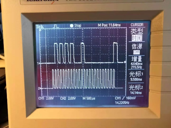

    Looking at the document that you provided, it looks like the communication is the problem. The way that you have the microcontroller set up to send data is off in the SPI mode. The SCLK should idle low (CPOL=0), and the data should be transmitted on the rising edge of the SCLK (CPHA=0).
    However, in your scope shot, it looks like you have the SCLK idle low (CPOL=0 - which is correct), but the data is transmitted on the falling edge (CPHA=1). This is the scope shot you sent:
    In your scope shot it looks like your DIN is changing at the same time the device is reading it. This is how it should look from the datasheet:
    In your microcontroller you should change the SPI mode from 1 to 0. Most microcontroller manufacturers use these mode numbers, and you'll may need to make sure that the mode is correct by using the scope shots to look at it.

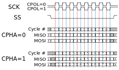

    The problem is that your SPI is set up wrong. There are several modes of SPI timing. From this graph you can see the SCLK can set up as idling at high or low, and the data can be clocked in at the leading edge or the trailing edge.
    This gives four SPI modes:
    Mode 0: CPOL=0, CPHA=0
    Mode 1: CPOL=0, CPHA=1
    Mode 2: CPOL=1, CPHA=0
    Mode 3: CPOL=1, CPHA=1
    In your setup it looks like your MCU is using Mode 1, when it should be using Mode 0. From your scope photo, it looks like mode 1 because your data changes on the leading edge of the SCLK when the data should be stable. Here's your scope photo:
    Instead, it should look like the following, where data is set up on the falling edge of the SCLK and read on the rising edge of SCLK:
