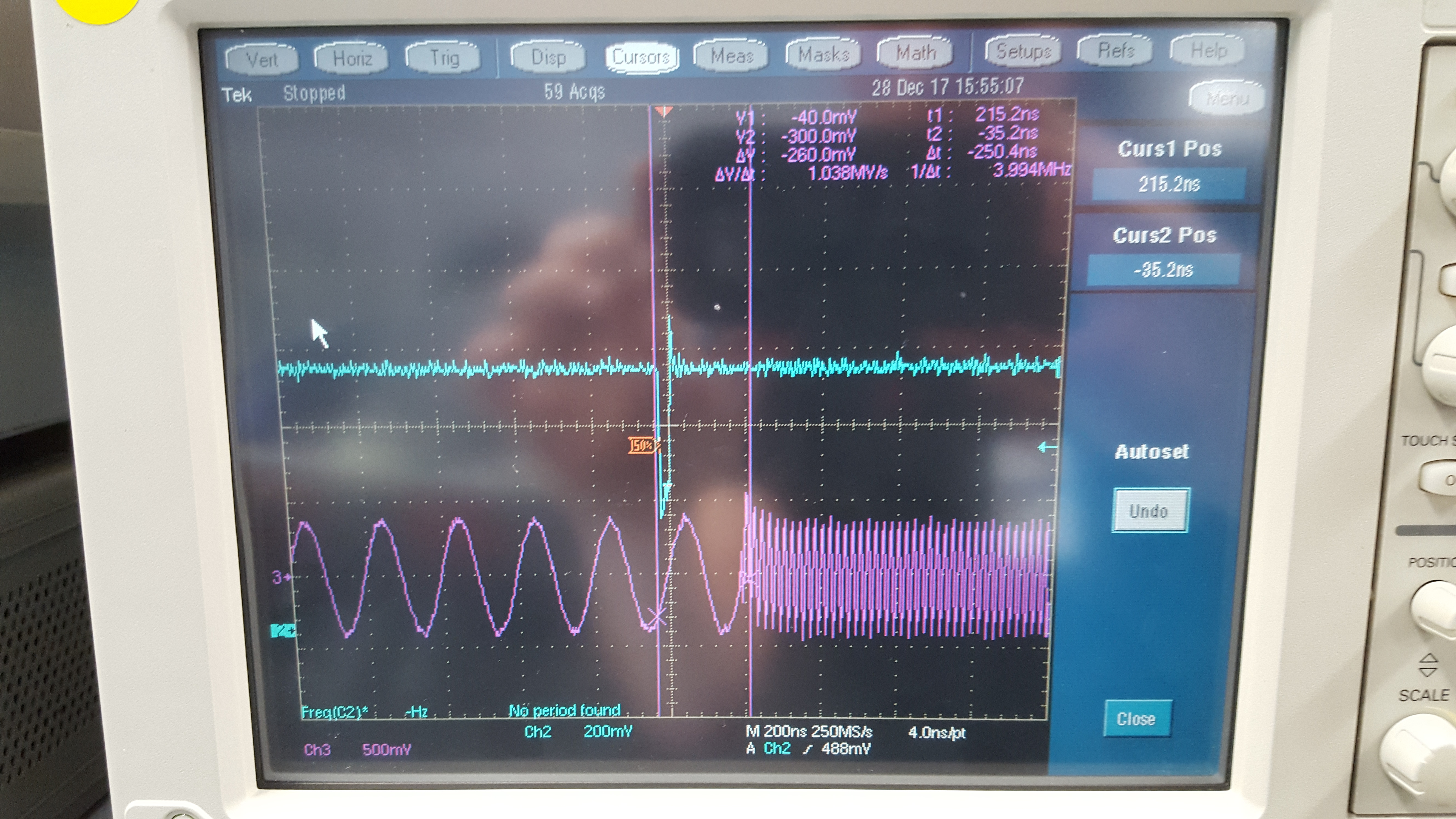

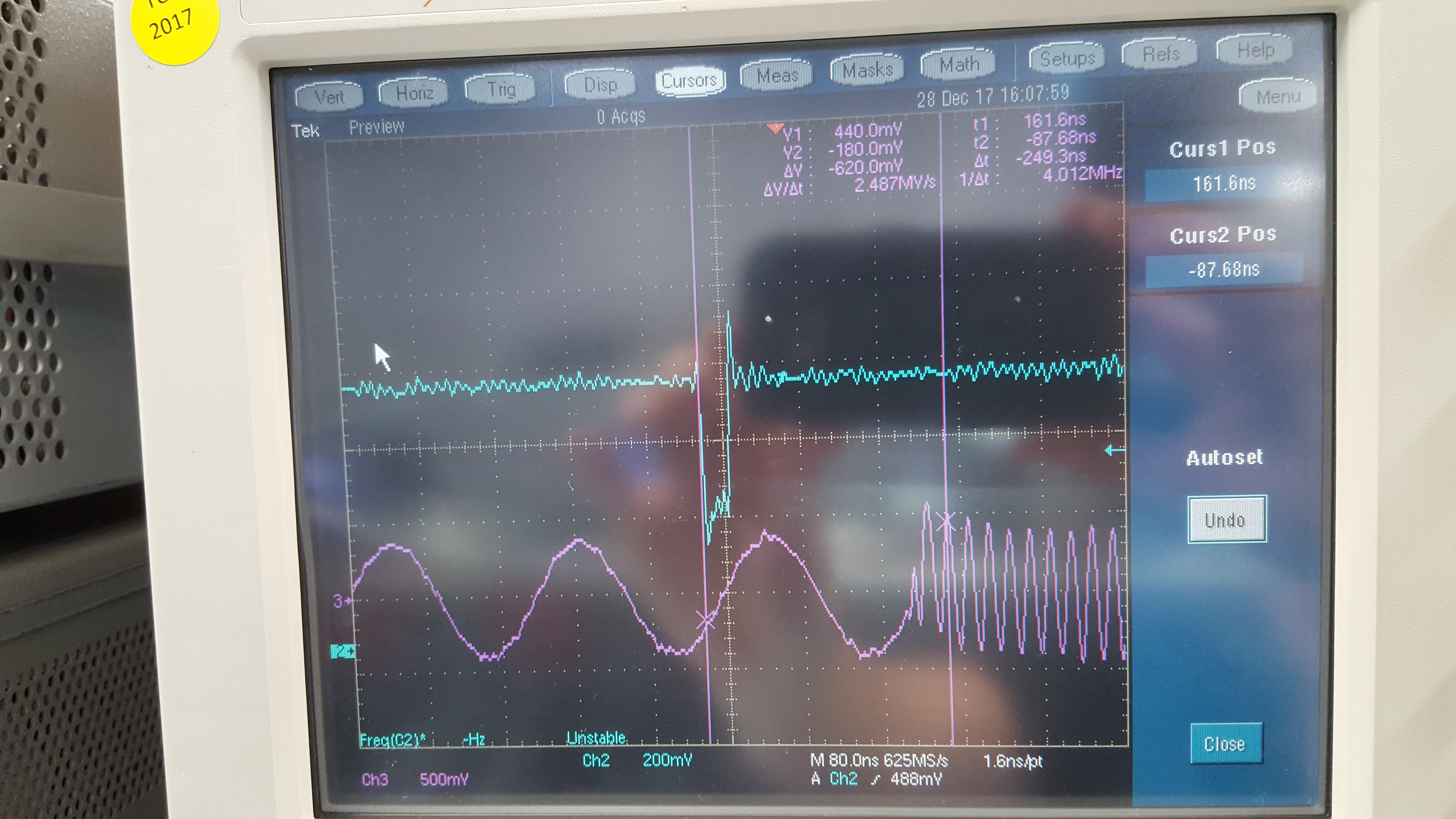

I our Custom Board, we are using Multiple DAC38J84. We need to reset the NCO in all the DACs at the same instant to synchronize all the DACs
1.We need alignment of DAC NCO.To do this we are doing NCO reset on Sysref. But we are unable to achieve it at 600 MHz NCO Frequency.
We are giving reset pulse to SYNC pin of LMK. From LMK we are routing this reset signal on to LMK Sysref Path. From this Path we are using this pulse to reset NCO.
Will there be any delay between the Sysref paths of two LMKs ??
Please check the NCO configurations attached for 600 MHz Output.

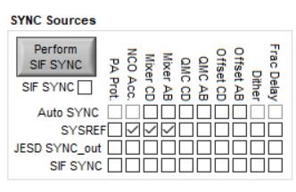

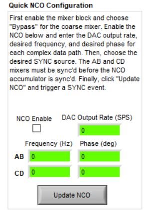

2. To Align NCO Data and JESD Data, is it required to align MIxer AB and Mixer CD on all the DACs ??
Is it required to reset Mixers before NCO accumulator ?? or all NCO accu, Mixer AB, Mixer CD can be resetted at the same time, using same pulse
