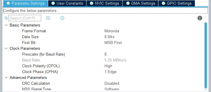

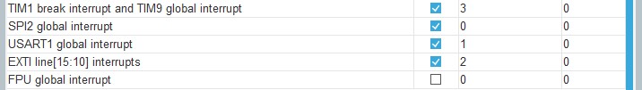

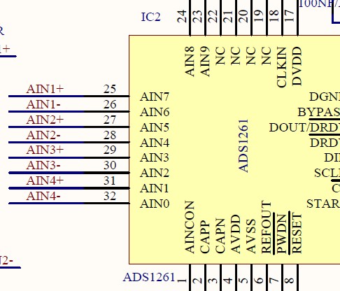

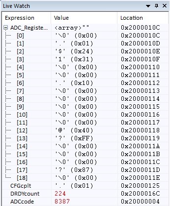

      If I don't rewrite "INPMUX" register, the conversion won't start. At first, four sensors were connected to the inputs. I query each of the four input pair in turn. So rewriting "INPMUX" register is necessary. Once I removed three sensors, the conversion wouldn't start if I didn't rewrite the "INPMUX" register. This is the reason why I'm still rewrite "INPMUX" register now. That's why I'm curious. I found this problem accidently. Maybe there's something wrong with my configuration. So let me list the settings of my application below:

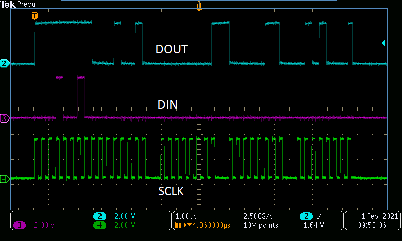

  • Hi User,
    If you did not use INPMUX to start conversions, how would you control conversions then? Are you issuing the START command or pulling the START pin high? If so, what happens when you do this?
    If you are issuing the START command, please send me logic analyzer shots of the DIN and DOUT pins.

  • Also, the SCLK should idle low for the ADS1261
  • Yes, you are right. The SCLK should idle low. My problem is resolved. Thank you very much!
