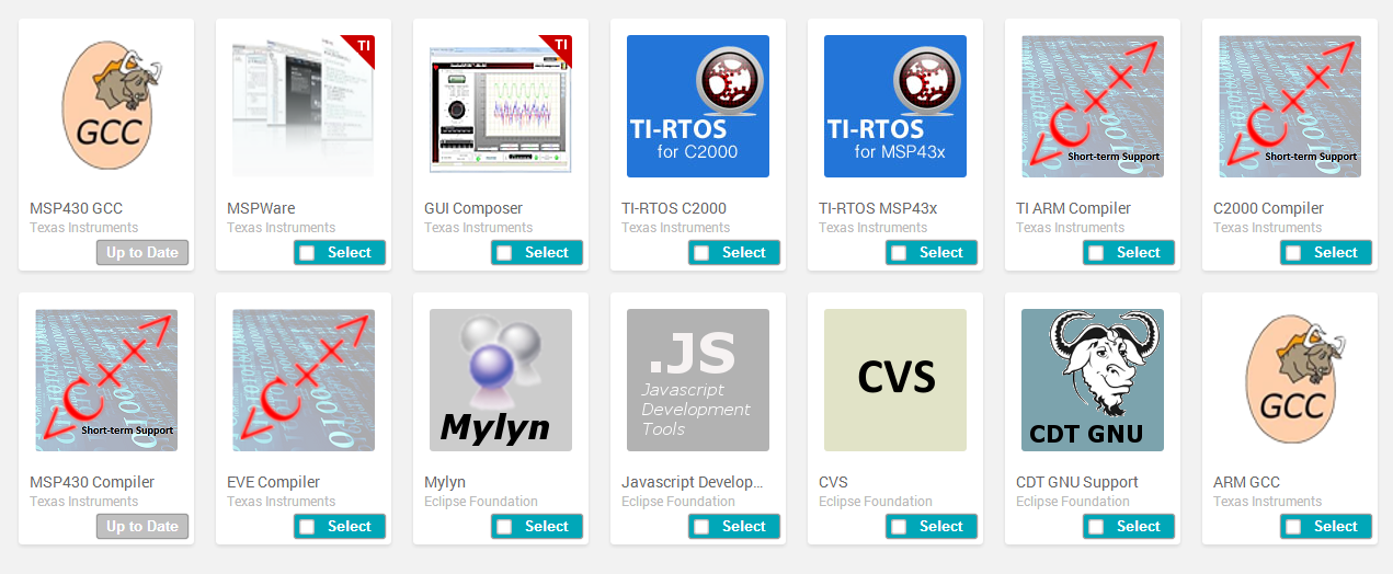

is there any one who knows how to solve it ?or where can i download grace ,please help me
Other Parts Discussed in Thread: MSP430G2210
In CCS 6.1.3 we identified some bugs with installing Grace from App Center (related to missing dependencies) so we have temporarily removed it from the App Center until we resolve those issues.
In the meantime, you can download and use the standalone version of Grace from the tool page http://www.ti.com/tool/grace
