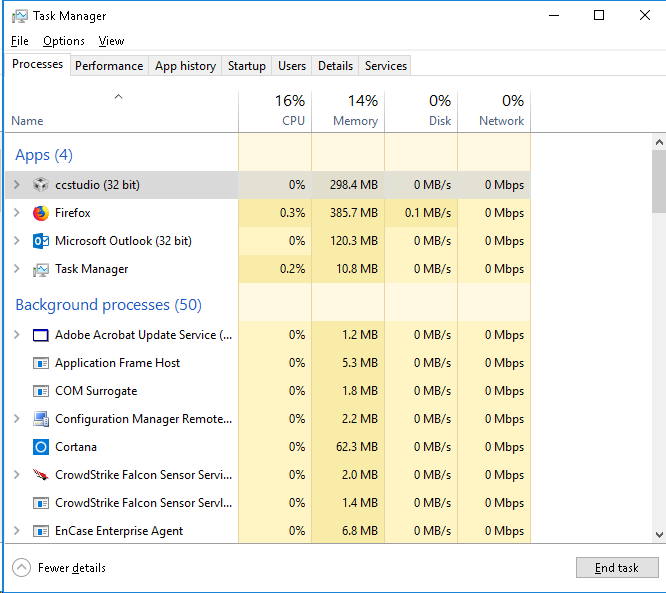

In CCS7.4 the C/C++ indexer progresses very slowly and freezes the GUI at times. I have to force terminate CCS to have it respond.
I have tried all the suggestions online (new workspace, clean workspace by deleting metadata folder, CCS with --clean option) but it still occurs. This has been happening to me for a while, so I upgraded to a new computer with windows 10 and the problem still occurs, even with a fresh install of everything.
It will sit like the following image for a while, and then may index another file, on the time scale of minutes.
I cannot even disable the indexer because as soon as I start up CCS, it tries to run the C/C++ indexer and freezes everything.
I see almost no CPU/Disk usage for CCS, even though the GUI is unresponsive.

  • Hi Derek,
    We have had issues with the Eclipse indexer recently and as of yet, we have not been able to determine the root cause (we are unable to reprodice the issue). We are still investigating along with waiting for updates for the Eclipse community.
    A workaround is to disable the indexer or change the default setting to be less aggressive and to not auto-refresh:

  • Derek, John - you guys have some beefy machines there. PC specs should definitely not be an issue in your cases. We are still investigating the indexer issues and this is a priority for us. They keep coming so you guys are certainly not alone. Thanks for your patience.
  • Derek, John - if you guys have some time, can you reproduce the issue and then generate a thread stack dump and provide the file to us? This will help with our investigations. For more information on how to do this, please see the thread below:
    e2e.ti.com/.../659011

  • Hi John,
    Thanks for the stack dumps.  Looking at them, it seems that the Stack Usage view is consistently busy updating itself.  Could you try closing the Stack Usage view, and see if performance improves during this same scenario?  Just to help isolate the problem.
    - Baltasar
  • Hello Baltasar,
    I turned that off (and recently had to do a re-install due to a Win10 OS issue) - and it appears things are running 'normal' again - of course with indexing and the stack usage off.
    John W.
  • Thanks, and if you do see any unexpected slowness, please do generate the thread stack dumps and we'll investigate.
